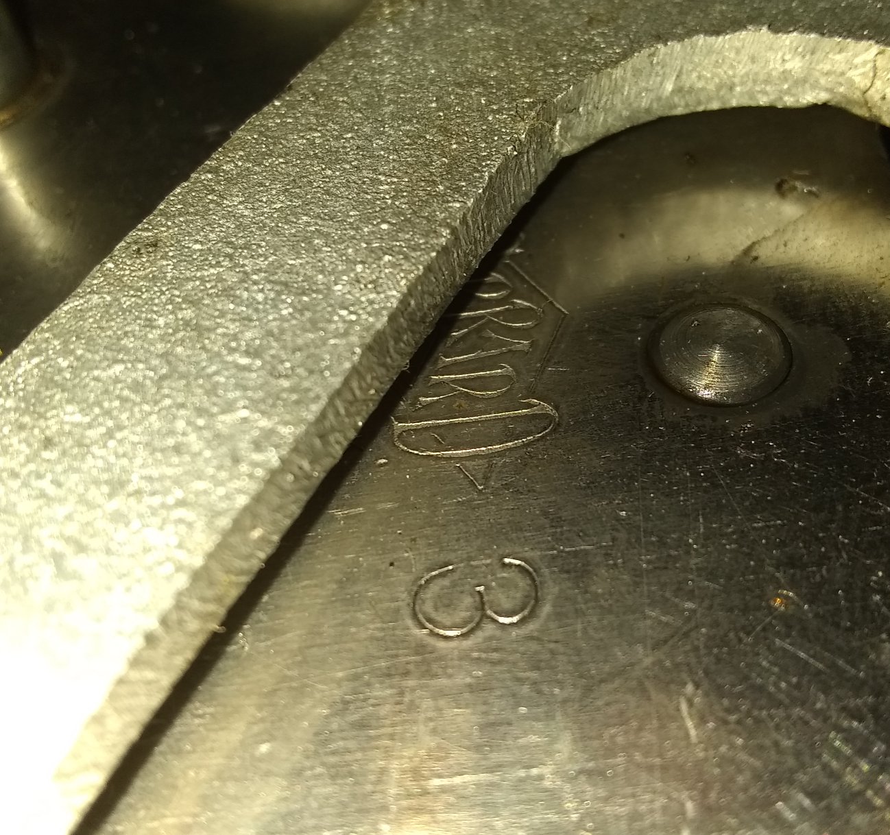

CarlosV wrote: Thu Nov 23, 2023 8:24 pm I don't think that the Bestone machine motor is a Garrard. I did not open it to check, as the motor is working and it seems quite difficult to access, but all Garrard motors I am aware of have threaded cranks.
It is a Garrad 3 motor in mine. I had a look. However, it does not seem to be entirely stock, as I have not yet found another Garrad 3 on which the spindle, together with a washer, screws on to hold the platter in place.

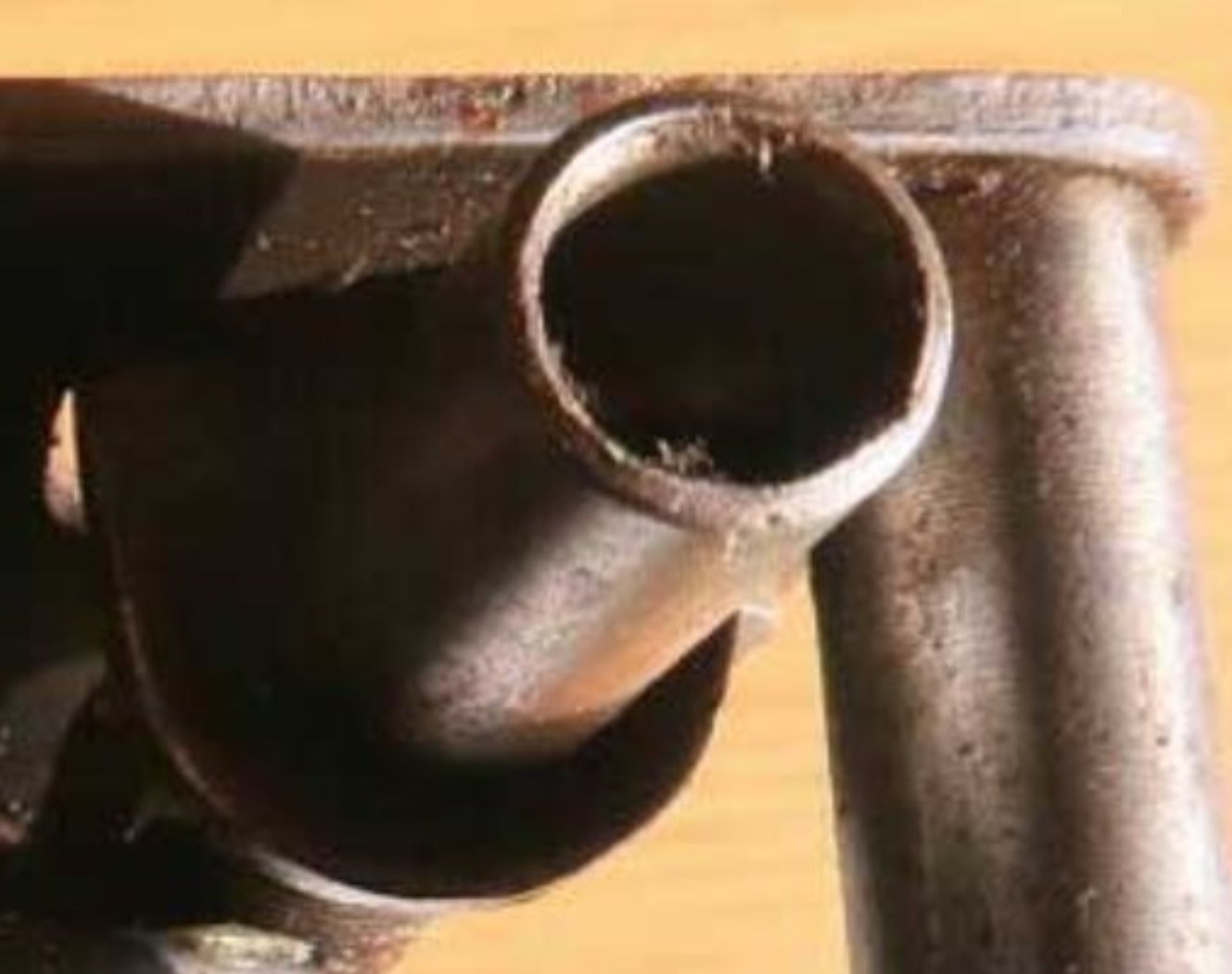

I am hoping that the crank will be something fairly generic. There were a lot of Garrad 3 motors made I would guess, a popular unit for portables. The picture of the model 3 on member Chunny's website does not appear to show a threaded socket for the crank.
https://www.gramophonemuseum.com/garrard-2-3-4-9-8.html
Enlarged Detail:
It will be a relatively simple task to transform any suitably sized bit of metal rod into a functional slotted crank and, as you say, an even easier task to adapt a suitable threaded crank.

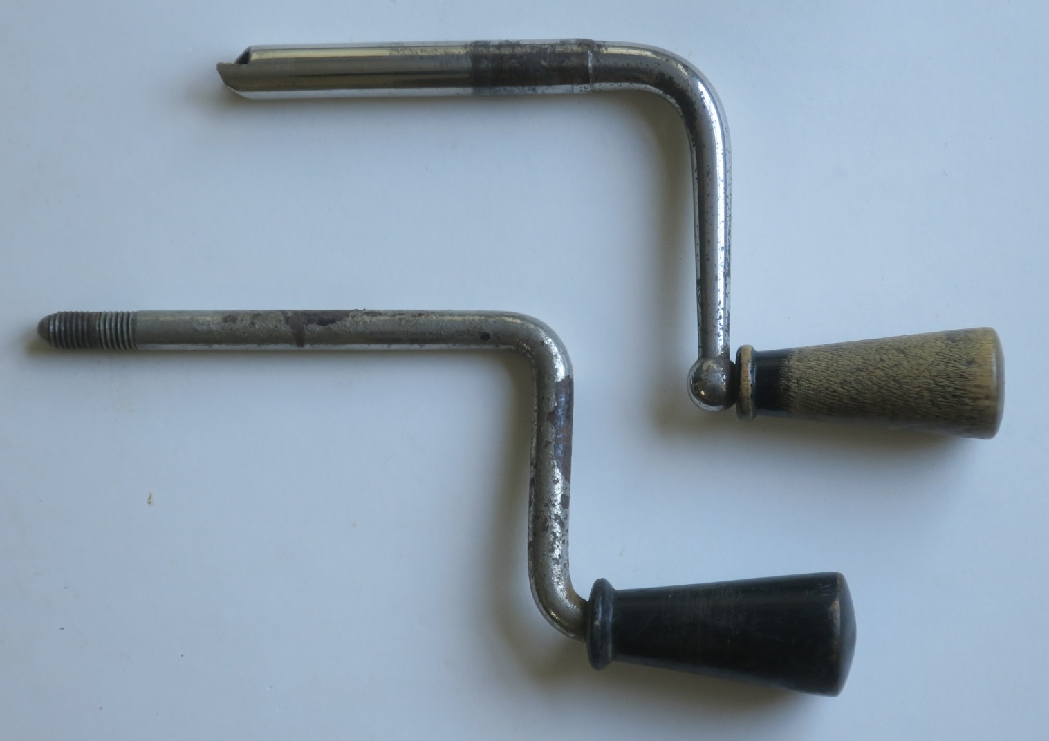

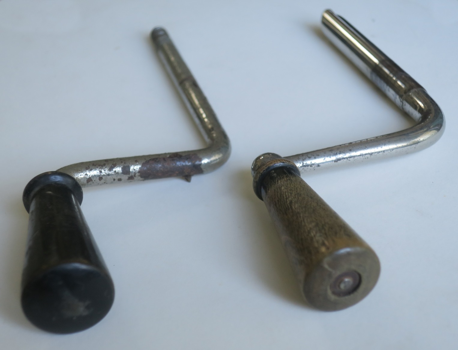

The No. 3 is one of the least common Garrard motors. Whether it always had that unusual slotted winder, or whether that was peculiar to the Roberts Bestone, I don't know, but it makes sense for a portable machine to have a winder that can be quickly inserted or removed. Roberts were ten years ahead of HMV in that respect! There were three models of the Bestone portable, A, B and C. A came in blue rexine, B in cowhide and C in crocodile-grained hide. I have never seen a C, but B also had a longer horn (the tone-arm is mounted on the right rather than the left), and a Garrard No 9 motor. The winder in this case is also non-threaded, but is female with spiral dogs on the end, a more conventional arrangement than the slotted male end of the No. 3 motor.
I will attach two photos, showing the winder from a Bestone Model B, which is earlier than most Garrard winders, with the knob held by a visible ended pin rivetted into a ball on the end of the crank. The other is a normal, later Garrard crank formed from a single rod with a hidden retainer inside the wood knob. I am sorry I cannot show the slotted winder from my Model A -- it is missing, and I am grateful for the diagram of one, though the diameter of 0.7 cm puzzles me; being English, the real dimensions of these winders were Imperial, and the standard Garrard winder shown is 5/16 inch, which equates more to 8 mm than 7. It is a perfect fit in the Mode A's escutcheon, so I assume the original, slotted winder, was also 5/16-in. The thread on the normal Garrard winders incidentally, is BSF - 22 tpi on the 5/16 size.

Winder pics now added.

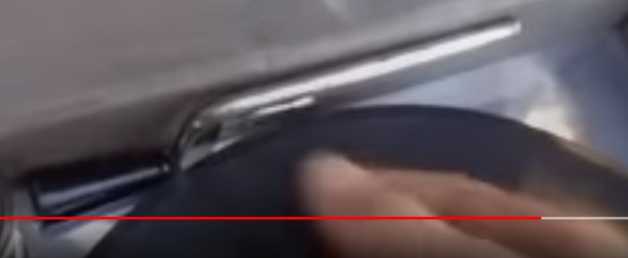

I know from seeing another video on EMGExpert's Youtube channel that on the left mount tone arm models the winder rested at the back of the motor board on the bracket for the tone arm rest and was held in place there by the clip on the tone arm. I will post a screen shot later.
2023-11-25 14.33.53 www.youtube.com c08ede7db181.jpg (13.11 KiB) Viewed 1036 times
This style of storing the winder is not possible with the right mount tone arm models.

Many thanks in turn. I did just that yesterday -- extracted the motor-- and filed a slot in the end of the threaded winder in the photo. It was barely long enough, so I made the slot quite shallow, and left the threaded section intact. It works! But when I took the motor out, I found jammed under the 'drip tray' beneath it a winder -- not original, but a home-made adaptation of a Swiss -type winder with an extension piece.
