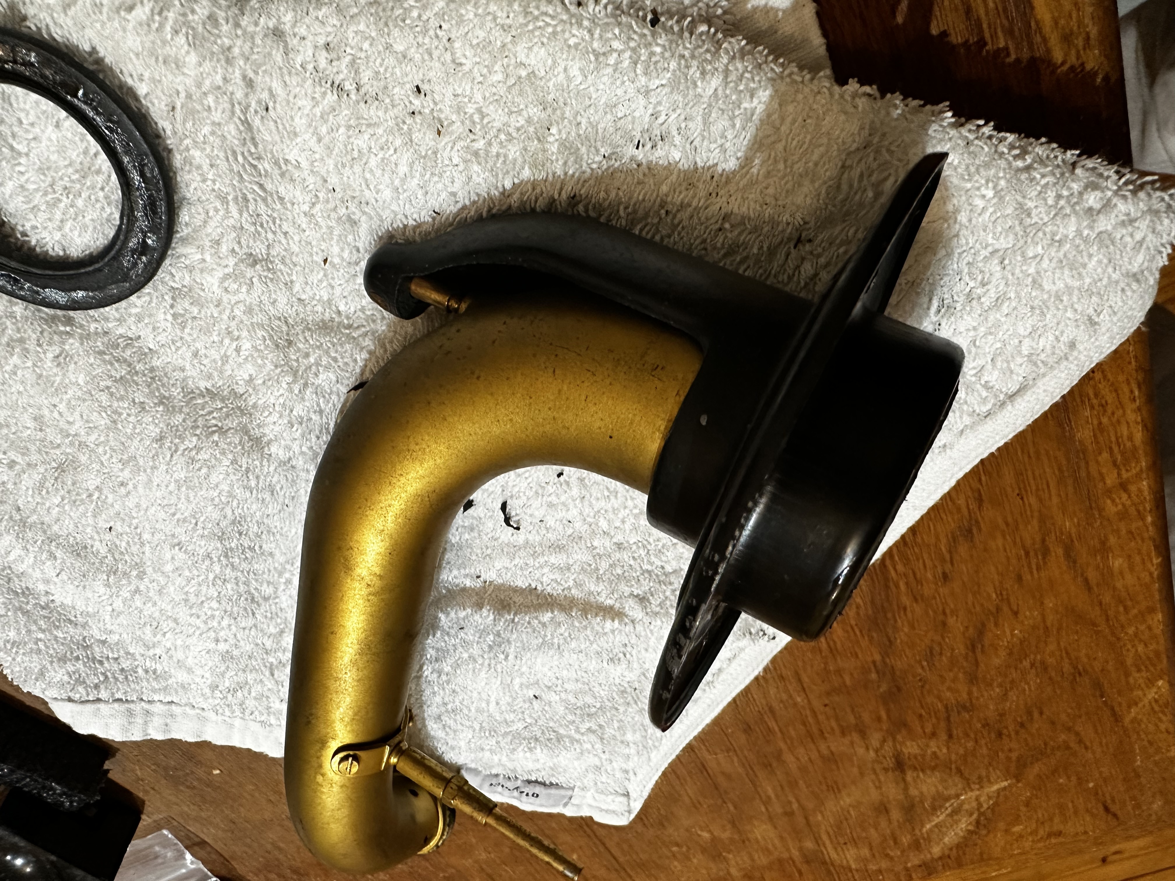

So I’ve finally been able to remove the platter and remove the motor from the board.
The tonearm I have questions on. Any tips on how to take the tonearm out of its base to clean the bearings?? Do I really have to break the pot metal bracket?? Perhaps I can soak it in kerosene to clean the bearings and then repack the bearings? Or is there another way to get the tonearm out of the bracket??

Well I’ve been able to get much of the old grease out of the tonearm bearing, a lot of work using alcohol, rags and picks to get the grease out. I’ll be getting the refurbished motor soon and I’ll be able to put it all back together at that point.
