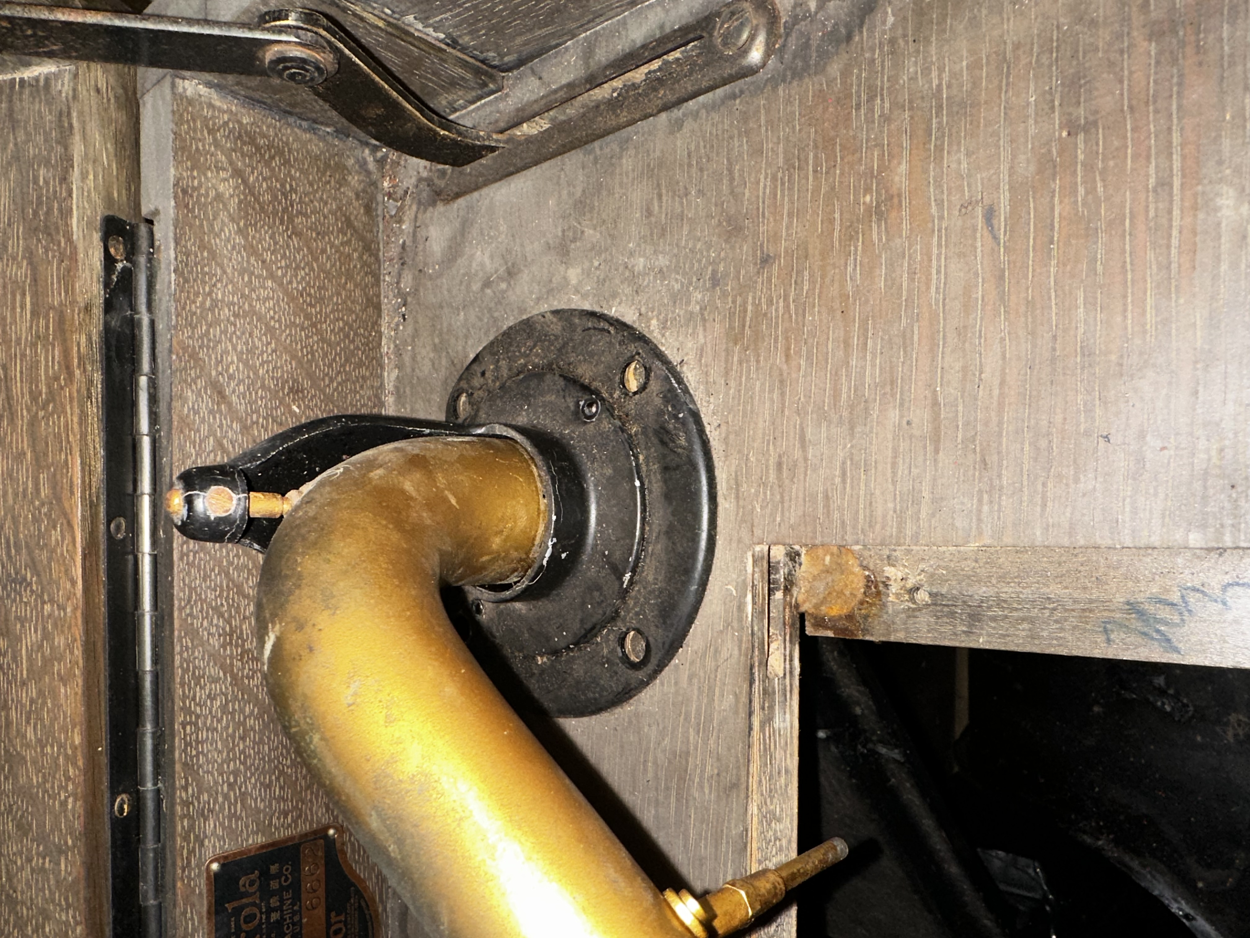

Hi, so I have a Victor VV 8-9 in fairly rough shape. Trying to do a restoration and I unable to get the tonearm off. Took off all the screws and the base of the tonearm won’t come off of the wood plinth. Anything I’m missing here? Is tried to tap it with a wooden mallet and it doesnt come loose.

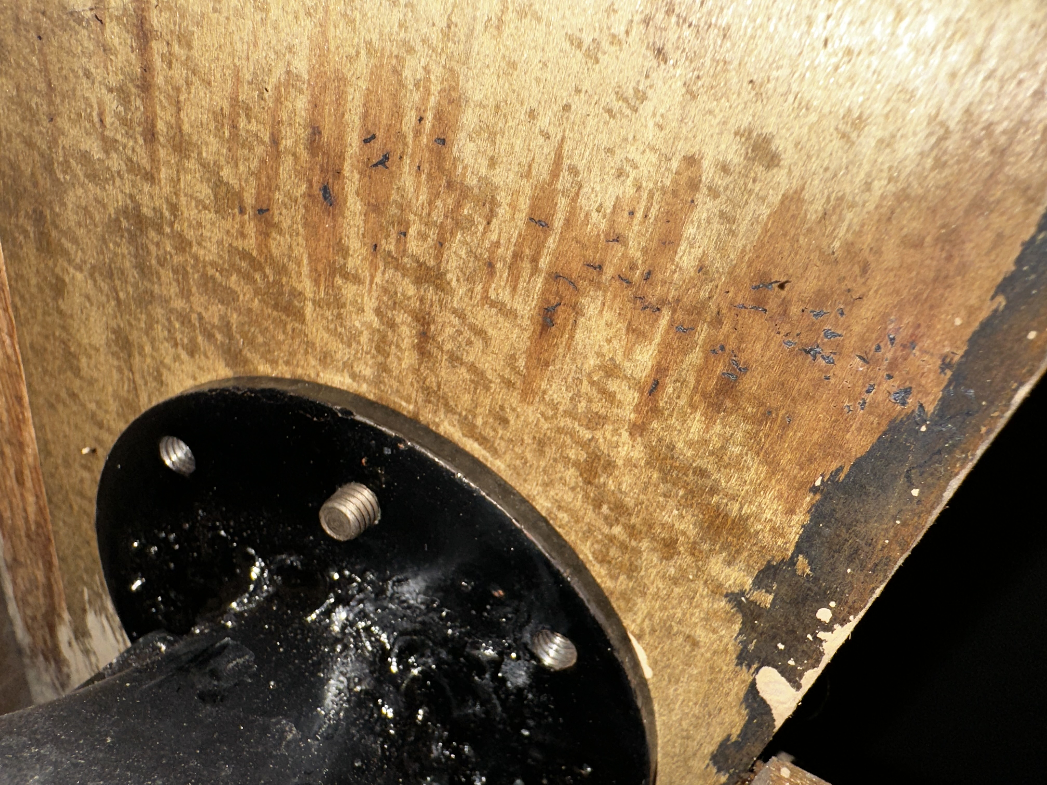

First photo shows the under side. There seems to be some sort of bolts but I assume those are to hold the horn to the wood from underneath.

It's likely just stuck in place. DO NOT hit or tap it with a mallet. The tone arm bracket is fragile and may break. Try pushing or gently tapping a thin putty knife under the edge of the base, in several places. This should pop it loose.

Sometimes the highly greased felt ring gasket between the metal horn casting and the tone arm base acts like a glue. I have even seen cases where a rubber gasket was used and it always turns to gum and sticks.

As Carlton mentions it is most likely the heavily greased felt washer which has turned to glue that is causing the difficulty.
Some gentle heat from a hair dryer applied to the horn plumbing from below may help soften the grease. You have removed the correct four screws from the top side of the flange so the sticky grease is the reason.
Once you remove the tone arm assembly you will find that the potmetal bracket with the overhead pin supporting the tonearm is stuck in the sheet metal flange. It is swollen in place and breaking it out in pieces and installing a replacement is the path forward. Replacements are readily available.

Be very careful with that tone arm and bracket assembly as it looks like there is already a crack at the set screw. If It was mine I wouldn't touch it at all until I had a replacement in hand.

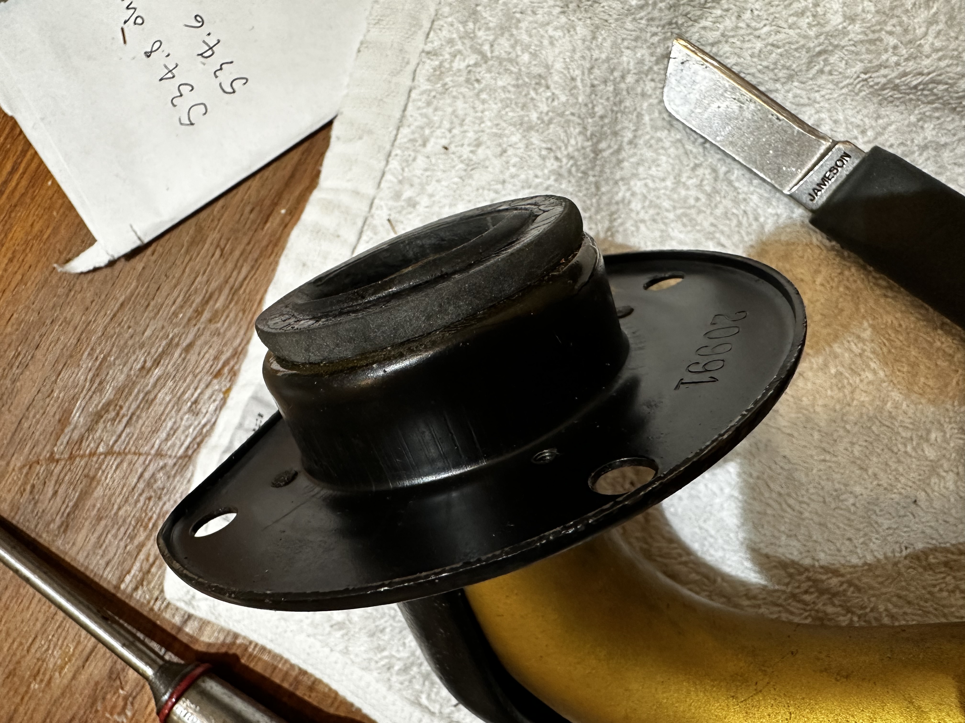

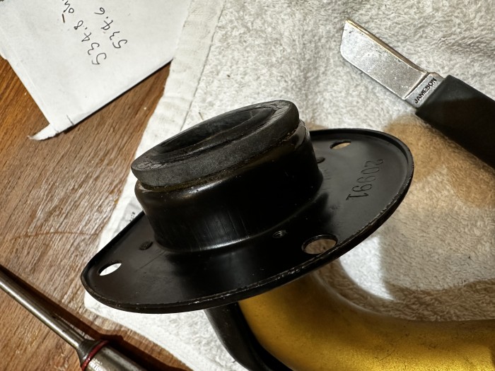

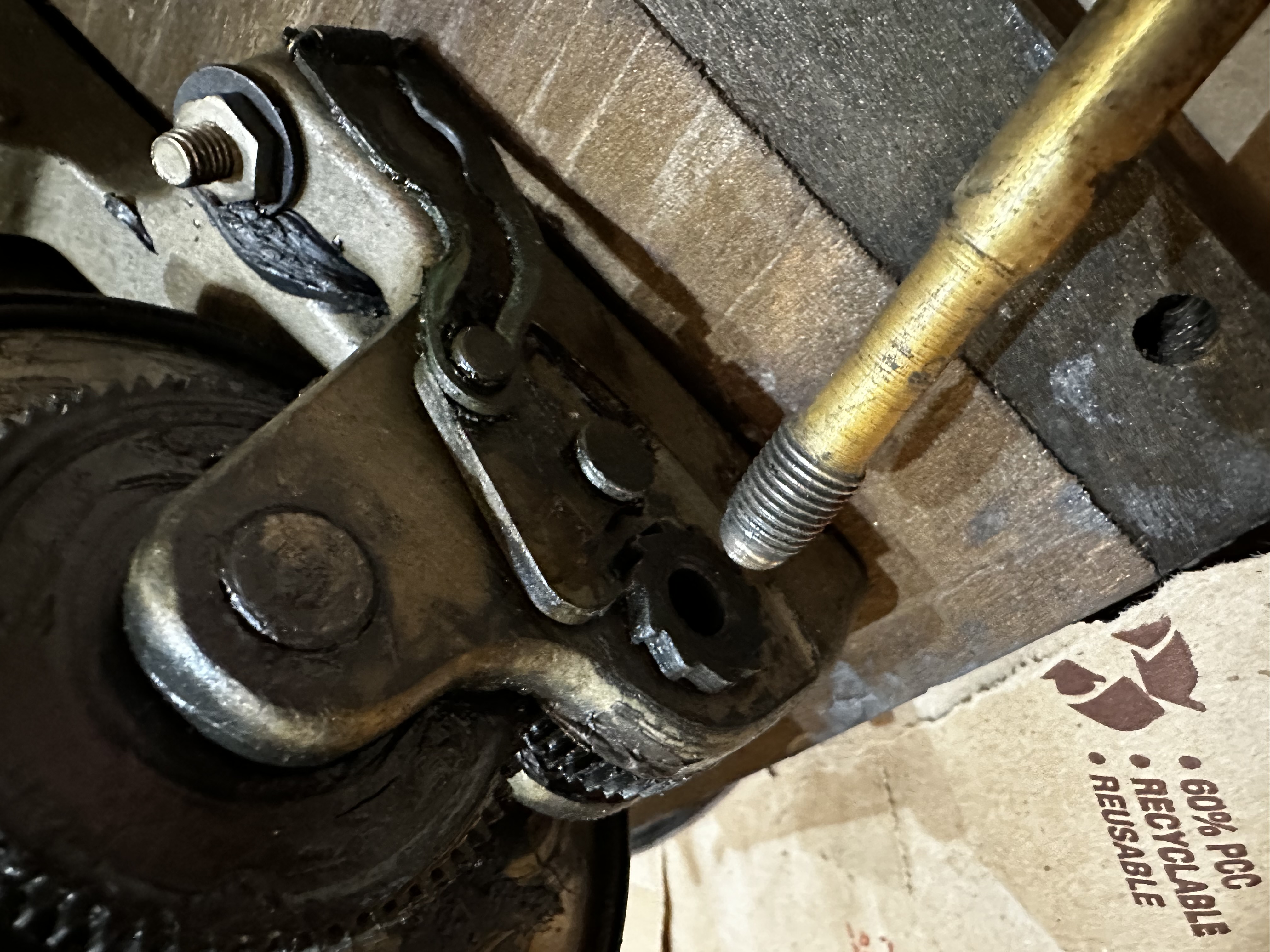

I got the tonearm off. The rubber gasket was stuck. And is still stuck to the bottom of the tonearm. It’s actually still somewhat supple. I’d like to take the tonearm completely apart to remove the old grease and lube it back up, but I’m not sure how the tonearm comes out of the base bracket. Do I need to remove that rubber gasket first?

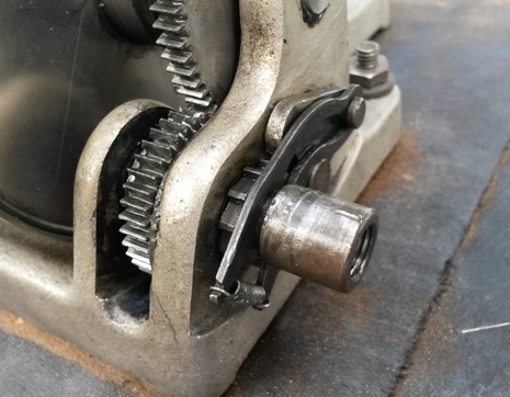

Next, the crank won’t fit in the motor. The crank is threaded but the hole where I assume the crank should go is not theaded. Is this just the wrong type of crank for this motor, or is there a piece missing? I may just buy a restored motor on eBay anyway, but it would be nice to be able to crank this motor to test it at least.

I think you may be missing the part shown in this picture. A few years back, I was able to buy one from George Vollema.Jeb98 wrote: Sat Mar 02, 2024 7:56 pm Also, can’t figure out how to get the latter off. I took the governor spring out, and loosened the set screw on the small gear that’s attached to the spindle. And it won’t come out. Any tips?
