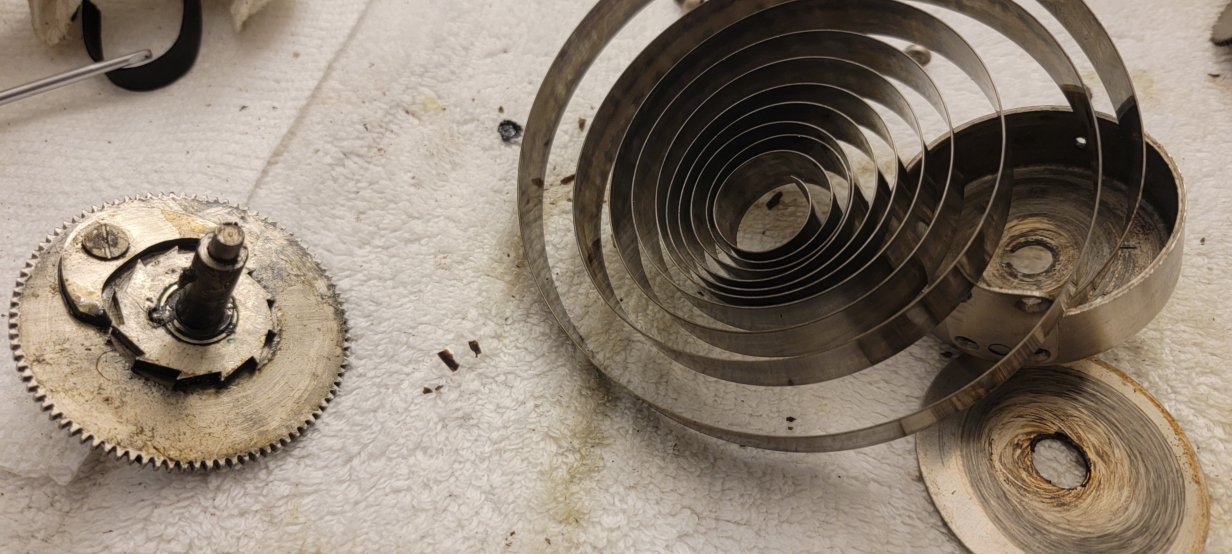

Duh the little notch lines up with the slot in the cover and then it just slides out. So I got the broken spring out. What's strange is looking at it, it seems like the way the springs are installed when you turn the knob clockwise one spring would wind up while the other would unwind. Maybe one of the springs is backwards?
- Posts: 4570
Re: Columbia Eagle Type B repair
Usually the winding gear winds the first spring by the centre, then this same one winds the other by the barrel, and the centre of this last one goes to the motor in the same direction you're rotating the winding gear, just examine it, it's all logical and easy.

I've been sitting here trying to figure out how the heck the barrel could wind the other spring. And then I realized, I think, that once the first spring is wound, then it turns the barrel which winds the other spring. Is that right?
Although I suppose it's more of a gradual thing where they both wind at the same time as the forces balance.
Inigo wrote: Sat Jul 06, 2024 5:11 am Usually the winding gear winds the first spring by the centre, then this same one winds the other by the barrel, and the centre of this last one goes to the motor in the same direction you're rotating the winding gear, just examine it, it's all logical and easy.
- Posts: 4570
That's it!
It SHOULD be gradual... If not, there is something molesting... dry grease, etc, and it thumps...
