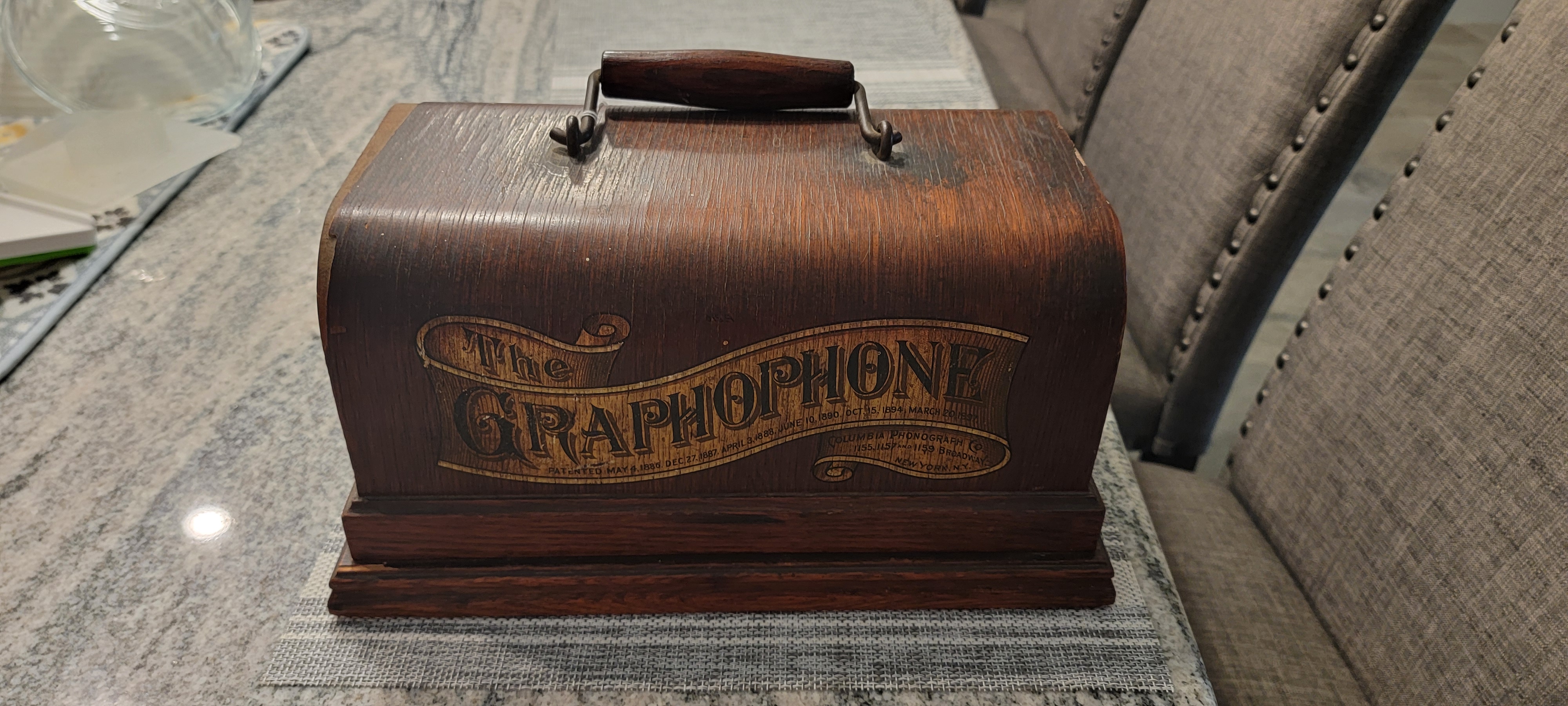

I bought this beaut at a thrift store for $65.

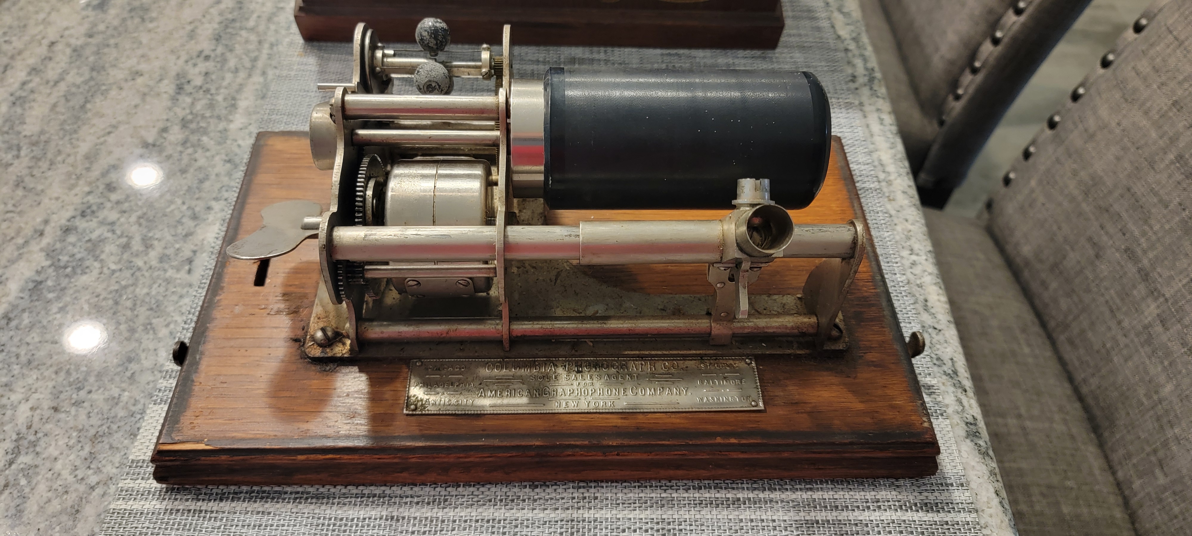

Pretty sure it's a Columbia Eagle Type B. When I turn the winding knob, there is no resistance. So I assume it needs new spring(s). Where can I get some replacement springs?
Also it's obviously missing the reproducer. I only see a listing on eBay for like $200. Any better source of parts? Any other model reproducers that would work on this machine?
I don't care about it being perfect, or even original. It would just be nice to make it play however I can.

Yours is a early one from 1897 or 1898. What's the serial number on it?

Looks like 80809

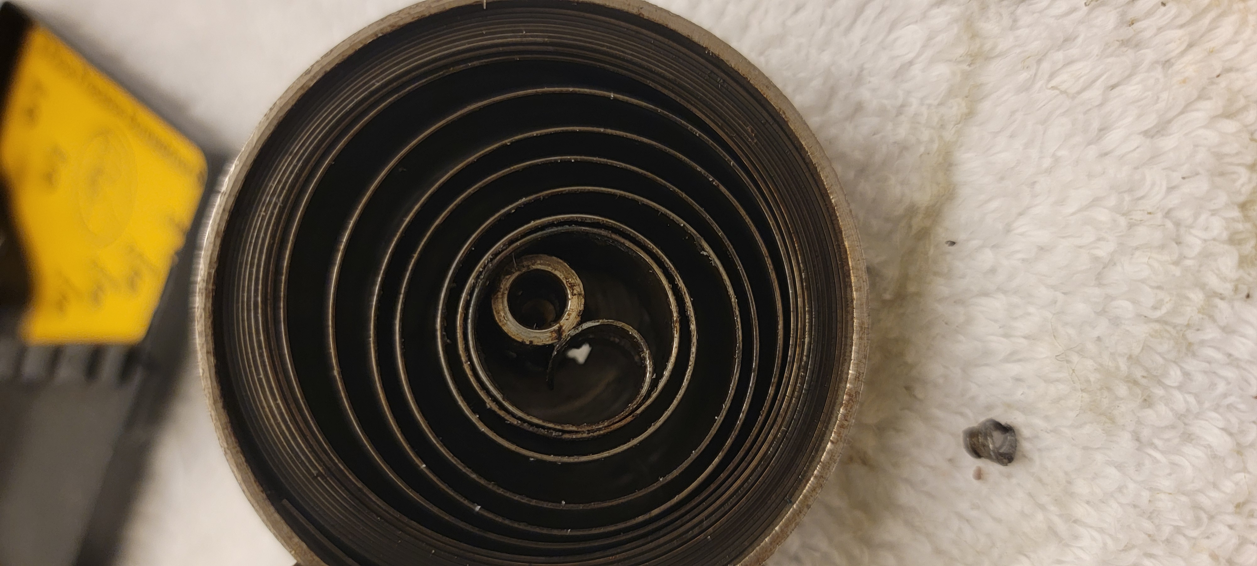

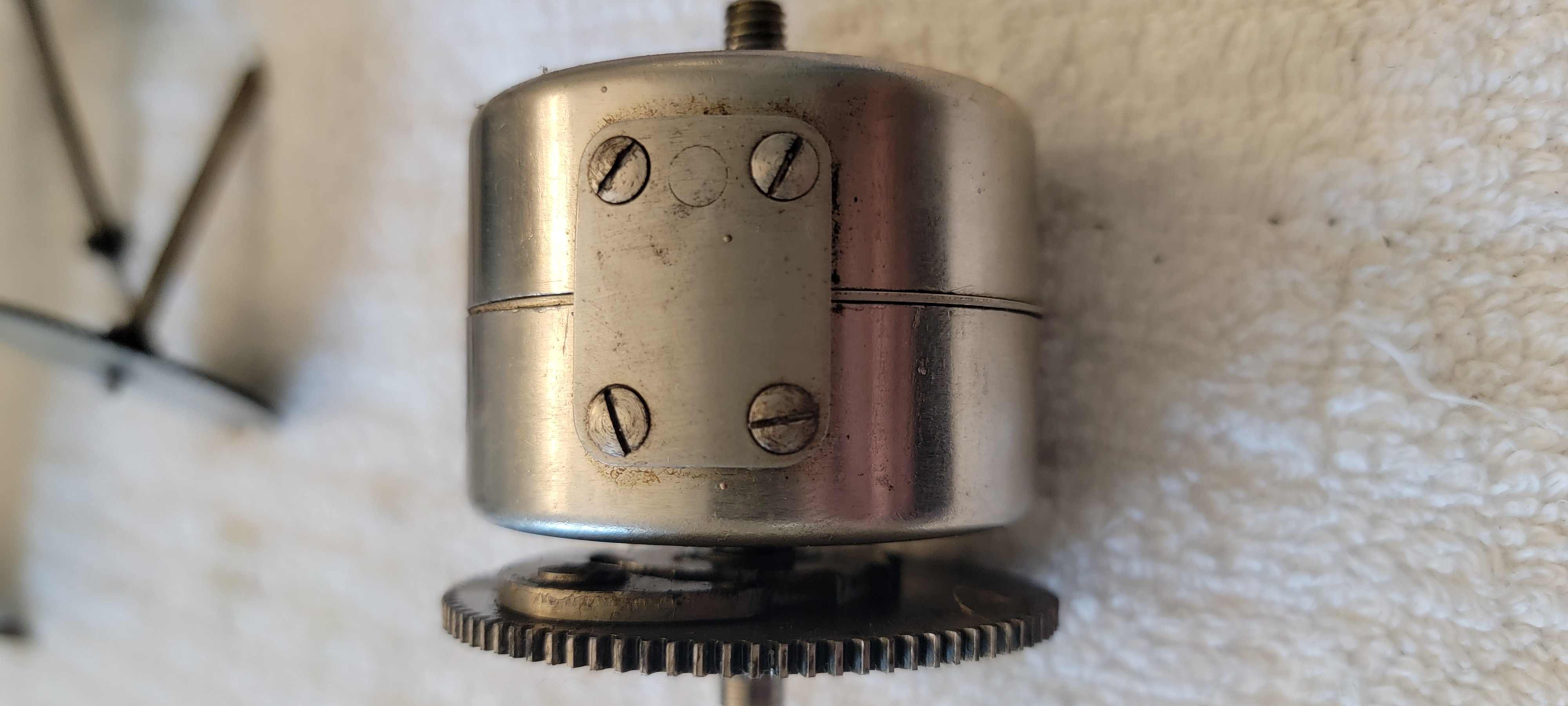

So I've gotten this far and the spring is definitely broken on the gear side of the motor. How the heck do I get the shaft out?!
The spring on the other side looks like it's not broken, but it also doesn't look installed correctly. Shouldn't the bent end go around the shaft and hook on the little nub?

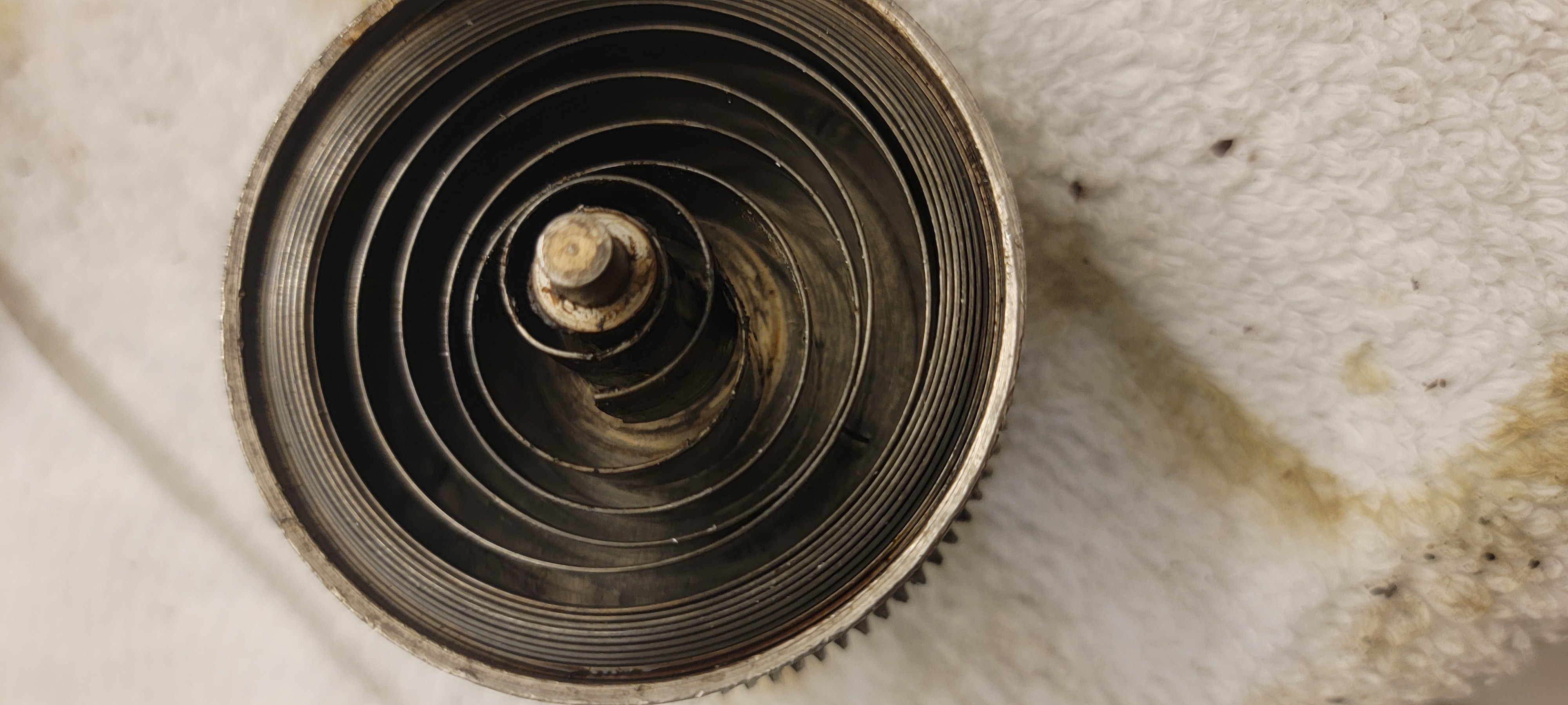

Ok so I got the shaft out of the end that's not broken and put it in what looks like correctly now. This is the same piece as the third pic in my last reply.
