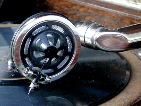

Many thanks. Yes, I knew about the differences between the reproducers, and should have mentioned it before since the Orthophonic sound box was the heart of the Western Electric design concept, and was exclusively licensed to Victor/The Gramophone Co. along with all of the other components--which, as you probably know, were designed to work together as a complete system.
I remember reading, years ago, that center cone of the diaphragms installed in the early Viva-Tonal sound boxes were "stiffened," or that a double layer of aluminum was applied, in order to make a greater area of the diaphragm plunge with the movement of the needle-bar. Of course, I can't find anything about that now. :cry:
Along this line, one sound box restorer I used to correspond with told me that in order for a Viva-Tonal sound box to function properly, the material used for the diaphragm gaskets had to be "super soft" so that the diaphragm more or less floated in its movement.

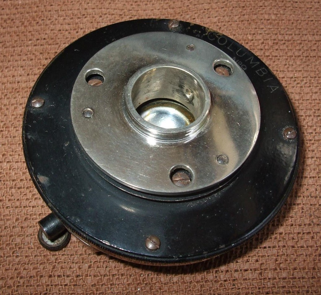

In the UK some collectors prefer the Columbia No.15's immediate predecessor the No.9.
Was the No.9 ever fitted to American Columbia machines? I have seen no mention of it.

epigramophone wrote: Wed Jan 29, 2025 10:44 am In the UK some collectors prefer the Columbia No.15's immediate predecessor the No.9.
I never saw a nr 9 in US machines, only the nr 15 counterpart, that looks similar to the UK design but has some differences. Both are good soundboxes, but to my taste I prefer the 15, its well-designed rubber back attachment is more flexible than the metal sheets of the nr 9.
