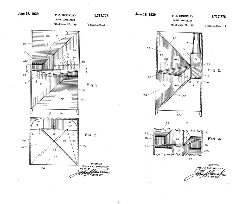

There's a photo of the back of the horn used on the 800-series (American) Viva Tonal on this site -- https://www.intertique.com/VivaTonal810IDDemo.html Not really re-entrant; more like a double horn as you can see from the patent illustration -- https://patents.google.com/patent/US171 ... graph+Horn

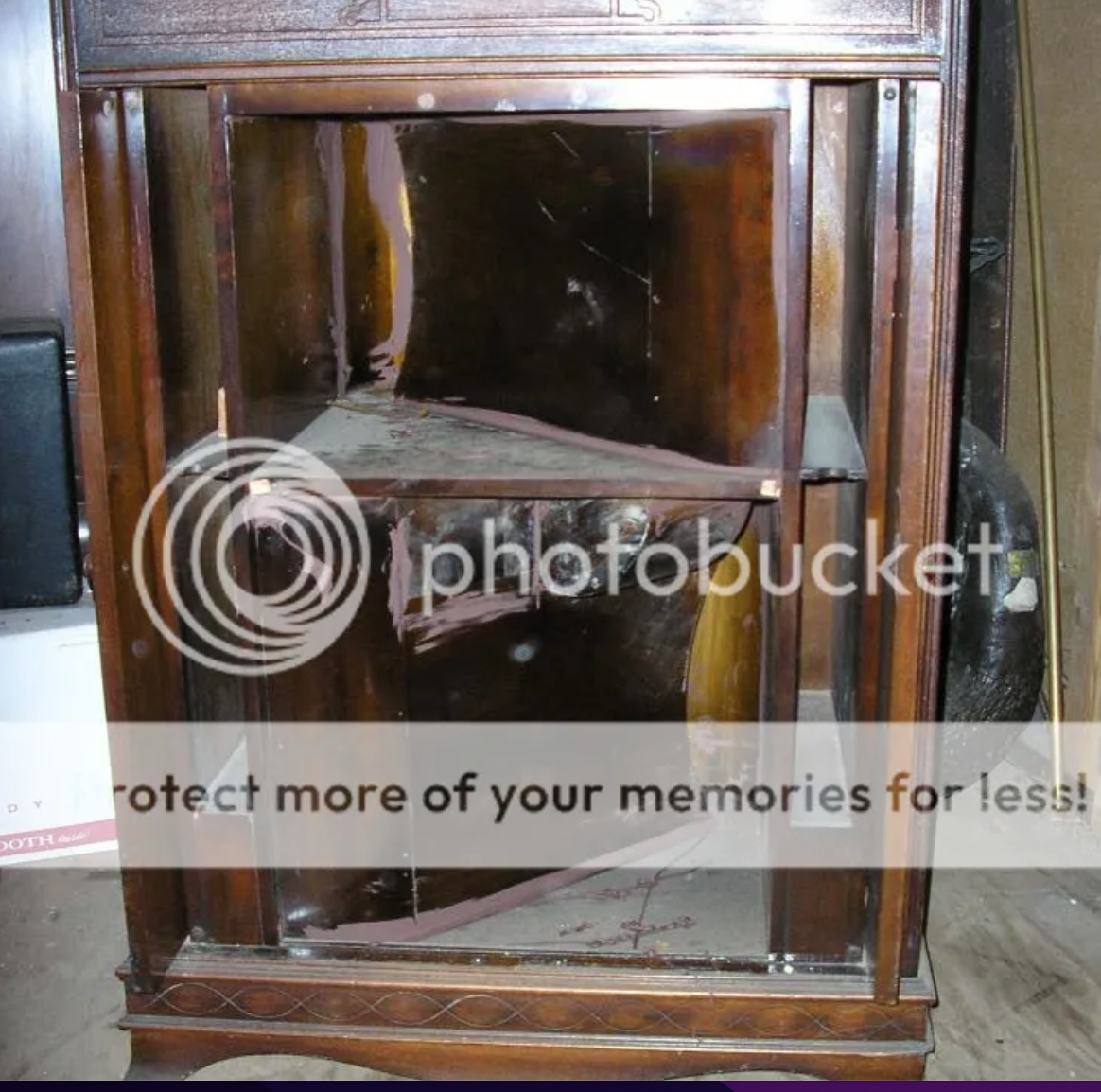

The smaller horn used on the mid-sized (American) 700-series models had a horn with a divider positioned horizontally in the center, as shown here: https://www.ebay.com/itm/196581996058
FROM -- https://patents.google.com/patent/US175 ... graph+horn

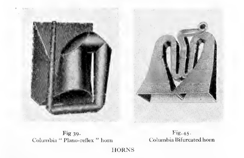

The UK manufactured Viva Tonal models were fitted with bifurcated metal horns, but they weren't re-entrant. They were dived into two sections which joined at the mouth. I've posted several photos of these on this forum, but they're all lost.

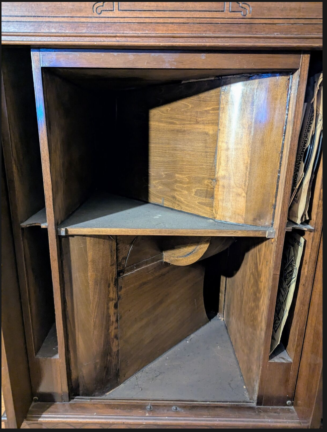

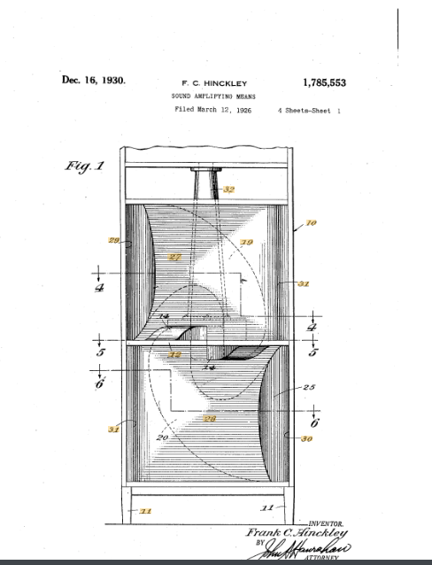

The horn structure of the 800 horn seems quite different from the blue print you sent me. I wonder somebody has the blue print of the 800 and 810 horn. I attached the front horn photo.

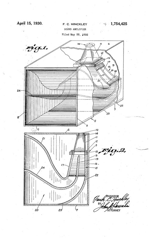

Here's two more patents for other large Viva-Tonal horns.
https://patents.google.com/patent/US178 ... graph+horn
There may be more.

Those blue prints are amazing. Thank you so much.

I sort of calculated the length of the 810 horn and it seems to be about 10 feet. Can anybody do that in a more precise way based on the blue print? Thanks.

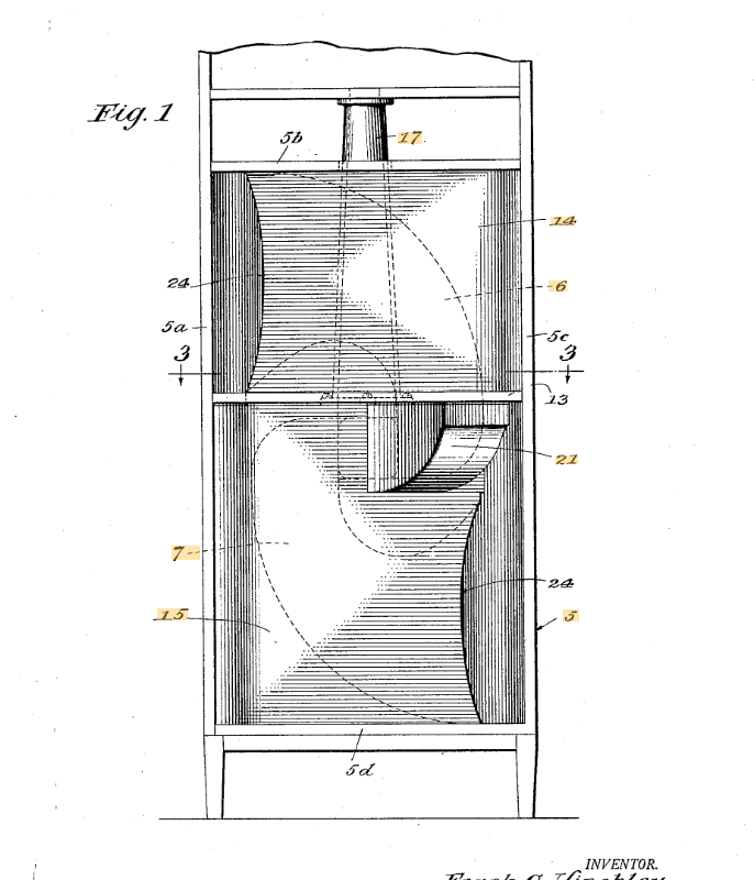

This could be for 820 .
820 horn.png (112.02 KiB) Viewed 1090 times
This could be for 810.

An Balores wrote: Mon Jan 27, 2025 8:39 am 'Orthofan' says "The UK manufactured Viva Tonal models were fitted with bifurcated metal horns, but they weren't re-entrant. They were dived into two sections which joined at the mouth."
So is there any benefit to this arrangement? I can't see it myself.....
From the videos on Youtube, there does seem to be an enhancement in sound quality, compared to earlier designs. The UK based collectors would have far more knowledge about this than I do, but essentially, the bifurcated design allowed a much longer--more gradually tapered--horn, with a larger mouth, to be fitted into conventional size cabinets. The horn, which had an exponential style taper, was coupled to a gradually tapered tonearm fitted with a new style sound box equipped with an aluminum diaphragm, as was the case with most other sound boxes produced at that time.
Another design--unique to Viva-Tonal models produced in the UK--employed the "Plano-Reflex" style horn and tonearm. You can find quite a lot about this online by doing a search for Columbia Plano-Reflex.
Here's an illustration showing both the bifurcated and Plano-Reflex style horns --
FROM --
percy-wilson-modern-gramophones-1929.pdf
(7.95 MiB) Downloaded 23 times
