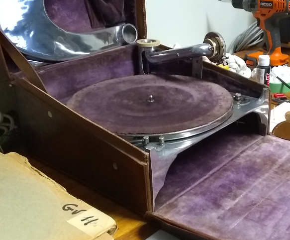

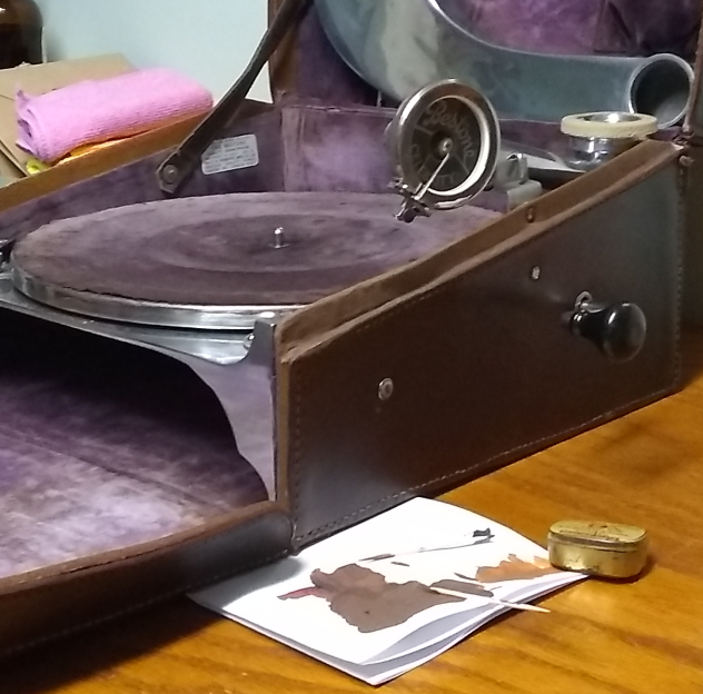

Today I went out and bought some paint to deal with the cardboard and rexine repair job.
I looked at the colour of the rexine and thought that raw sienna would be the closest standard stock colour. I bought a small bottle along with some black and white for adjustments.
Here is a first coat, dried.
I mixed in a little too much black. I didn't need the white. But I should have bought some red, too. The rexine has bit more red in its raw-sienna-ish brown than what I have ended up with. The finish is also a bit too matte. I will need to look for a bit of clear coat to apply extremely sparingly.
For comparison:

I got a much more exact colour match by mixing in a bit of red with the raw sienna and the black. I also improved upon the appearance by making the colour non-uniform, taking different mixes from my little paper pallet and lightly putting extremely thin and very spotty coats over the solid base. Examined very closely, the rexine is no longer (or perhaps never was) entirely uniform in colour. I then finished by doing the same kind of coat with tiny amounts of pure raw sienna which would then mix with residual pain [Edit: ironic typo -- should read paint] the in the brush.
In some light conditions the repair is not visible now unless one knows it is there and looks very closely.
The problems now are differences in texture and light reflection.
Texture I don't think I can improve upon. The area was so badly damaged, and it strongly resisted reassembly. If I had a chance to do the repair again, I would do it slightly differently and better, but it is what is now.
Light reflection I can probably address with carefully applied thin and (micro) spotty coats of a sealer or clear coat, making the light reflection of the repaired area more similar to that of the old rexine.
