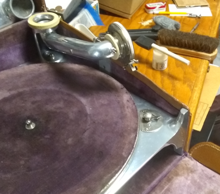

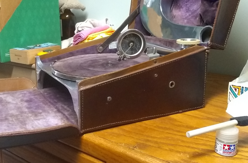

I had time to move this project forward a centimetre or two this afternoon.

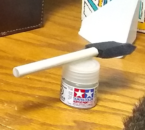

I went out into another city to run various errands and to visit a hobby shop where I could get a semi-gloss acrylic clear coat in small bottles, Tamiya brand. Spray cans are available everywhere but the small bottles are a little bit hard to find in stock. As luck would have it, the store was having a 10% off sale, so I saved about $0.40 CDN on the little bottle.
I used the corner of a foam brush. The product is harder to use than paint because it is much less viscous. I managed to get a small dribble into the velvet inside the case, but the clear coat is water soluble, so I think a manged to clean it up fairly well.
The repair now looks better from a bit of a distance and slightly worse with close inspection--the clear coat shows imperfections in the repair more readily than the mat finish paint did. But no one ever looks at it that closely so overall, I am pleased with the outcome--the sheen of the repair and the light reflection from it more closely match those of the rexine. This is all a bit nit picky since nobody that I had ever shown the machine had noticed the repair before the application of the clear coat.
Pictures don't really show a lot but here we go anyways:
