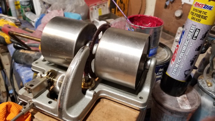

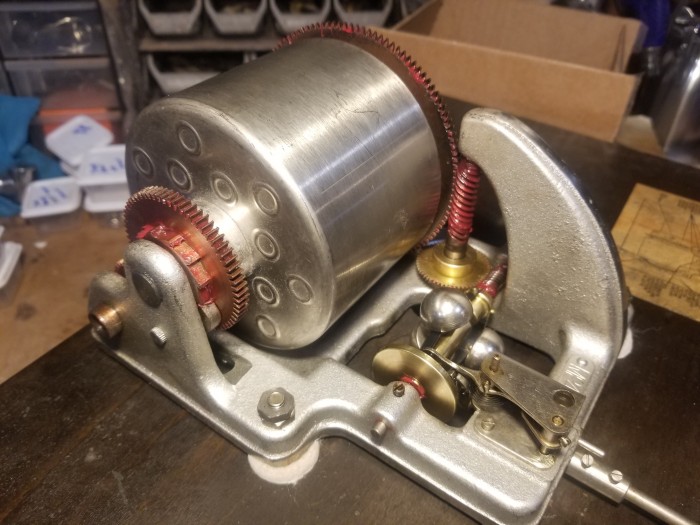

I have rebuilt lots and lots of Victrola motors and almost all of them with original grease were dried up to the point i have to use a metal putty knife to scrape it out of the barrels and off the springs.
When i disassemble motors i put the large parts, chassis, barrels and springs into a home depot 5 gallon bucket with lid, i pour in 2 gallons of home depot (forgot the brand, blue can) paint thinner. Its primary ingrediant is mineral spirits. I tried the low order mineral spirits and it doesnt work as well as regular mineral spirits. I put the top on and soak for a few days. I the remove all the parts and wash with dawn soap. Polish parts with 0000 steel wool and lightly sand blast the chassis.
For the lubrication i use Amsoil polymeric synthetic grease for the springs and mobile 1 synthetic for the gears. Polymer Grease is a multipurpose polymer lubricant that contains rust and oxidation inhibitors. It is highly adhesive, water-resistant, and has excellent stability. I have also used Valvoline synthetic grease from Autozone (black grease) with good results. I also add mobile 1 synthetic motor oil in addition to the grease on the governor and worm gear bearings.
Here is a 2 spring i did last week and a 4 spring that shows the spring grease.
