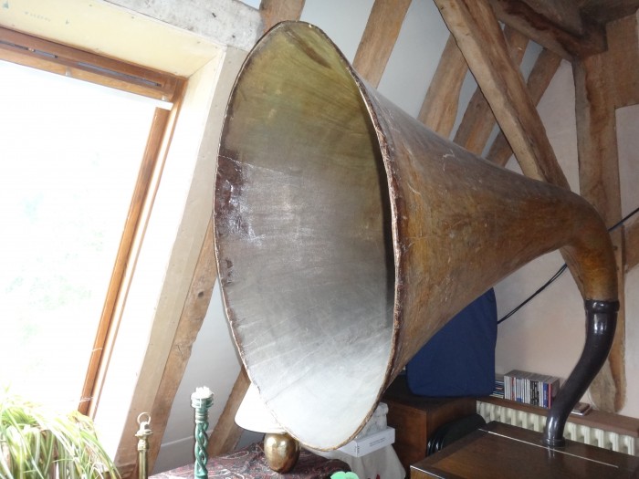

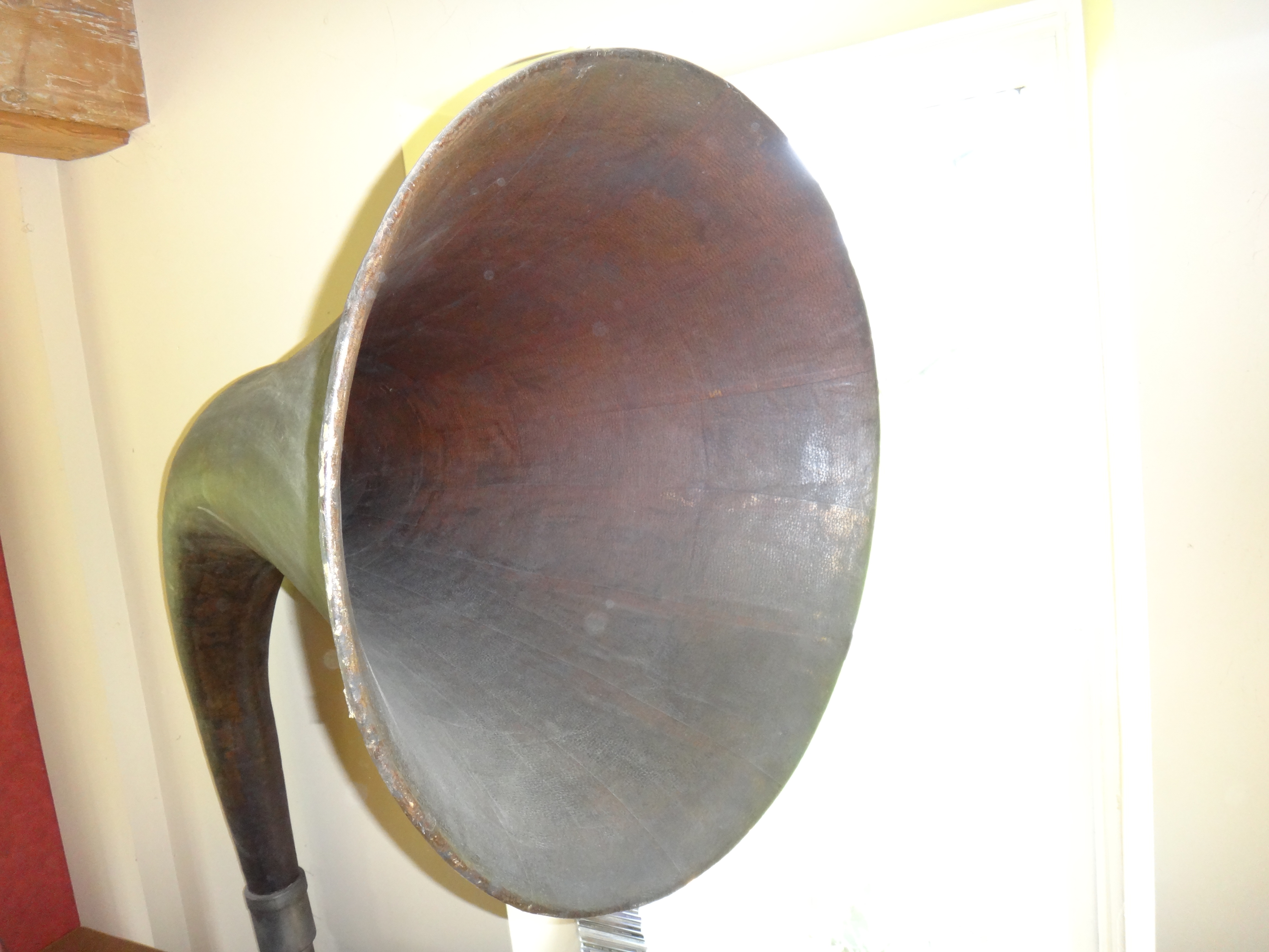

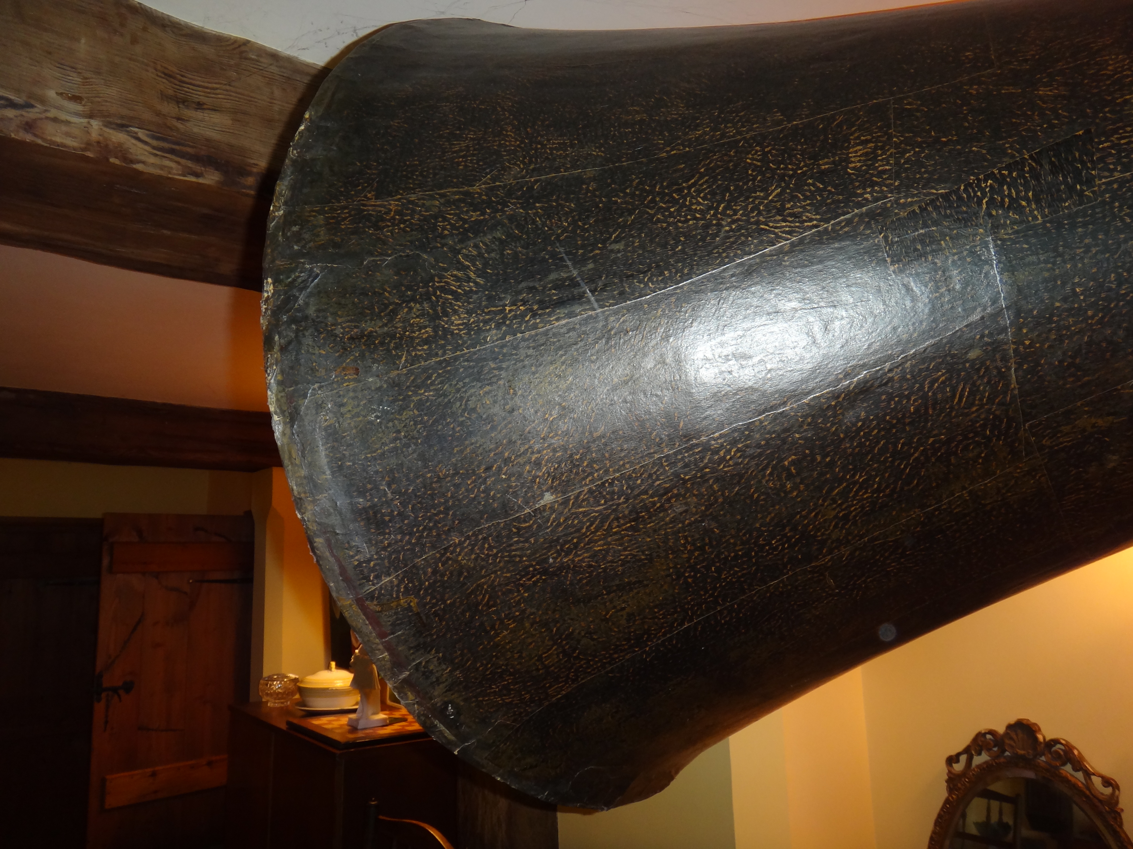

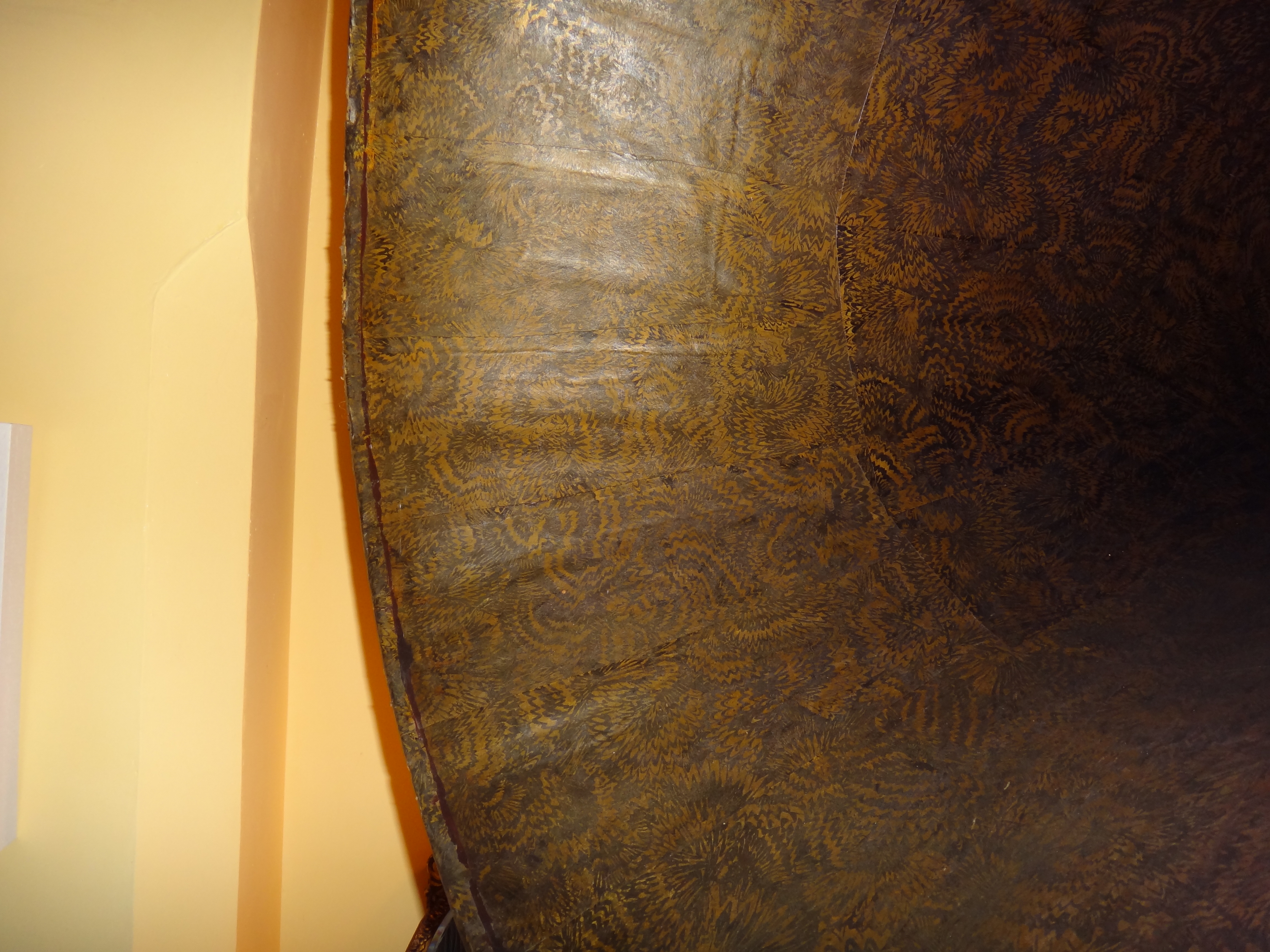

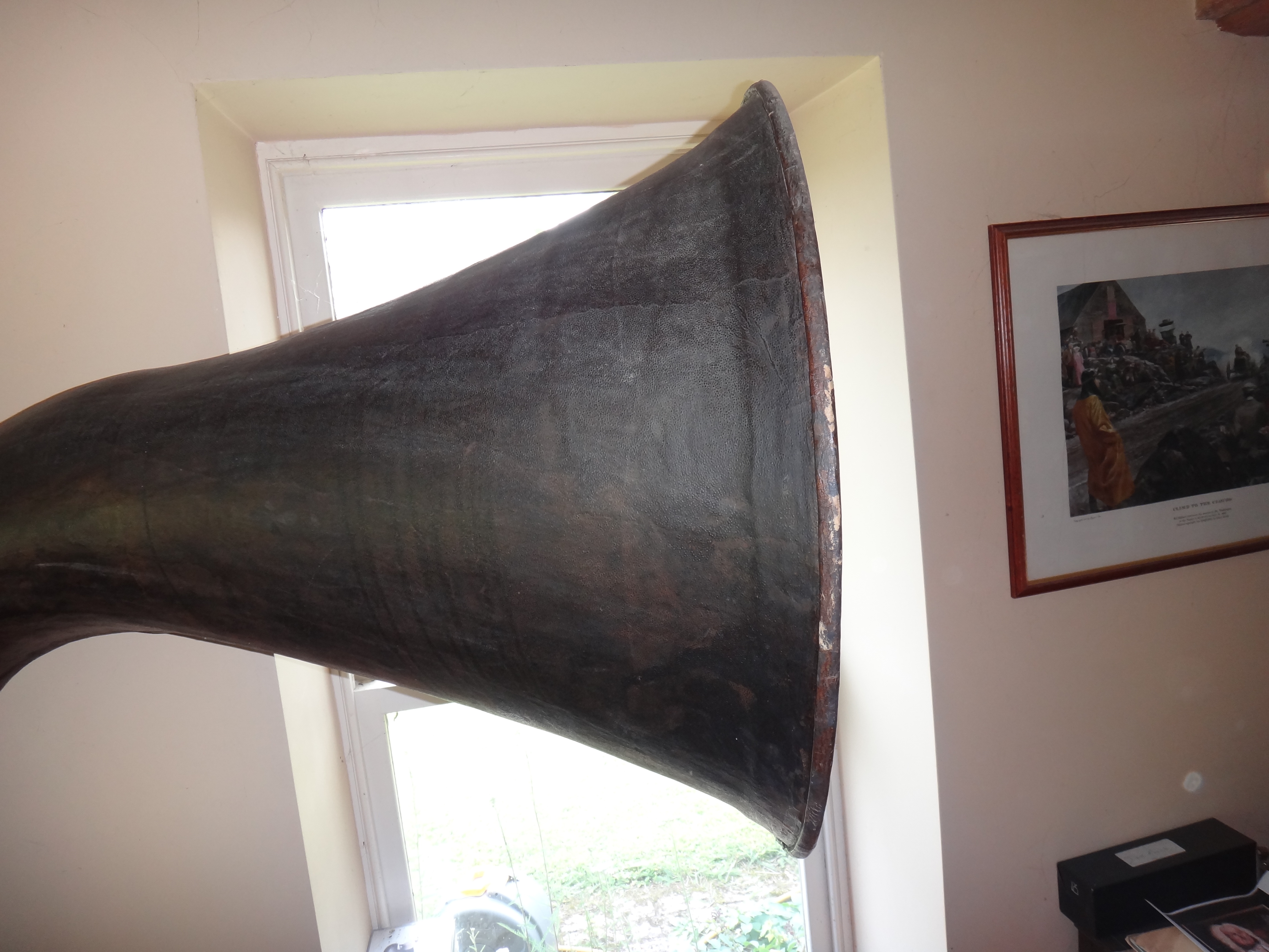

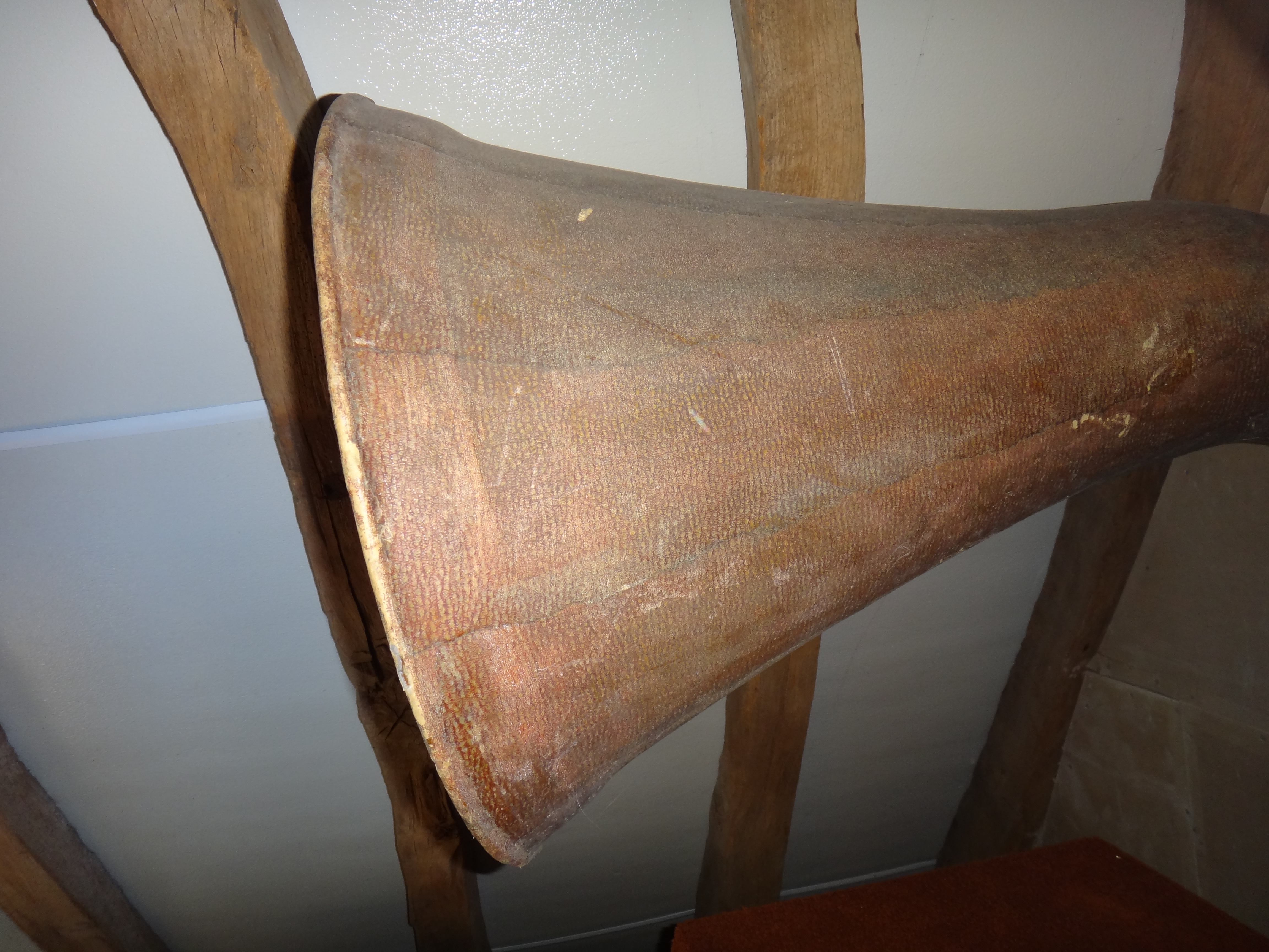

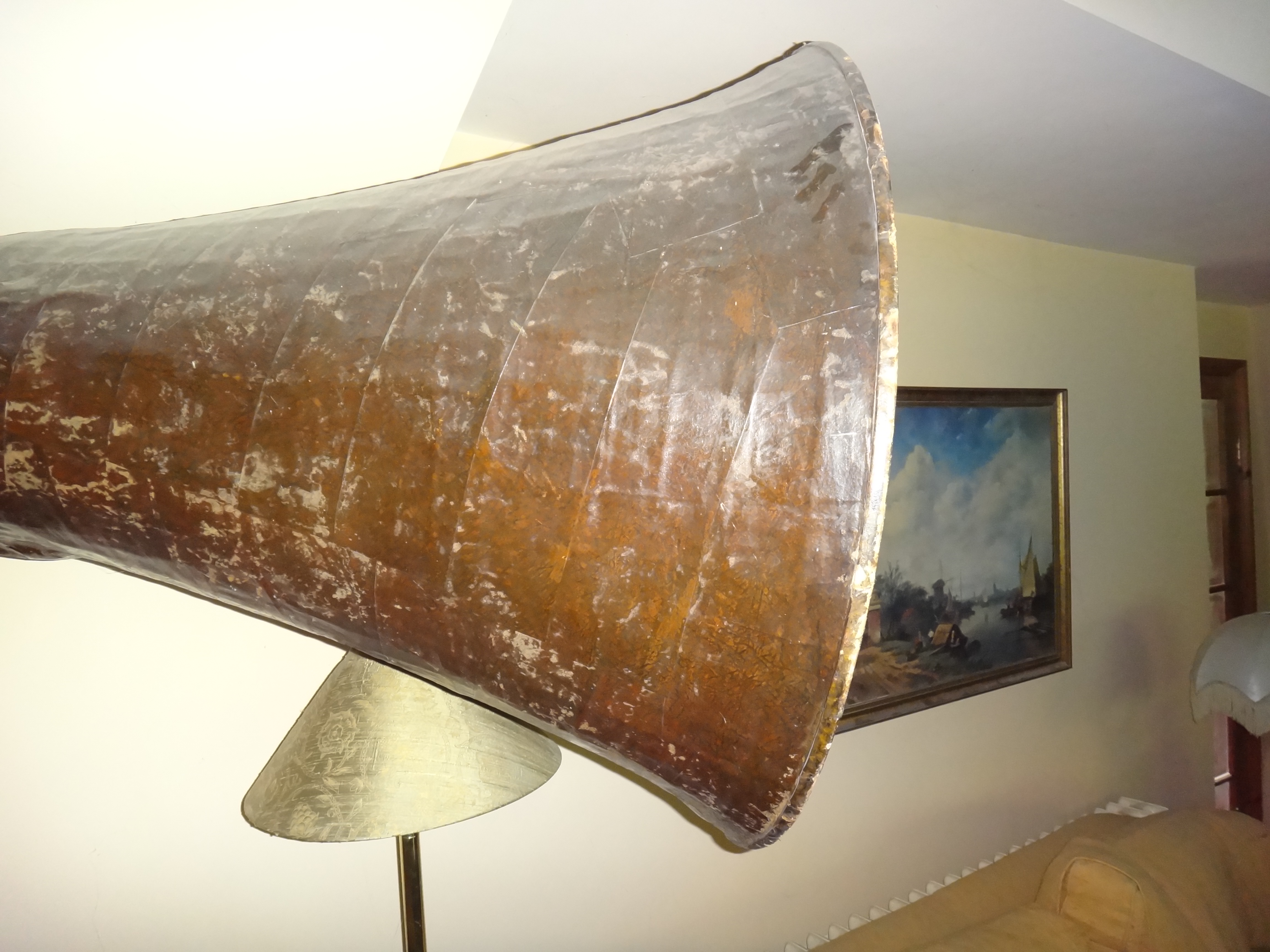

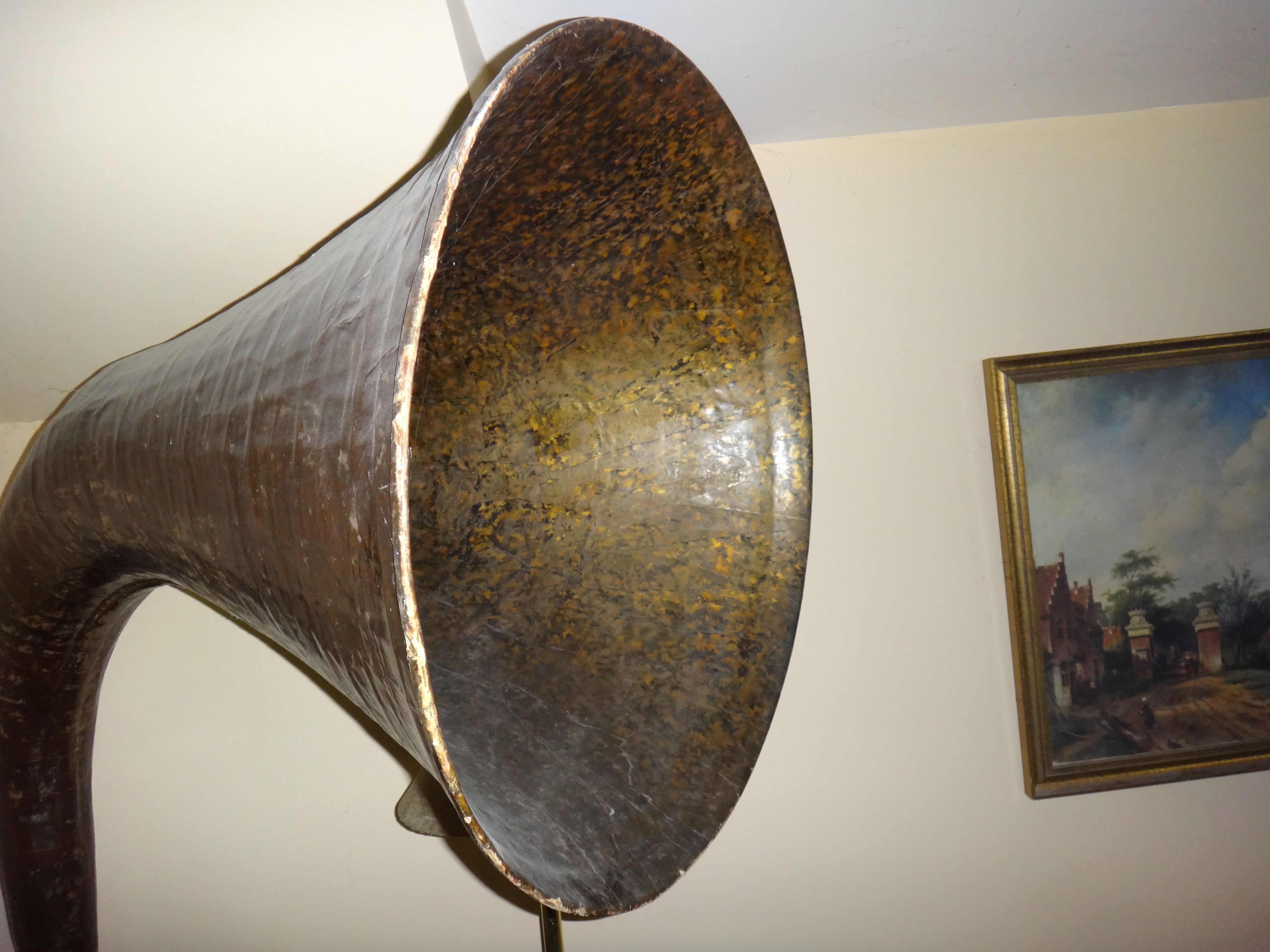

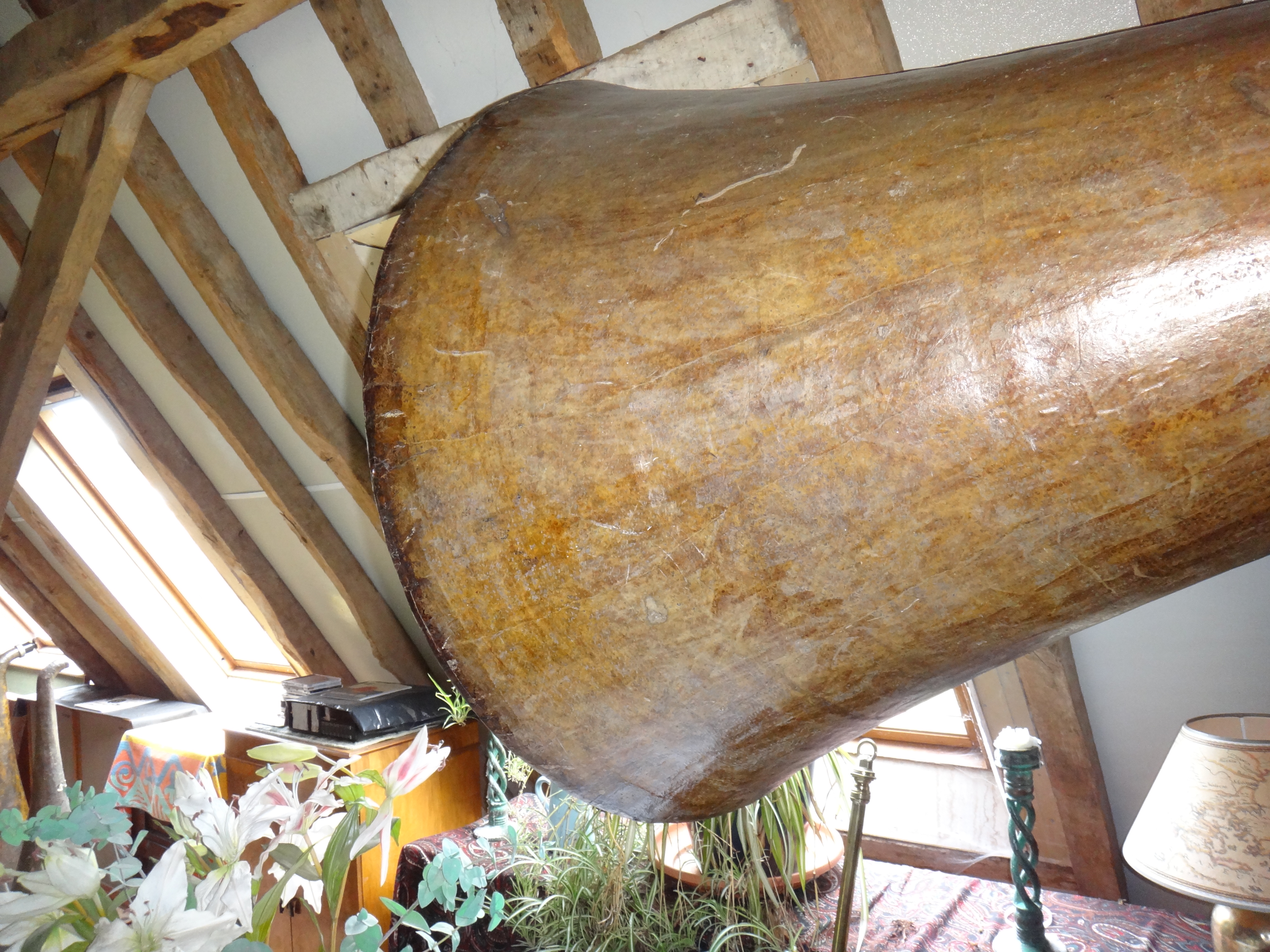

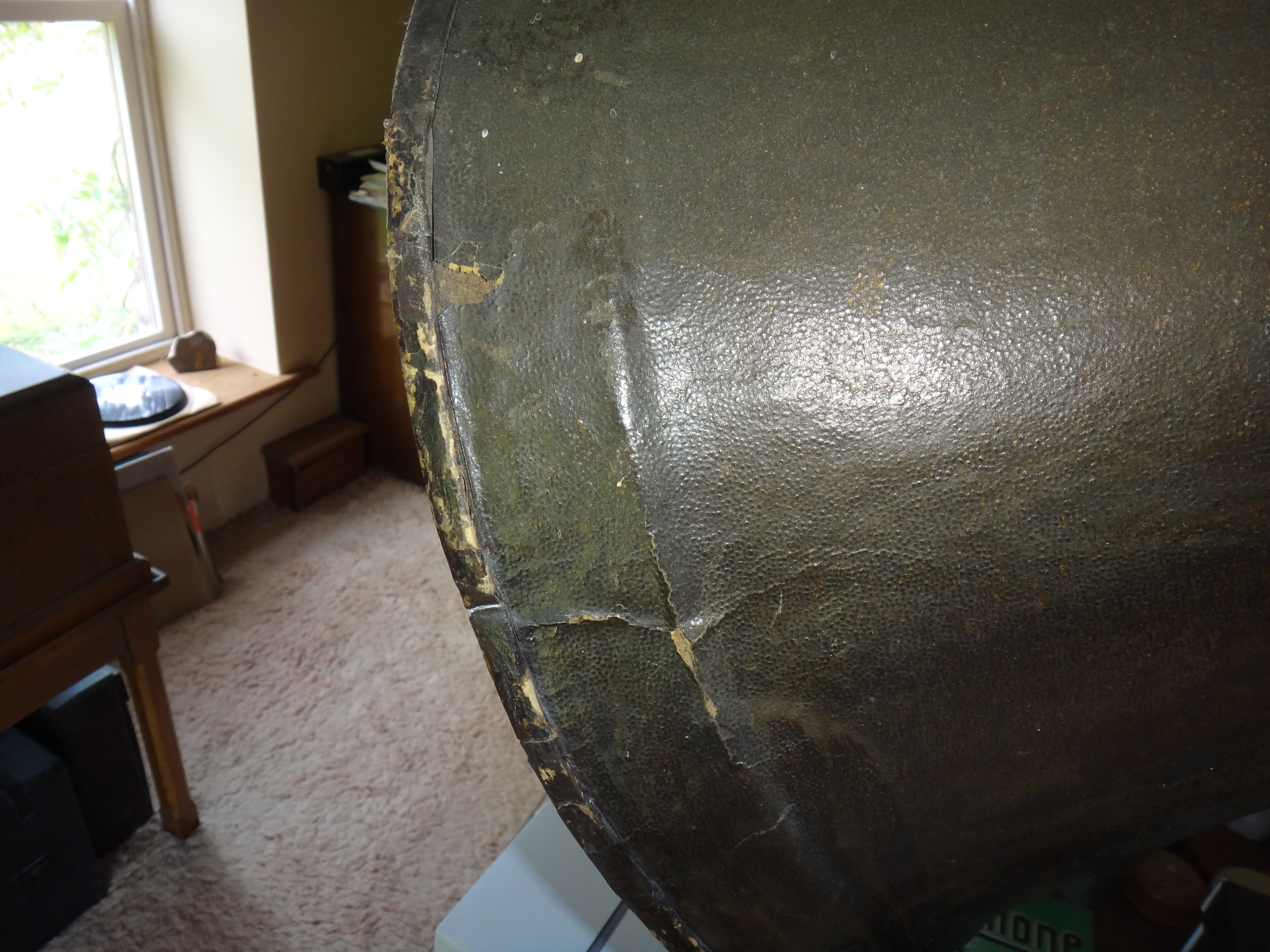

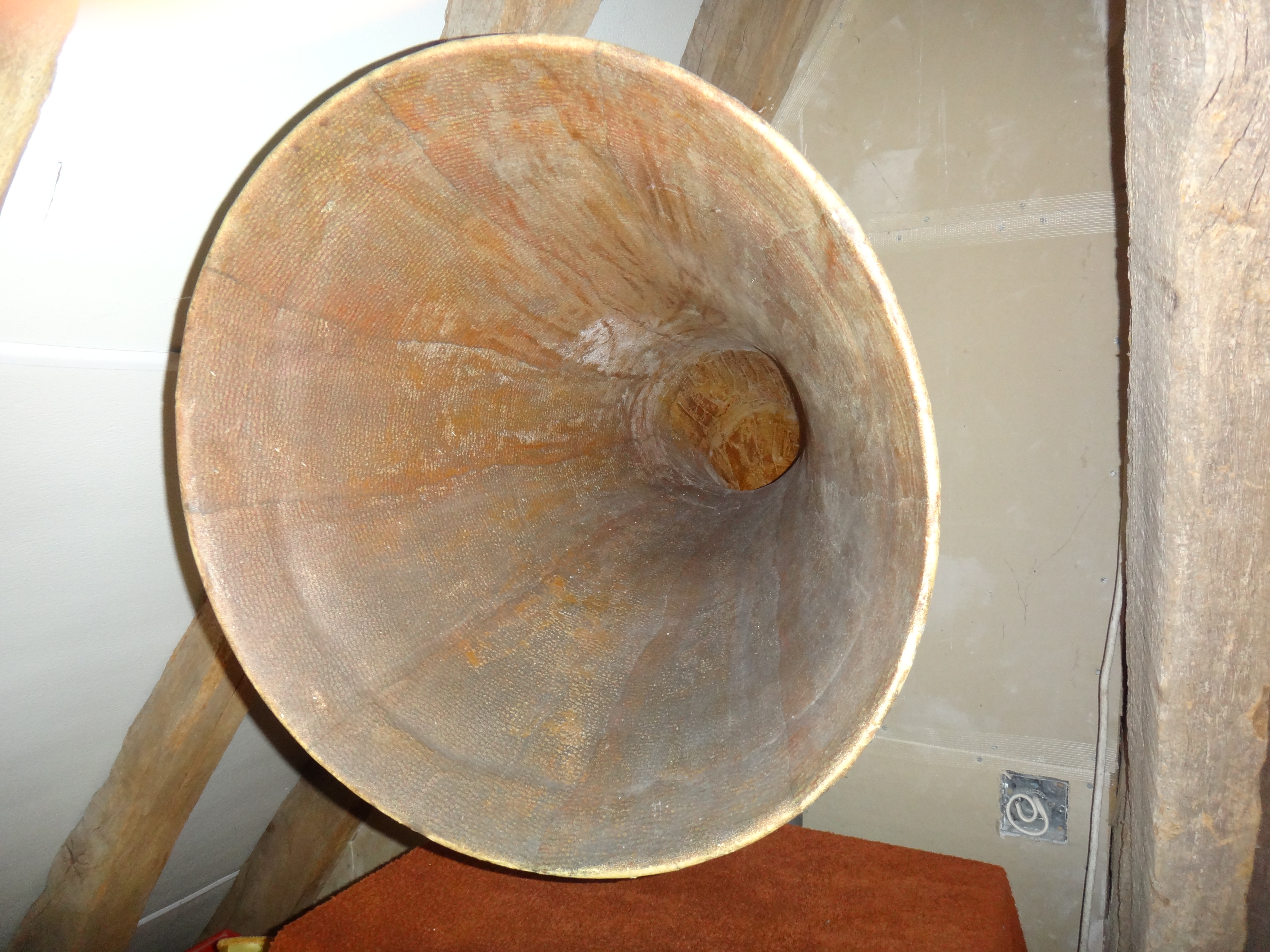

Regarding how the ring was made, it is thought that Expert must have employed wooden formers to make their horns although exact details are lost in the mists of time. These would probably have to have been constructed much like shoe-trees (segmented) so that they could be dismantled and withdrawn. It would thus have been easy to have used the bell former as an anvil to panel beat the flared soft aluminium ring. You could probably make such a former for the last two inches of your bell around the mouth to the dimensions of your foam equivalent incorporating and backed by shaped wooden segments cut on a band saw and then covered in thin plywood. A skilled panel-beater might have other suggestions.
The ring would have been incorporated in the bell as the paper was being laid (after a few layers) so that it did not show on the inside or change the internal diameter. It did show on the outside but this would have had no acoustic effect---purely cosmetic---see photos. It would seem that the internal papers were then extended and wrapped around an externally applied bead to form an attractive rolled edge.
EMG tended to fold the last internal papers over the outer edge (no ring) and then cover them with one layer of the final external decorative paper.

I don't know if the rim reinforcement protruding into the horn would do much harm or not. But I suspect that the real goal is to get a perfect stiff circular rim, very smooth, well centered and straight perpendicular (?) to the horn axis at the mouth. Kind of picturing it as a big nozzle producing soap bubbles... But the wavefronts are much faster bubbles and must be produced as perfect and undistorted as possible. Probably the famous 3D sound effect relays truly at the horn termination. I've read many papers (thanks for that one, Graham, which I already knew, but was interesting to read again) about horns, and the clever and interesting threads written in this forum, about theories and true experimental work developed by colleagues, and reports from experiments done by others, and all the articles about giant gramophones, and Wilson's books several times... And from all this I've got a clear point, that the horn termination is essential for the diffusion of the sound into the room, and for that magical sensation of ethereal sound, as if not coming from the horn.

Fabulous to see all those horn details in the photos - many thanks Graham.
