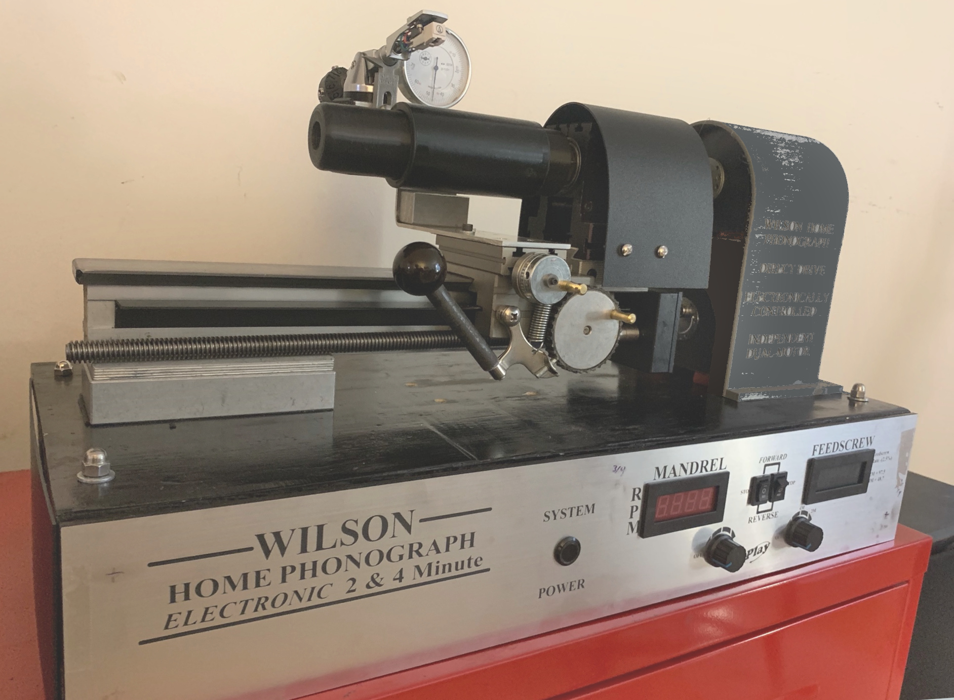

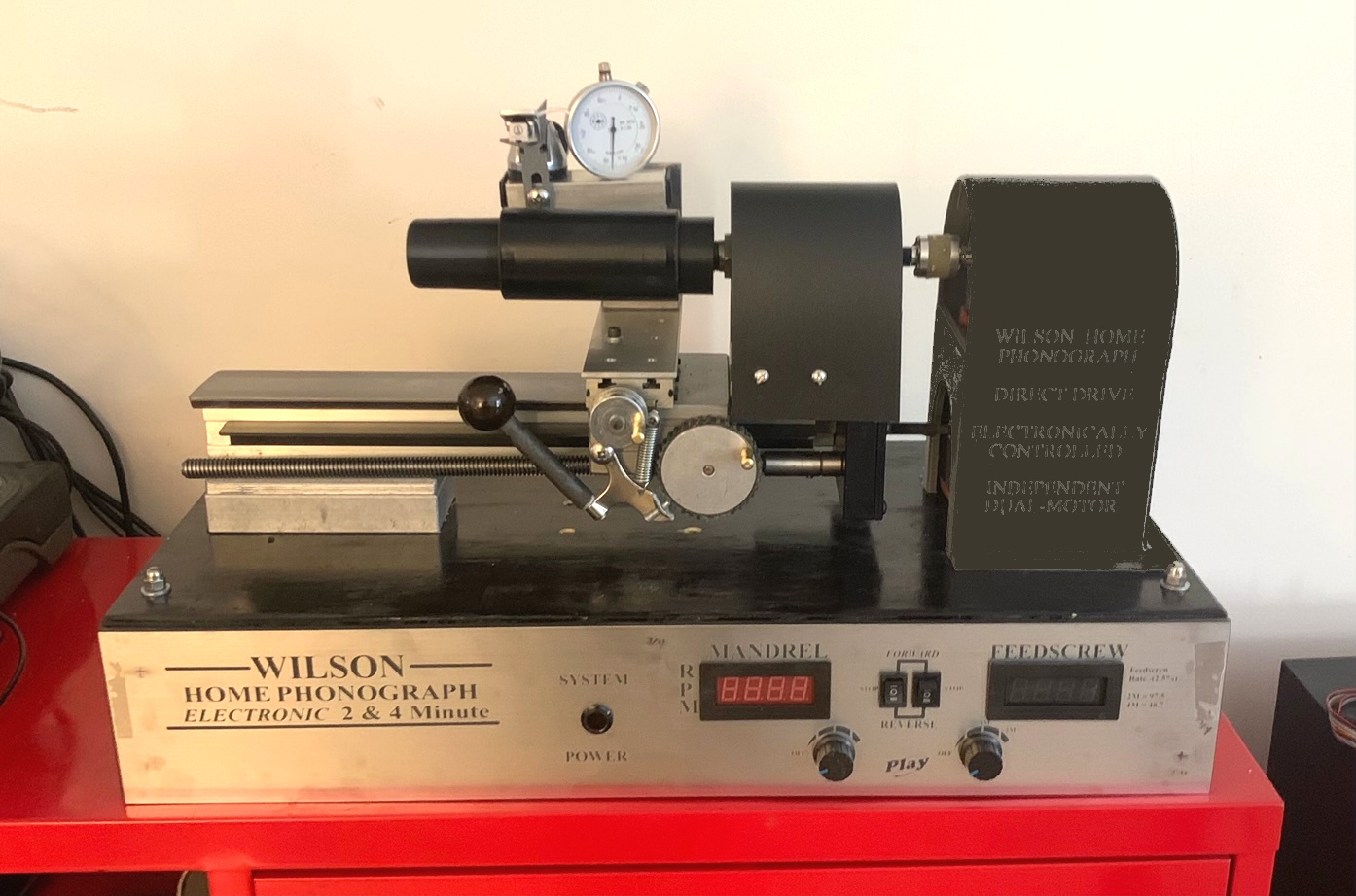

OK folks, here's a pic of the latest. The control panel has been cleaned-up and is laser etched aluminum-over-acrylic. The motor housing is custom (though I photoshopped the color for this picture of it). I've also made many custom parts for the tonearm, so that it works properly for cylinders and looks clean. A video will be coming this weekend.
Feedback is always welcome!

Looks like the motor has flipped from the left side of the machine to the right, where it was in the earlier photos, meaning the cylinder now slips onto the mandrel from the left, not the typical right. How comes?
donniej
- Posts: 905
- Joined: Thu May 26, 2016 3:46 pm
- Location: Philadelphia, PA
Re: Electronic Cylinder Machine - The "Wilson Home"
Yes, you are correct (excellent observation!). After building the initial machine, I sent pics and videos to several experts in the field of playback of early recordings... their feedback was that the initial configuration would potentially damage the stylus/cantilever if/when it hit a pit or crack in a cylinder. It turns out that's why CPS1 and Endpoint both have the mandrel facing in the same orientation as my more recent picture.drh wrote: Sat Feb 26, 2022 10:32 am Looks like the motor has flipped from the left side of the machine to the right, where it was in the earlier photos, meaning the cylinder now slips onto the mandrel from the left, not the typical right. How comes?
And it was a *ton* of work to move all the mechanical parts to the other side

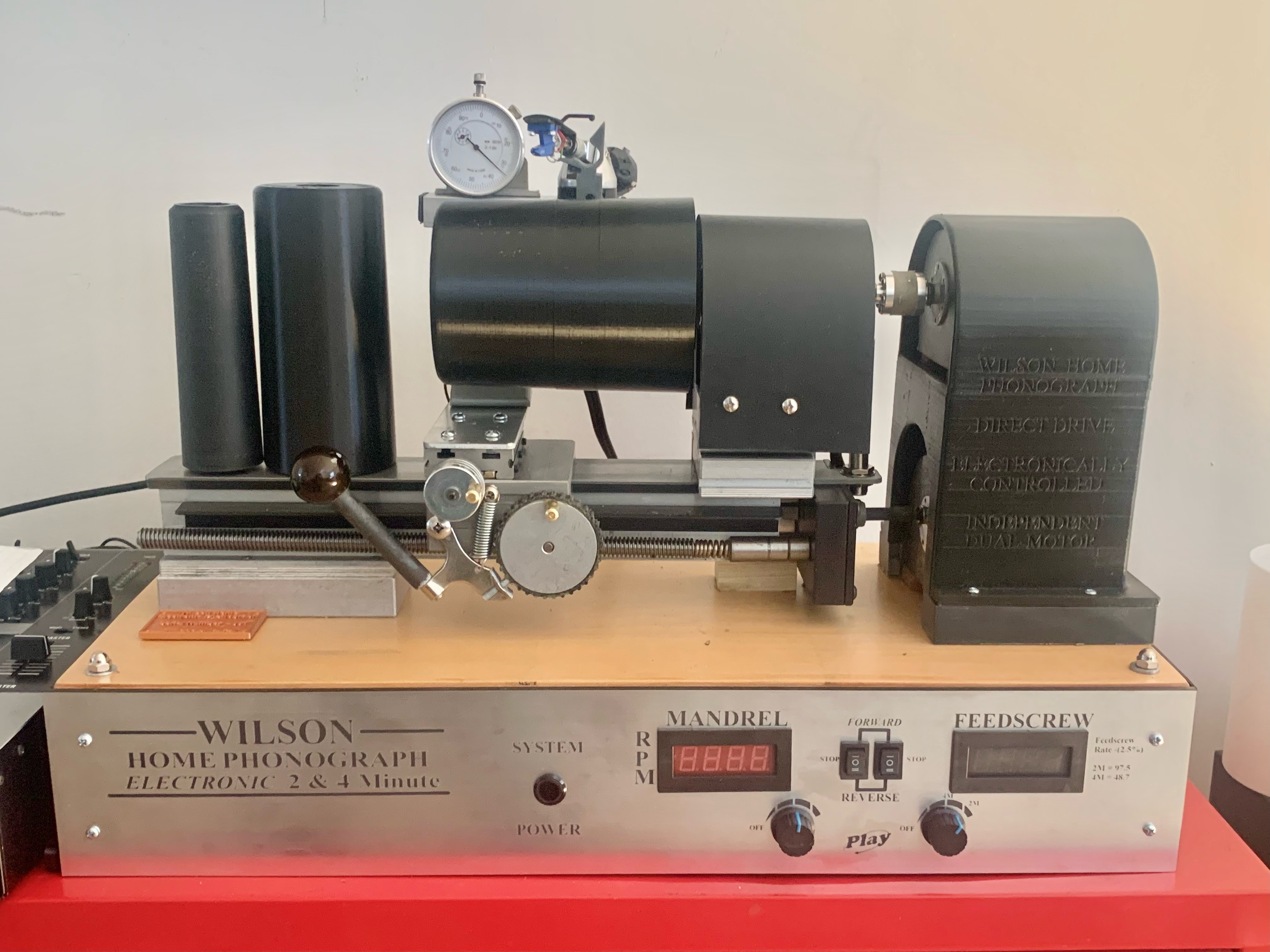

Here's one more pic, with the prototype black deck swapped for a proper finished birch one. This one also shows it with an unfinished Concert mandrel, a standard and salon mandrel are on the back of it.
