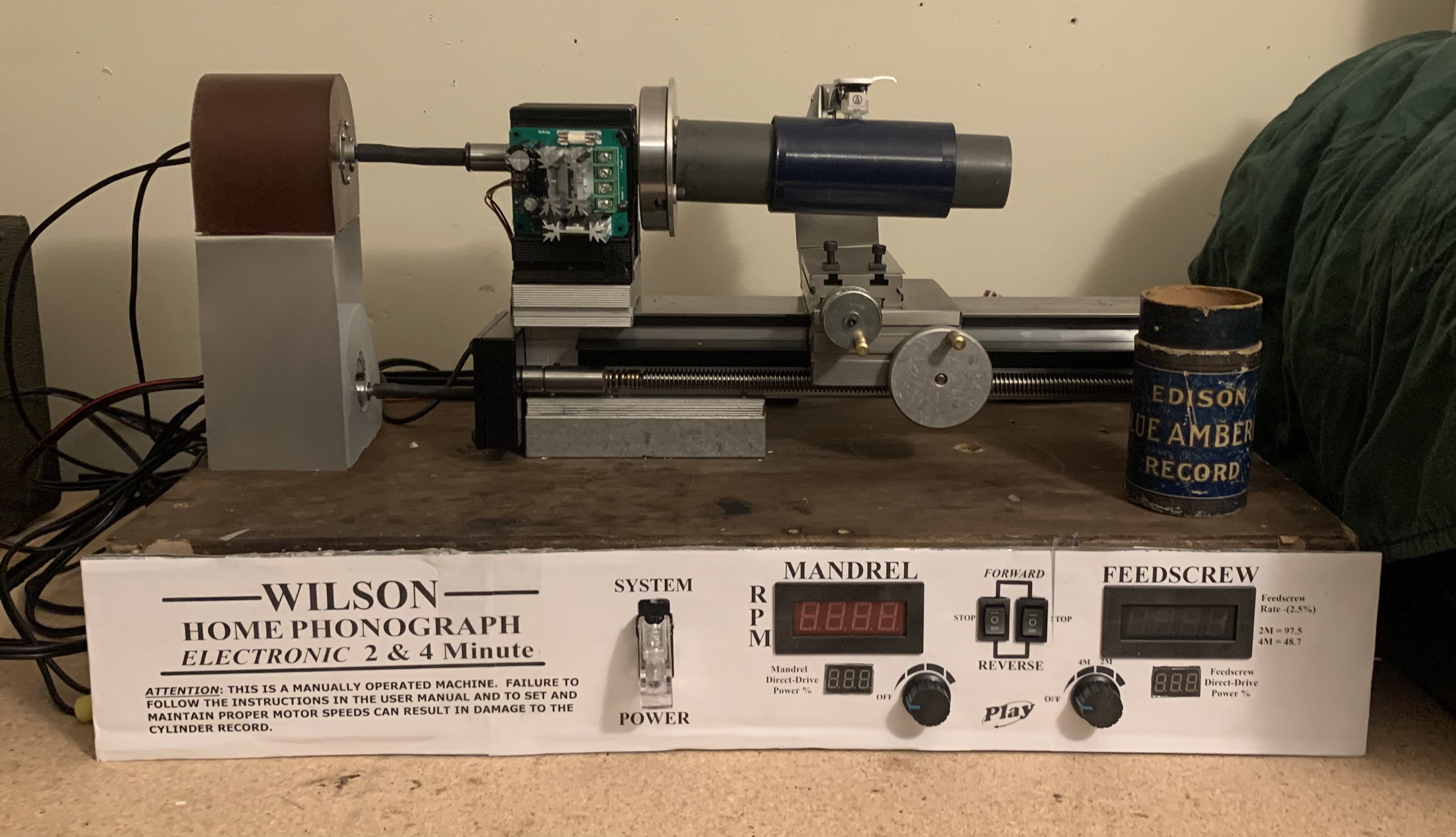

donniej
- Posts: 905
- Joined: Thu May 26, 2016 3:46 pm
- Location: Philadelphia, PA
Re: Electronic Cylinder Machine - The "Wilson Home"
I just finished the final mock-up of the controls for my upcoming “Home” cylinder machine and wanted to share a pic of the (nearly finished) prototype. A demo video will be ready later this week, after the (fully adjustable) tonearm mount is complete.
