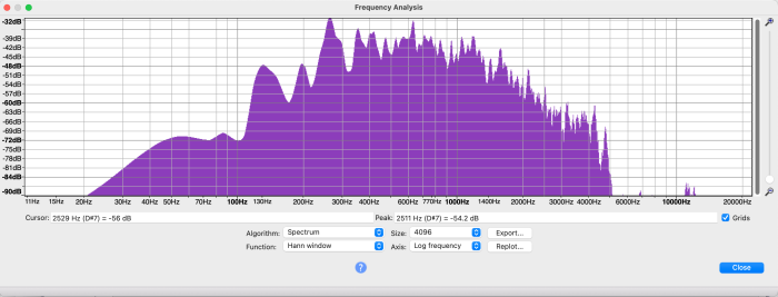

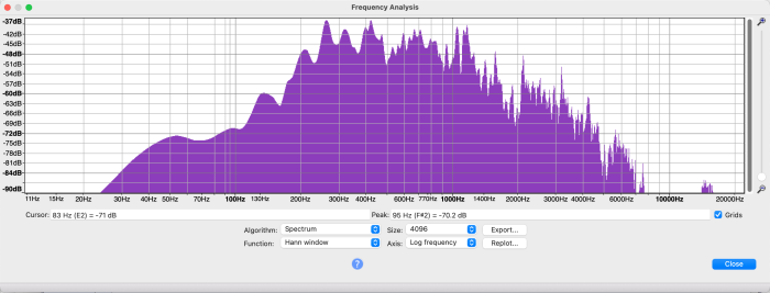

Anchorman, here's a video comparison of the two: https://youtu.be/-mkmACzBVl8anchorman wrote: Sun Oct 30, 2022 10:42 am Thanks Ethan, that would be interesting to hear the two horns side by side, same record if you get the chance!
As I mention in the description, it's not exactly a good comparison as the cut-offs are different (and the tractrix is made from corrugated cardboard--not the most acoustically inert material in the world); but it might still be useful or interesting. The ~50-60 Hz peak is just ambient noise; the ~90 Hz peak probably is too, although the gramophone might be contributing a little.
The frequency contents (below) match fairly well with the I heard listening in person--more bass from the exponential, but more treble from the tractrix.
