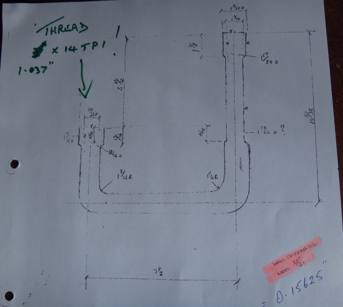

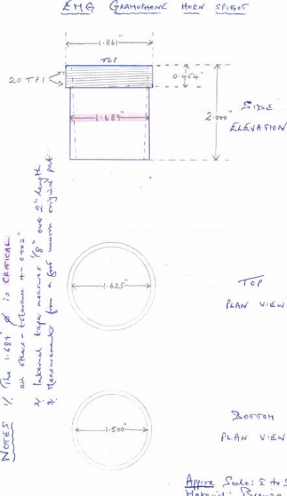

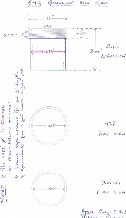

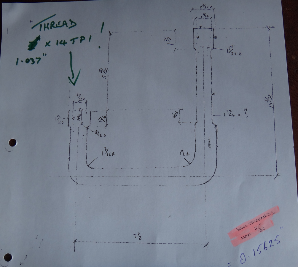

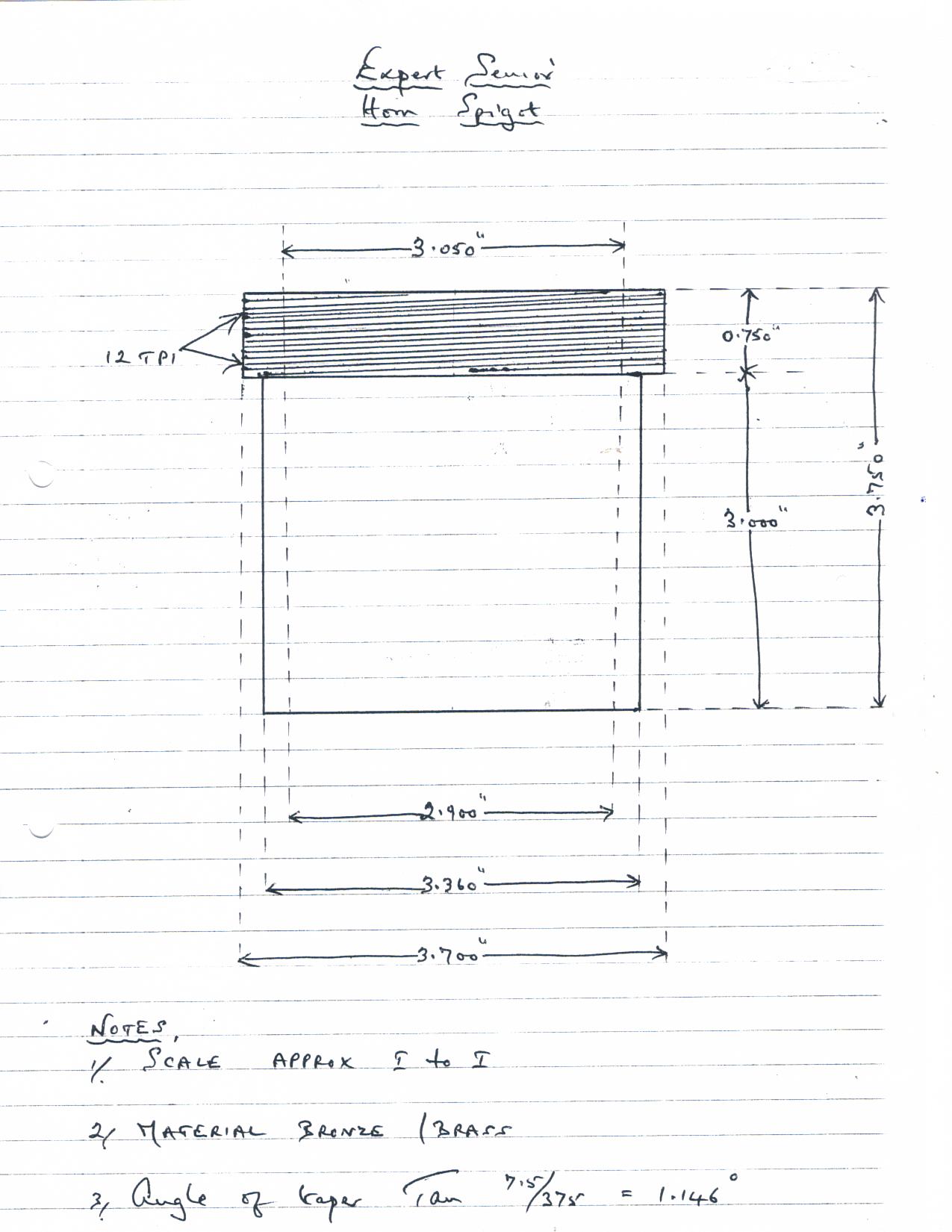

Jon, here are a few sketches which you may find helpful as you go along ? EMG had to use bronze for strength whereas, with their larger diameters, Expert were able to get away with brass. Conduit material (for mine) is LM 6 with no heat treatment---ie inert for extraneous resonance and acoustic purposes. The actual EMG material was pretty similar as far as I can tell. I could also measure the spigots for Expert Junior and Minor if you need such. Have fun !
Expert brass horn spigot dimensions.
EMG bronze horn spigot dimensions.
EMG Xb internal conduit dimensions (2" longer than X and Xa). .

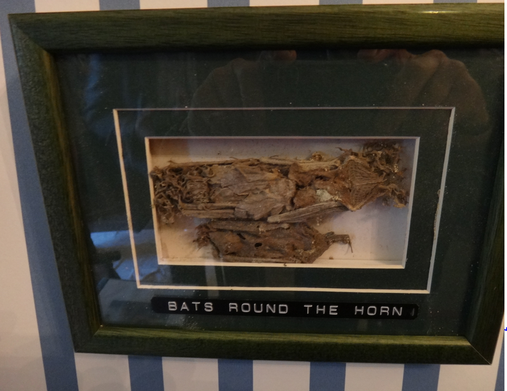

If you are considering a square horn, it occurs to me that you may not know about the great Douglas Fitzpatrick gramophone (PDF file attached below) whose horn is actually trapezoidal. You will find much correspondence and discussion here on the TMF. The performance following restoration is now extremely impressive although different from EMG/Expert due to diffusion from a larger mouth---more akin to the ubiquitous or comparatively non-directional output from an HMV 202/203. Three dead bats were found in the conduit during restoration which were impossible to see at the time our report was made ! It was really amazing that any sound emerged at all.......!

Q. How do bats make new friends?
A. With a sound wave.
Here's the obvious evidence! :lol:
