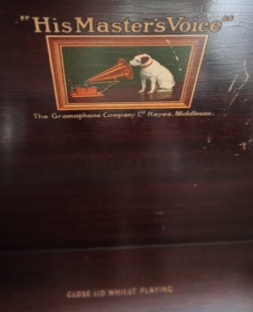

HMV were well aware that needle hiss was a problem with the 5A soundbox. Rather than cure the problem, they simply attached this transfer inside the lids of their table and cabinet models from the 104 to the 203.

Indeed they did, but you can also close the lid on the Expert, and even then there is more of a hiss with steel compared to bamboo needles.
