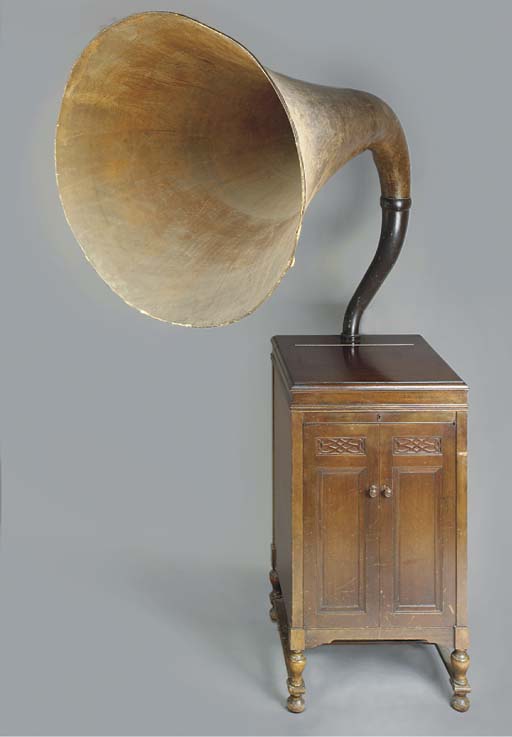

In the UK many collectors would say that the choice is between the external horn EMG/Expert (better sound) and the Re-Entrant HMV (conventional looking) but some people want the best of both, hence this HMV repurposed with an EMG horn assembly.
