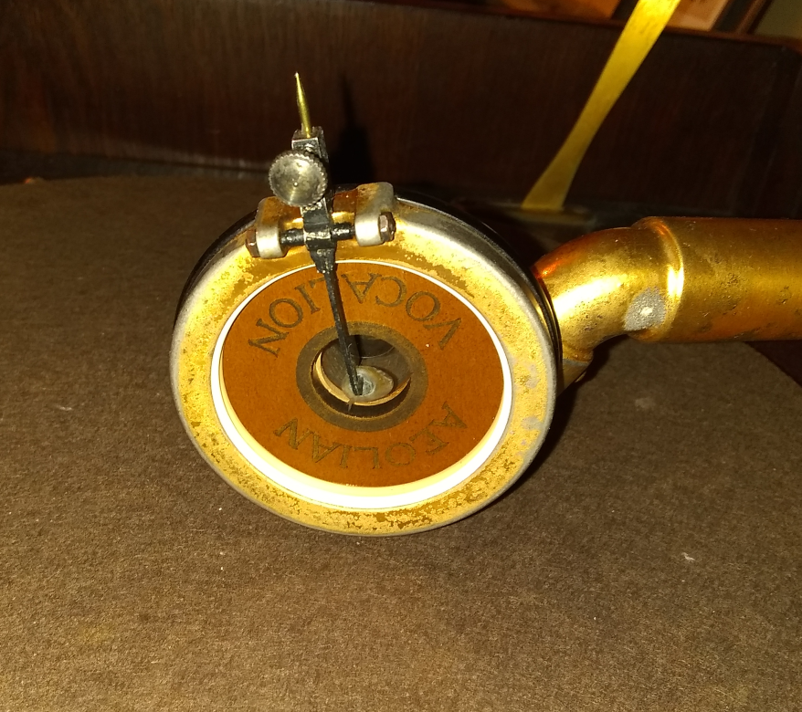

There is nothing so unusual about the back flange assembly. It was all done to isolate and seal the reproducer from the tone arm. Sonora reproducers used a very similar method. As to rotating the reproducer to ease needle insertion, I see no evidence that that was ever part of this design. In fact, I have never heard of such a feature on any phonograph. I suppose the closest thing to that would be hinging the reproducer back on a Victor.I will perhaps go out on a limb here and say that the Bestone Celebrity is certainly an oddball reproducer, As stated above, the only reason that I can think of for having such a strange back flange assembly (extra fabrication and labour costs as opposed to a single piece/single gasket unit) is if they had been trying to come up with a rotation mechanism but then just abandoned the attempt and made do ...

Thanks.JerryVan wrote: Mon Jan 22, 2024 6:34 am There is nothing so unusual about the back flange assembly. It was all done to isolate and seal the reproducer from the tone arm. Sonora reproducers used a very similar method.
As willingly and openly confessed above, I do not have any great depth of experience. I have only ever dismantled and rebuilt two reproducers, both identical except for finish. These are from/for the first machine I bought. So to a certain extent they have defined for me in my limited experience what is normal.
Welcome to my little world of rotating reproducers!JerryVan wrote: Mon Jan 22, 2024 6:34 am As to rotating the reproducer to ease needle insertion, I see no evidence that that was ever part of this design. In fact, I have never heard of such a feature an any phonograph. I suppose the closest thing to that would be hinging the reproducer back on a Victor.

Interesting. I have never owned an Aeolian so perhaps that's a new one on me. I'm still left to wonder if that's just the position that allows removal of the reproducer, or if it's truly intended as an easier means to replace the needle. Either way, I see how you came to your conclusions.Lah Ca wrote: Mon Jan 22, 2024 9:25 amThanks.JerryVan wrote: Mon Jan 22, 2024 6:34 am There is nothing so unusual about the back flange assembly. It was all done to isolate and seal the reproducer from the tone arm. Sonora reproducers used a very similar method.
Welcome to my little world of rotating reproducers!JerryVan wrote: Mon Jan 22, 2024 6:34 am As to rotating the reproducer to ease needle insertion, I see no evidence that that was ever part of this design. In fact, I have never heard of such a feature on any phonograph. I suppose the closest thing to that would be hinging the reproducer back on a Victor.![]()

The old Columbia machines like the Eclipse have such feature of allowing the soundbox to rotate to facilitate installing the needle, and also as a rest position that does not punch a hole in the turntable. This is not that obvious today because the soundboxes were made of pot metal and many are swollen and stuck in place, but they have the design of a ridge that ends on a hole on one side and a little bearing on the other side, that clicks in position once it fits in the hole.JerryVan wrote: Mon Jan 22, 2024 6:34 am In fact, I have never heard of such a feature on any phonograph. I suppose the closest thing to that would be hinging the reproducer back on a Victor.

Thanks Carlos & Lah Ca. I guess it never occurred to me that the ability to rotate the Columbia reproducer was intended for needle changing. I'm learning things!CarlosV wrote: Mon Jan 22, 2024 2:03 pmThe old Columbia machines like the Eclipse have such feature of allowing the soundbox to rotate to facilitate installing the needle, and also as a rest position that does not punch a hole in the turntable. This is not that obvious today because the soundboxes were made of pot metal and many are swollen and stuck in place, but they have the design of a ridge that ends on a hole on one side and a little bearing on the other side, that clicks in position once it fits in the hole.JerryVan wrote: Mon Jan 22, 2024 6:34 am In fact, I have never heard of such a feature on any phonograph. I suppose the closest thing to that would be hinging the reproducer back on a Victor.

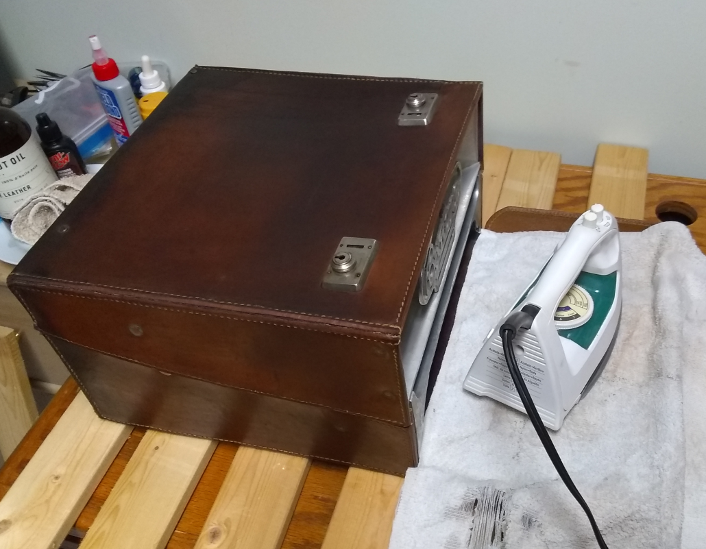

Reshaping the Lid
More work to do yet, but I have the lid flat enough now that it closes without having to push it.
A bit of heat from an iron, followed by time under a box of 12" records. The wood pieces are old Ikea bed slats.
