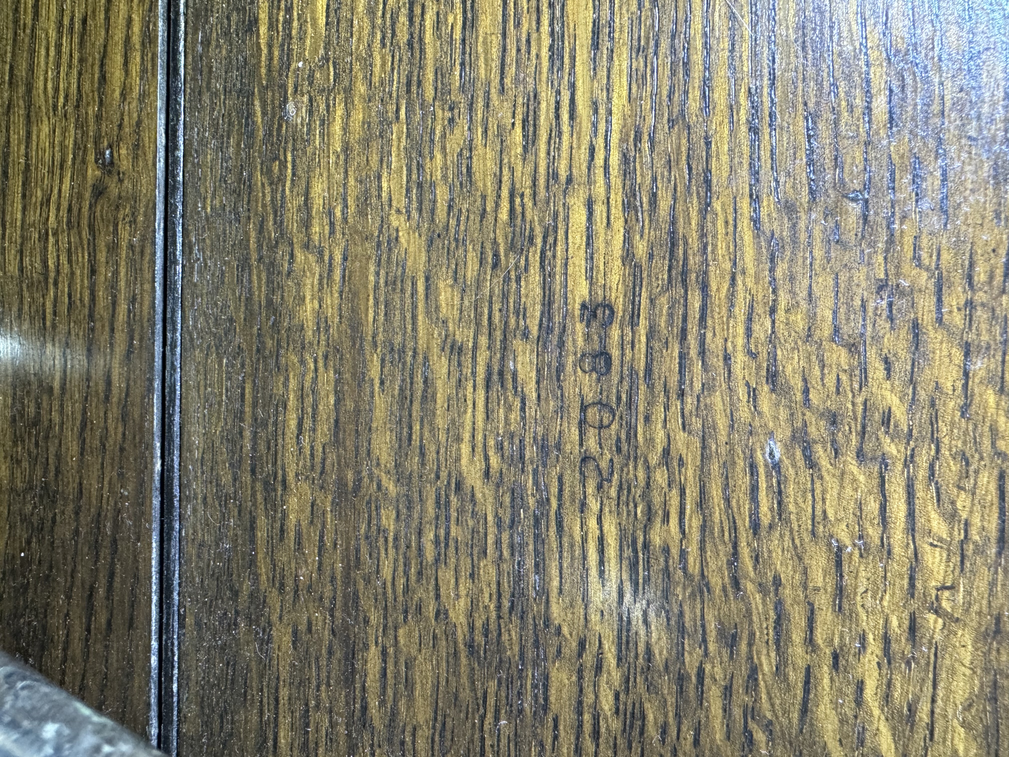

Adamp1gramophone wrote: Fri Jun 14, 2024 12:05 pm Here is the Mark IX I won from the auction. The identification number is ‘885’, but I am unsure of the exact production date this relates to. It would be great if anyone could help! I did use the forum, 'EMG Register to assist dating and EMG/Expert synopsis', but the links appear to have all expired.

emgcr wrote: Sat Jun 15, 2024 6:13 am Well Adam, many congratulations---that is quite a story ! To find the correct soundbox so quickly is extraordinary---well done indeed. What an exciting journey you must have had.
Thank you for showing the number which does give a vague idea as to date of manufacture. EMGs were numbered in the nineteen-thirties and post WW2 (Experts had no numbers) but there was no distinction made between models. Also, sadly, there are no records that anyone has found so far showing what exact dates those numbers referred to so it is usually necessary to make an educated guess. I have a note on file from Frank James saying that a Mk 10a No.412 is known to have been made in 1932. I own a Mk IX which had a broken horn when I bought it revealing the newspaper from which it was made. The Daily Mirror was able to confirm the date as 8th July 1948. The stamping on the deck-board shows No.2118. We thus have definite parameters and it would seem that your No.883 may have started life in the mid nineteen-thirties ?

Inigo wrote: Sat Jun 15, 2024 8:45 am If we could think of 412 in mid-1932 and 2118 in mid-1948, and taking as valid the years 1932-1940 and 1946-1948 for full production (no production during the 1940-1946 era) we have a ratio of 1706 units in ten years, so 170.6 units per year, or 15 per month, assuming one month vacation each year. It sounds a bit incredible... But...!
Then number 883 would fall in the spring of 1935.
It's pure speculation, though...

I love the estimations! What would you date 2083 as?

Adamp1gramophone wrote: Sat Oct 12, 2024 6:15 pm What would you date 2083 as?
We know for certain that 2116 used newspaper for horn construction from 8th July 1948. Therefore, in my estimation, yours being 33 numbers earlier, probably makes it 1947.

I apologise for the typo that seems to have crept in. My own Mk IX bears the number 2116, not 2118 as stated above. I have tried to correct the original post but unsuccessfully.

emgcr wrote: Sat Oct 12, 2024 7:21 pm
Thanks Graham! That aligns with the information on the plaque. On my post about the newly acquired Mark 9 another forum member posted this link:
