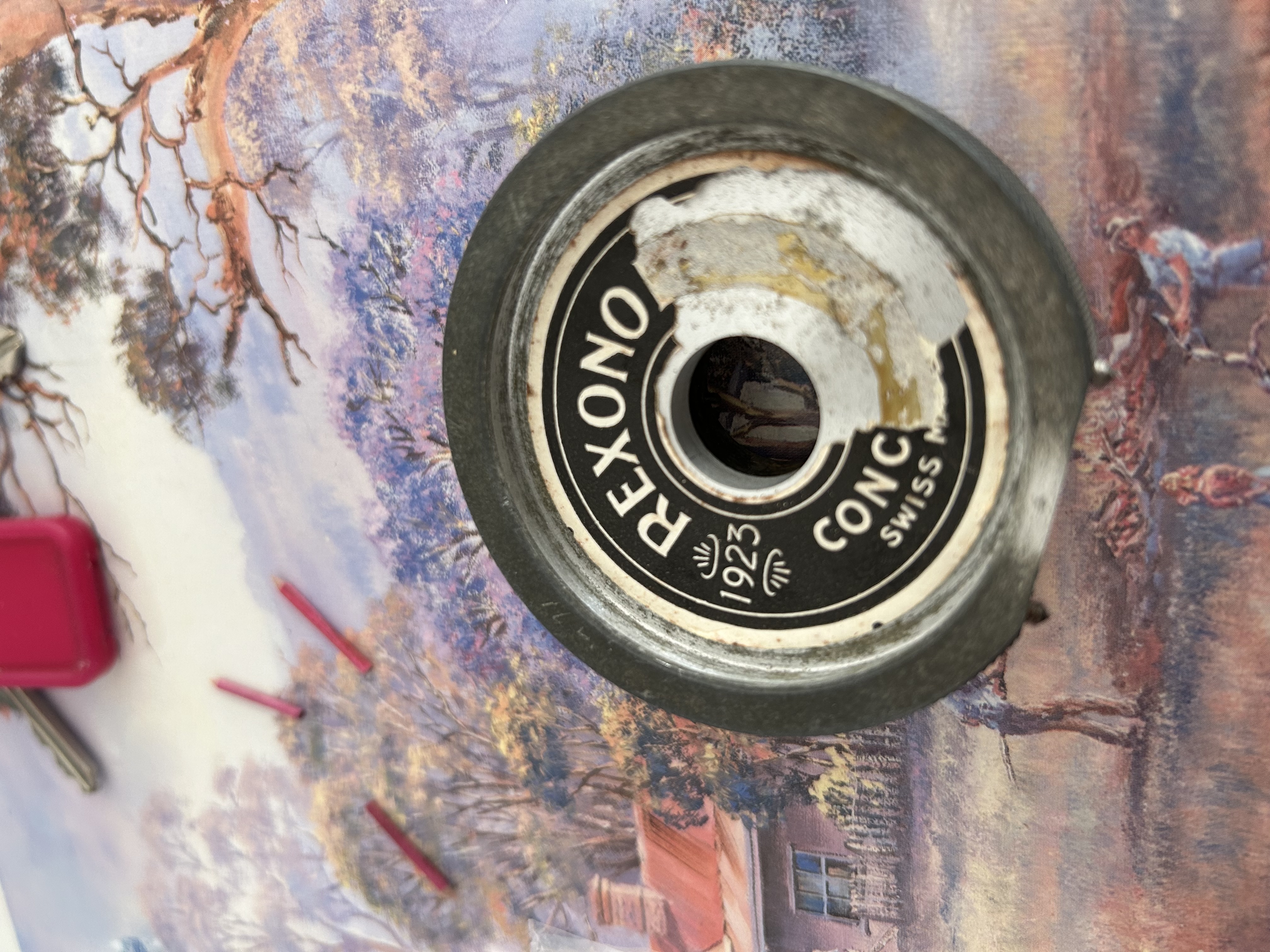

…and one more picture, because the other one made it look a bit dirtier than it is.
- Posts: 4452
Re: 1923 Rexoport soundbox
The diaphragm screw is usually sealed with wax. You can definitely and carefully scrap it out to remove the screw. There will be also a wax seal at the opposite side, where the needlebar sits on the diaphragm.
These seals can be removed, helping with a bit of soft heat.
It's not recommendable to move around the diaphragm while attached to the needlebar, as this can act as a lever and any small kick is amplified and the centre of the diaphragm spoiled. It's a delicate point where the mica can easily disintegrate or delaminate, and the stiffness integrity of the diaphragm being spoiled. Three diaphragm stiffness must be uniform and clean all across the surface to provide a good sound. Any bubbles, breaks or signs of delamination spoils its performance.
Ok, thanks for letting me know. My diaphragm does have small ‘bubbles’ in one or two places around the edge. They’re barely noticeable though. I would rather keep the diaphragm original, that’s all.
- Posts: 6381
The slight delamination at the edges is no problem at all and better than a lot of examples.Sir_Lunchalot wrote: Mon Feb 24, 2025 1:41 am Ok, thanks for letting me know. My diaphragm does have small ‘bubbles’ in one or two places around the edge. They’re barely noticeable though. I would rather keep the diaphragm original, that’s all.
To size the gaskets, just place a length of gasket material in the reproducer and mark a spot maybe 3/32" past the overlap at the end of the gasket hose. Cut it there to make the hose a little extra long, as I mentioned in my previous post.
Thanks for that. I actually just went ahead with re-doing the gaskets after I asked, and I’m pleased to say that I used that exact method. I’m glad that you replied though, as you’ve confirmed that I did it right.JerryVan wrote: Mon Feb 24, 2025 6:27 amThe slight delamination at the edges is no problem at all and better than a lot of examples.Sir_Lunchalot wrote: Mon Feb 24, 2025 1:41 am Ok, thanks for letting me know. My diaphragm does have small ‘bubbles’ in one or two places around the edge. They’re barely noticeable though. I would rather keep the diaphragm original, that’s all.
I gave the gramophone a test run on my few acoustic recordings, and I’m happy to report that it plays very well now! I think it may be slightly quieter now, but the tone is that much softer (less harsh I mean) and ‘fuller’ than it was previously. Overall, despite the comparatively tiny horn, it does sound very nice!
Thanks for the help and advice Jerry, and also from everyone else that has chimed in here. I really appreciate it!
