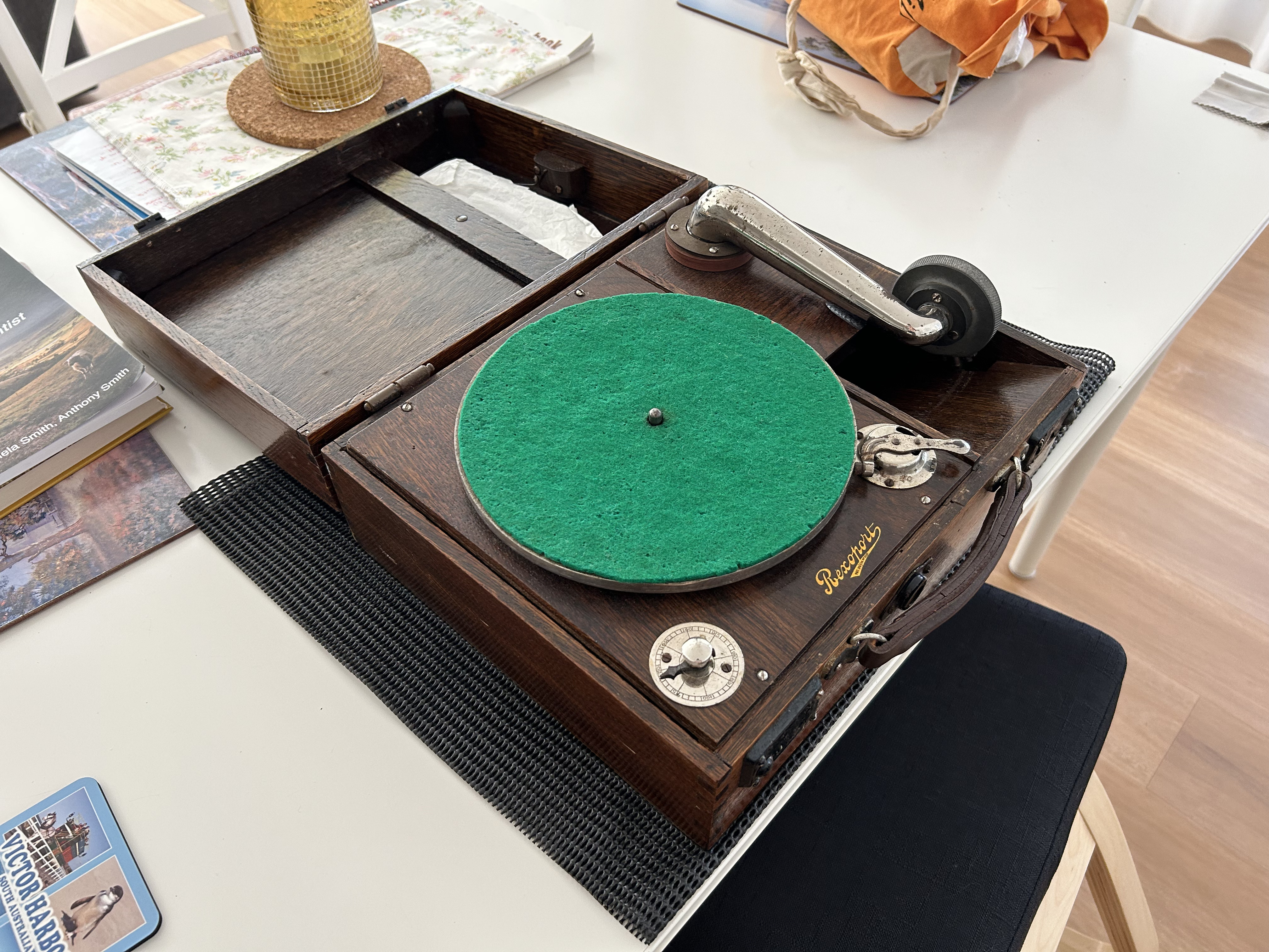

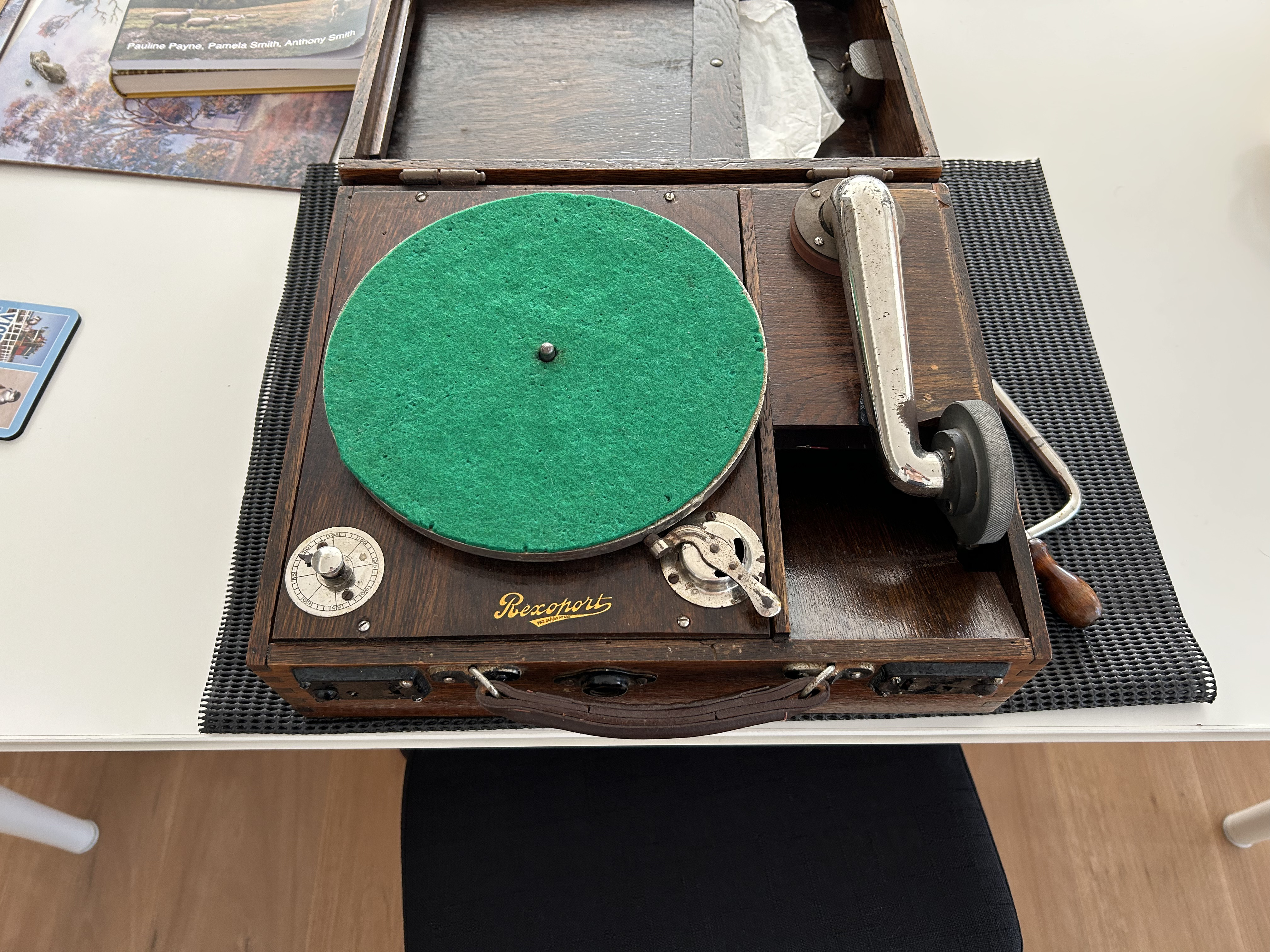

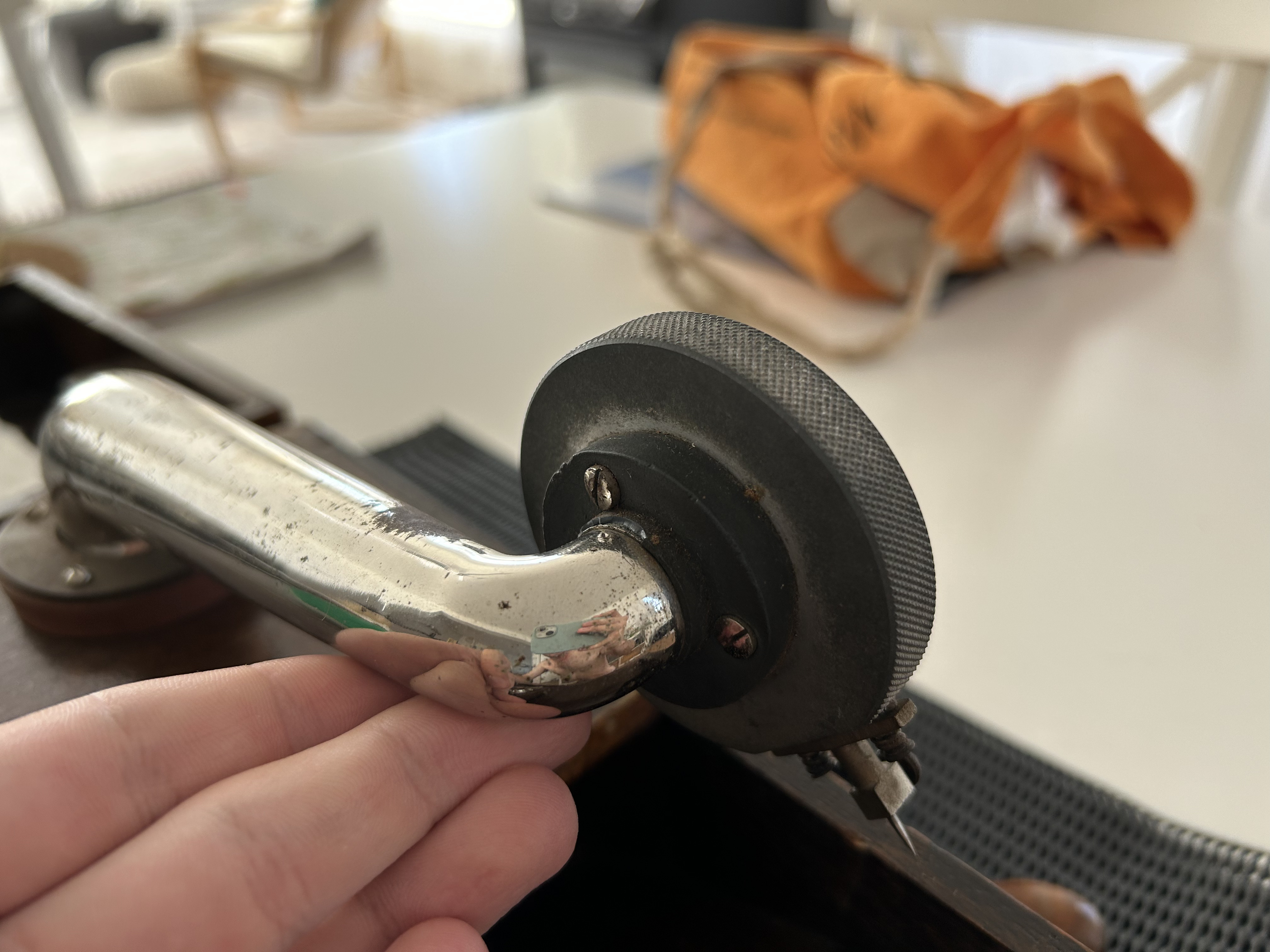

Well, it took me a while, but I've finally got around to having a proper look at the gramophone and taking some pictures. I actually clean forgot about it, which I feel a bit bad about!
Anyway, here are some pictures (finally!) of the gramophone in question:
- Posts: 6730
Re: 1923 Rexoport soundbox
Your reproducer appears to be in great overall condition, but will need to have the gaskets replaced.
