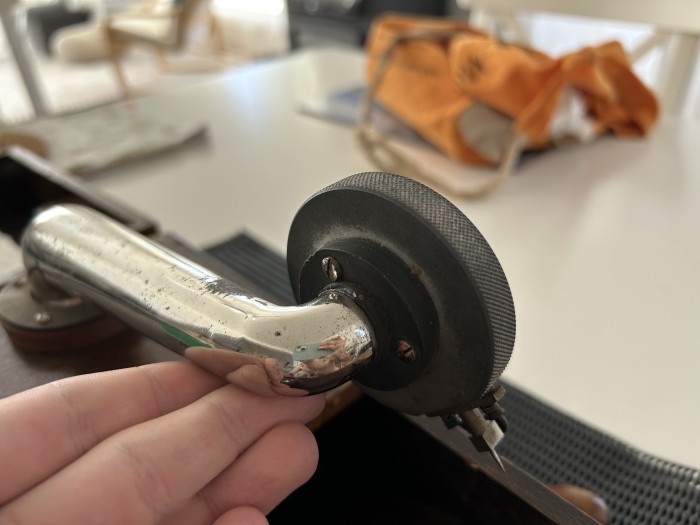

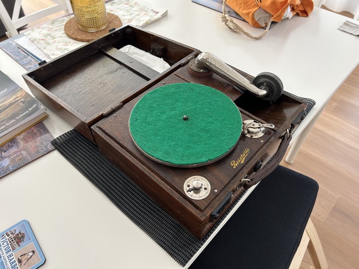

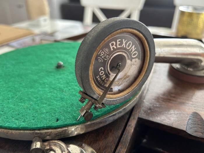

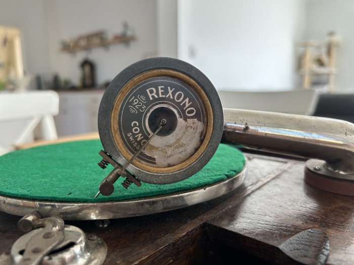

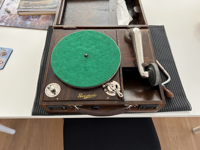

Well, it took me a while, but I've finally got around to having a proper look at the gramophone and taking some pictures. I actually clean forgot about it, which I feel a bit bad about!
Anyway, here are some pictures (finally!) of the gramophone in question:
Reverse side of soundbox
Soundbox detail view (2)
Soundbox detail view (1)
General overview (2)
General overview of gramophone (1)
Posts: 6381
Re: 1923 Rexoport soundbox
Your reproducer appears to be in great overall condition, but will need to have the gaskets replaced.
