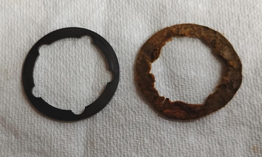

In my second and probably older VV2-55, there is a very thin ring of felt under the ball bearing spacer in the ball race cup. I may have damaged it slightly, not knowing it was there, while trying to clean out the old grease. But it seems to be intact enough so that I can probably put it back in.
My first machine most definitely did not have this feature.
What purpose would this ring serve? I can only assume noise dampening. Embedded with grease, it would keep the spacer in place, preventing the generation of any mechanical noise that might be caused by its movement if it were free. Only a guess, though.
I will post a pic once the ring is out of the solvent bath.

The felt ring was most likely intended to be used as a gasket between the base of the tone arm mount and the motor board. With the felt placed under the bearing separator, do the bearings then ride on the felt?
Lah Ca
Posts: 1415
Re: Number of Ball Bearings in a VV2-55 Arm Race?
Post by Lah Ca »
JerryVan wrote: Sat Aug 02, 2025 6:32 pm The felt ring was most likely intended to be used as a gasket between the base of the tone arm mount and the motor board.
No. There is the standard cork gasket there.
JerryVan wrote: Sat Aug 02, 2025 6:32 pm With the felt placed under the bearing separator, do the bearings then ride on the felt?
I don't know. The felt was definitely under the bearing spacer. I think I can see impressions through the felt where ball bearings might have been, but there were no bearings left in the ball race here. The arm support had been broken for a very long time I think, and the bearings probably got knocked loose and fell out.
The picture isn't so good here below. It was taken at an angle so things look out of round. Also the spacer looks dark, which it isn't. The picture was taken in poor light in my garage.
Posts: 6942
If it were mine, I'd omit the felt washer. It can only serve to impede the free rolling of the bearings.

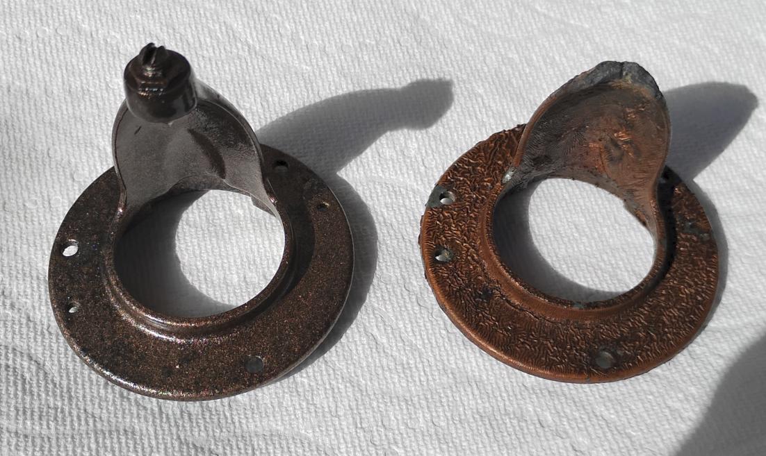

My attempt at colour matching ....
I couldn't quite get enough orange/copper colour into the gold/bronze, and I don't know how to get the wrinkled effect in the paint. But here is my best effort:
I used the closest coloured metallic gold/bronze I could find for the thin first and third coats. The for the second and fourth very light coats, I used a dark (blackish) hammered bronze, lightly splattering the parts from a distance.

VictrolaGuy - Walt
Posts: 66
Joined: Wed Jan 07, 2009 8:18 pm
Post by VictrolaGuy - Walt »
Google VHT Wrinkle Plus
Lah Ca
Posts: 1415
Post by Lah Ca »
VictrolaGuy - Walt wrote: Sun Aug 03, 2025 6:25 pm Google VHT Wrinkle Plus
Interesting. Thanks.
I will fill this bit of information away.
The only colours available in the VTH Wrinkle Plus paint here seem to be red and black.
If I were to try this again, I would apply a base coat of the red to get a good wrinkle and then lightly spray with the different coloured gold/bronzes.

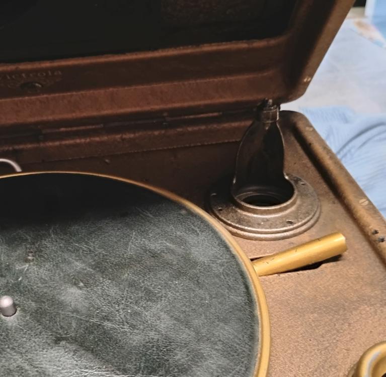

Jim_Cannon
Posts: 35
Joined: Mon Nov 02, 2020 2:32 pm
Personal Text: "If you want to kill any idea in the world, get a committee working on it." - Charles Kettering
Location: Young Harris, GA
Post by Jim_Cannon »
I have used the red wrinkle paint on other applications and it is a real pain to work with. You must put down a base color first, because the wrinkle paint is very translucent. You need to get the paint thickness exactly the same everywhere to get the same wrinkle height all over. Hard to do. I stripped it off and went with a solid, smooth gloss red. It looks much better.
My VV 2-55 came to me all in an original "British Racing Green" color. It looks really good with the gold hardware. I think I posted a few pictures of it previously. I will gladly post some again, if anyone would like to see them. I can see, in places where use of the phonograph has rubbed through some of the paint (patina), that they used a classic red primer under the green. I have left it all original. I just cleaned it and waxed it with some original green automotive Turtle Wax.
Dischoard
Posts: 687
Location: St. Albans, Vermont
Post by Dischoard »
Lah Ca wrote: Sun Aug 03, 2025 6:21 pm My attempt at colour matching ....
And you were able to get those back brackets separated from the tonearms without incident?
