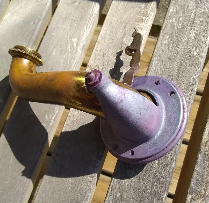

Interestingly it took a variety of solvents to remove different components of the paint. In the end acetone was required, followed by methyl hydrate.
Here below you can see the remnants of the purple, especially in the pot metal. This is before cleaning things (residual paint and some rust) up with steel wool.

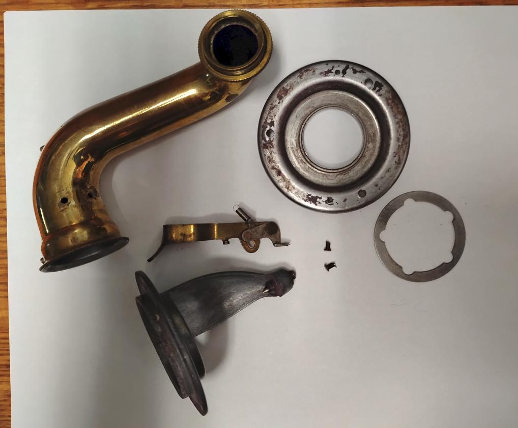

I acquired a second VV2-55, this one in much better general mechanical and cosmetic condition but with a broken tone arm support bracket. I had a few minutes to look at it today.
viewtopic.php?t=60442
The construction of the arm on this second machine is quite different (as is a lot else--this second one is generally much better made). The arm is not riveted together but is rather held together with screws, and so it is possible to totally disassemble the entire tone arm.
Unfortunately, the reproducer which is in exquisite cosmetic condition, is mechanically trashed, having been bounced around on the loose end of the broken tone arm assembly for many years. Perhaps it can be salvaged in skilled hands. My other reproducer is seemingly just fine; it just looks ugly.
Anyway, I am now quite confident that I will be able to drill out the rivets carefully from the other arm assembly and make one good one out of the two.

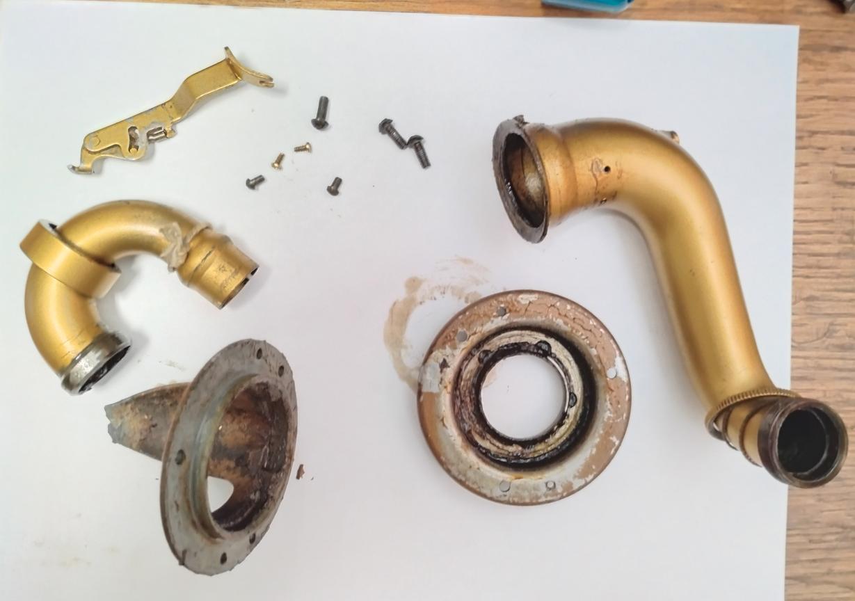

Here is the dismantled tone arm assembly from my first machine. I included two of the four rivets in the picture.
The rivet material is quite soft, and therefore they are mostly easy(ish) to drill out. They are not brass but some sort of white metal.
Care and patience are required.
The two rivets which hold the arm bracket to the ball race housing can be accessed from the bottom of the housing. Their shafts are partially hollow to allow them to be flared out. So in a sense they are already center punched. I intermittently used drill bits of different sizes to help keep the larger bits centered. Once I had removed the flared out metal, I was able to drive the rivets out gently.
Separating the support bracket from the ball race container was a bit harder. The two pieces were stuck together quite fiercely. I had to use a very fine bladed small jeweler's screw driver and go around the edge slowly and gently working the two pieces apart.
Getting the auto-brake trigger arm off the tone arm was a bit trickier, because there is no access to the hollow end of the rivets. Here I had to file the rivet heads flat and almost flush with the auto-brake arm and then use a fine sharp awl to mark a center point. I would drill a little and then use the awl again until I had a depression deep enough to keep the larger drill bits from wandering. Then it was just alternating larger and smaller bits until the rivets were almost down to the auto-brake arm. Then it was only small bits. The factory worker who put the two pieces here together had great trouble with one of the rivets. There are the impressions of one or two (possibly even three) mis-strikes with the riveting hammer/press in the metal of the tone arm. And the rivet was a bit mangled. I had to drill this one out fully. It could not be tapped out.
