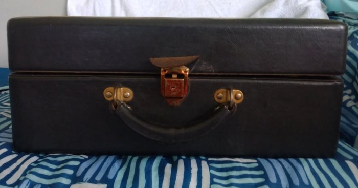

The case lid looks a little out of alignment. But look at those corners!

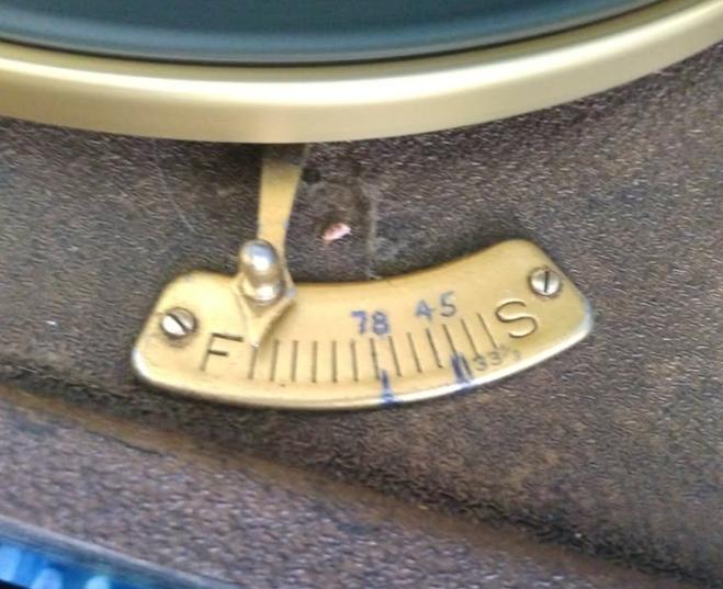

VanEpsFan1914 wrote: Mon Apr 07, 2025 6:56 pm Looks like someone was using it when 45s came out?
Yes. Interesting. But if you look closely, you will also see 33⅓ in smaller numbers on the speed control. The machine would have no problems with 45s besides destroying them, and in good condition it might play two or three sides before running out of steam. But would it even play a whole side of a Microgroove LP?
Wonder if it is for Program Transcriptions- the Victor "LPs" that were issued 1931-33. The popular series ones were standard groove shellacs. I think they were optimistic at a spring machine holding a steady speed at low RPM, though, if so.

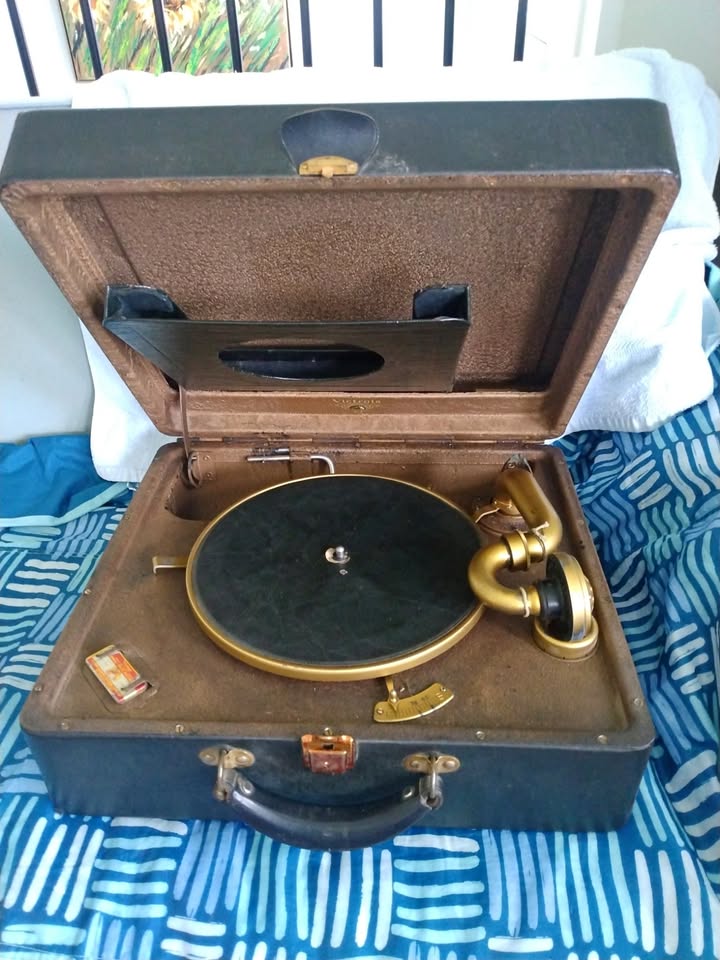

The 2-55 I have has this color scheme, the sort of gold/brown hammered finish. Yours has the smooth green finish? These are terrific machines, I would certainly pick up any one I can find. Just not for $400. Especially with that broken pot metal back bracket. You can see that it is clearly broken. I think I heard of someone recreating this in a 3D print? But definitely not the same. This one, in its current condition, unless the broken piece is still there and can be superglued or epoxied back together, is pretty much only worth the value of the reproducer.

Dischoard wrote: Wed Apr 09, 2025 6:08 pm These are terrific machines, I would certainly pick up any one I can find. Just not for $400. Especially with that broken pot metal back bracket. You can see that it is clearly broken.
$400 CDN is considerably less than $400 USD.
Yes, I failed to notice the tone arm bracket. I wasn't really looking all that closely. I was just in amazement at the condition of the case and the general loveliness of it all in comparison to my machine. I would love to buy the machine to use with parts from mine. But not for $400, even $400 CDN.
Dischoard wrote: Wed Apr 09, 2025 6:08 pm I think I heard of someone recreating this in a 3D print? But definitely not the same. This one, in its current condition, unless the broken piece is still there and can be superglued or epoxied back together, is pretty much only worth the value of the reproducer.
There is a Youtube video showing someone recreating the top part of the bracket out of JB Weld.

It is mine.
And apart from the broken arm support bracket, it is a beauty.

The 2-55 was produced in gold wrinkle, red (oxblood), and blue. The 2-35 had the mint green interior. The 2-30 had a black leatherette exterior with an orange interior. Very striking machines. That machine looks quite nice, unfortunately the very common issue of the broken tone arm support is a major problem. If I had the ability I’d reproduce them myself.
With a properly restored reproducer the 2-55 is an amazingly good sounding machine. I don’t, however, think it was made to play Long Play records.

I have another 2-55 in oxblood. It is quite decrepit, but its arm bracket is intact, although now missing its finish. I should be able to cannibalize it to refurbish the new one.
I would think that the arm brackets could be 3D printed to make a positive base for making a casting mold. But I, myself, have neither a 3D printer nor a forge.
