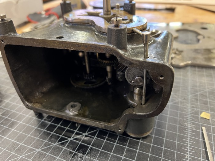

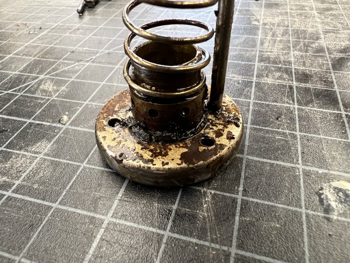

My external piping, and how I removed it. There is a fair bit of crusty stuff all over the bottom of the pump, but it cleans up easily enough. I’ll either use some Teflon pipe dope or a drop of blue loctite to help seal the threads upon reassembly.
The leather washer seems supple and undamaged, most likely whatever oil was used did not acidify terribly as it oxidized with age.

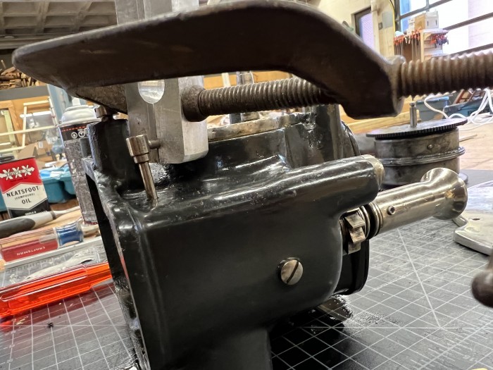

to anyone wondering whether they have enough oil in the motor, if you remove the chromed top plate, it reveals the spot where the oil goes when it is pumped up from the sump. winding the crank will cause oil to squirt out if all is functioning properly. if oil does not come out, you either have a damaged pump, clogged pipe, or not enough oil.

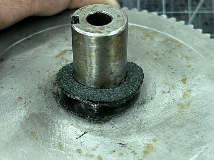

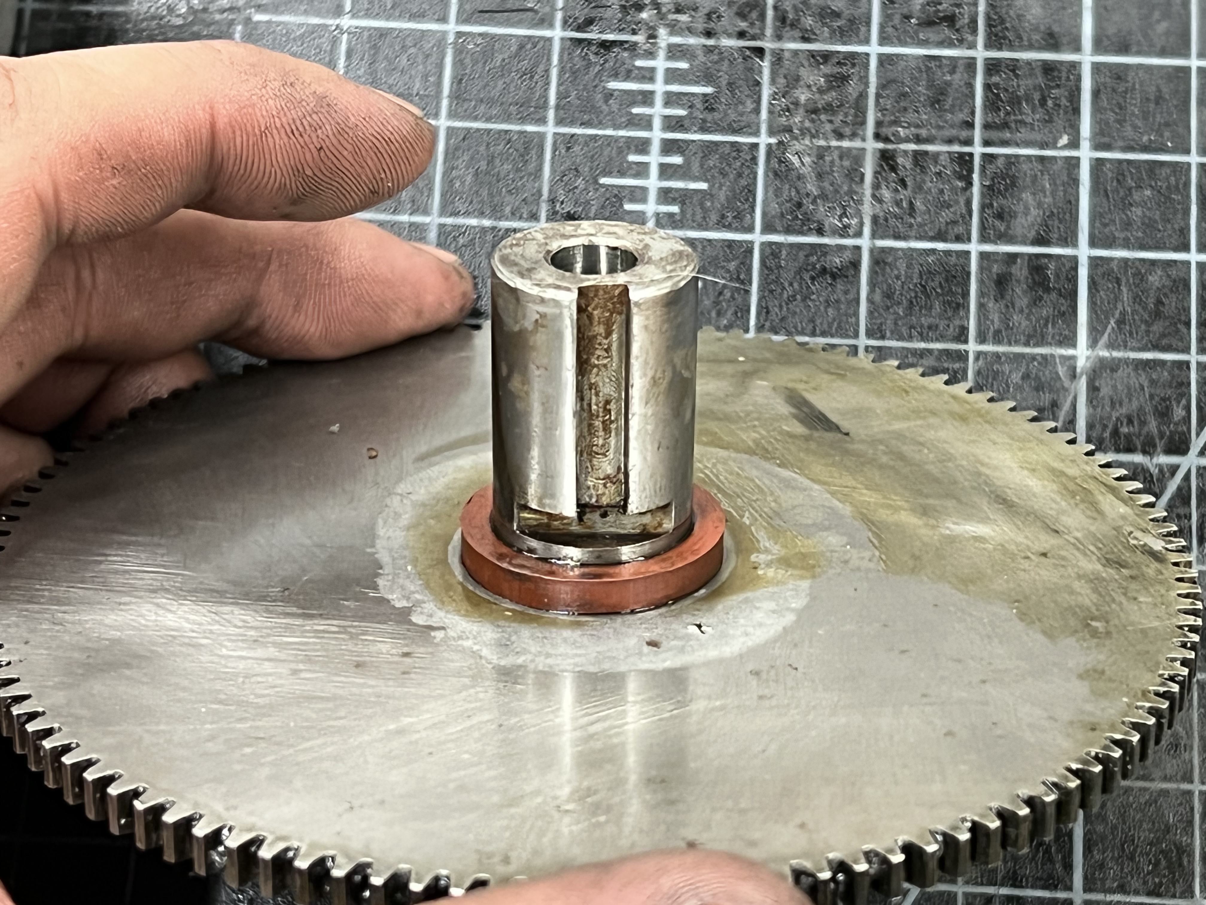

I’ve got everything cleaned up nicely, and found two more things that probably need attention. These are the washers either side of the mainspring barrel, between the barrel and the two gears on the bottom there looks to be a square rubber washer, but it is hard as a rock. If you recommend leaving it, I will likely do so, but it should be easy enough to source a new buna-n oil resistant washer of the appropriate size.
The top side gasket has four layers of felt, two between the gear and a little metal cup, and two more in the cup.
Do you (or anyone else have opinions about how hard the rubber washer should be, and also about the density of the felt used on the upper washers? I can source good quality wool felt in various densities/hardnesses from a local industrial supply. Cutting it to size is a trivial job using a laser cutter, so I can happily make some to share with others when I make mine. I’m wondering if all of the layers of felt are actually supposed to be in the cup/ring. I am definitely not the first person to have ever opened this motor, so I’m not sure how they were intended to be installed originally - I can only go off of how they were placed when I took this bit of the spring barrel apart.

Jon, As you say, one tends to find many different situations when opening one of these motors due to varying opinions as to how things should be done ! The bottom spring barrel washer is usually made from hard (fibre) material due to it needing to be used in a thrust capacity. There is sometimes also a slip ring (or two) incorporated. The top one(s) are there mainly to try to stop ingress of oil which can leach out spring grease if present in too great a quantity.
