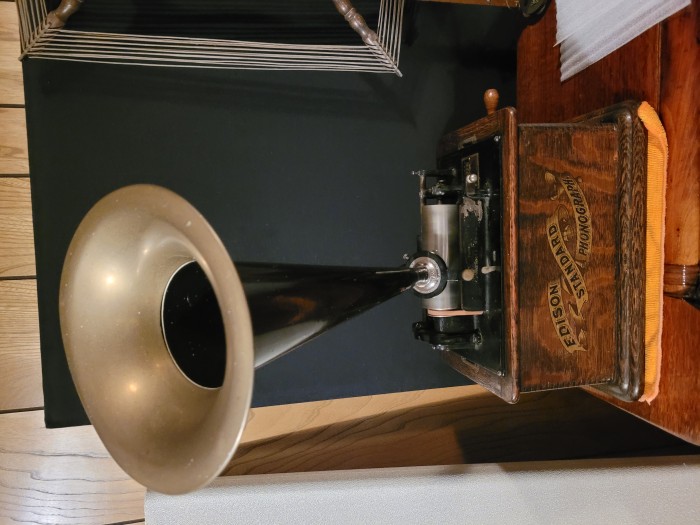

OK, here it is, cleaned, oiled, adjusted a bit, and with new belt: https://photos.app.goo.gl/8SB6jS2rmw9L5deg6 (video is too big to upload to the forum directly, sorry, but it should be public).
- Lucius1958
- Posts: 4069
Re: Edison Standard Model B
Speed seems to be a little inconsistent...
- Bill
- Bill
- Posts: 19
- Joined: Tue Aug 31, 2021 9:58 pm
I only have 1 cylinder to check play with unfortunately, so not sure if it is supposed to be like that at 1:17 or it is slowing down. Everything is smooth, lead screw is clean, it takes exactly a minute to run between two timing notches. So I'm not sure what would cause this if in fact it slows down in one spot.
