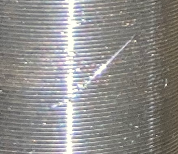

Well I took it off anyway and took some photos. If anything looks worn or out of place please notify me!

"Well I took it off anyway and took some photos. If anything looks worn or out of place please notify me!"
The half nut bar and half nut appear to be fine although the threads in the half nut do appear very shallow.

Nicks in the lead screw can cause skipping. Look very closely at the ½ nut as it passes over these spots. See if the nut lifts slightly and skips in these areas.
