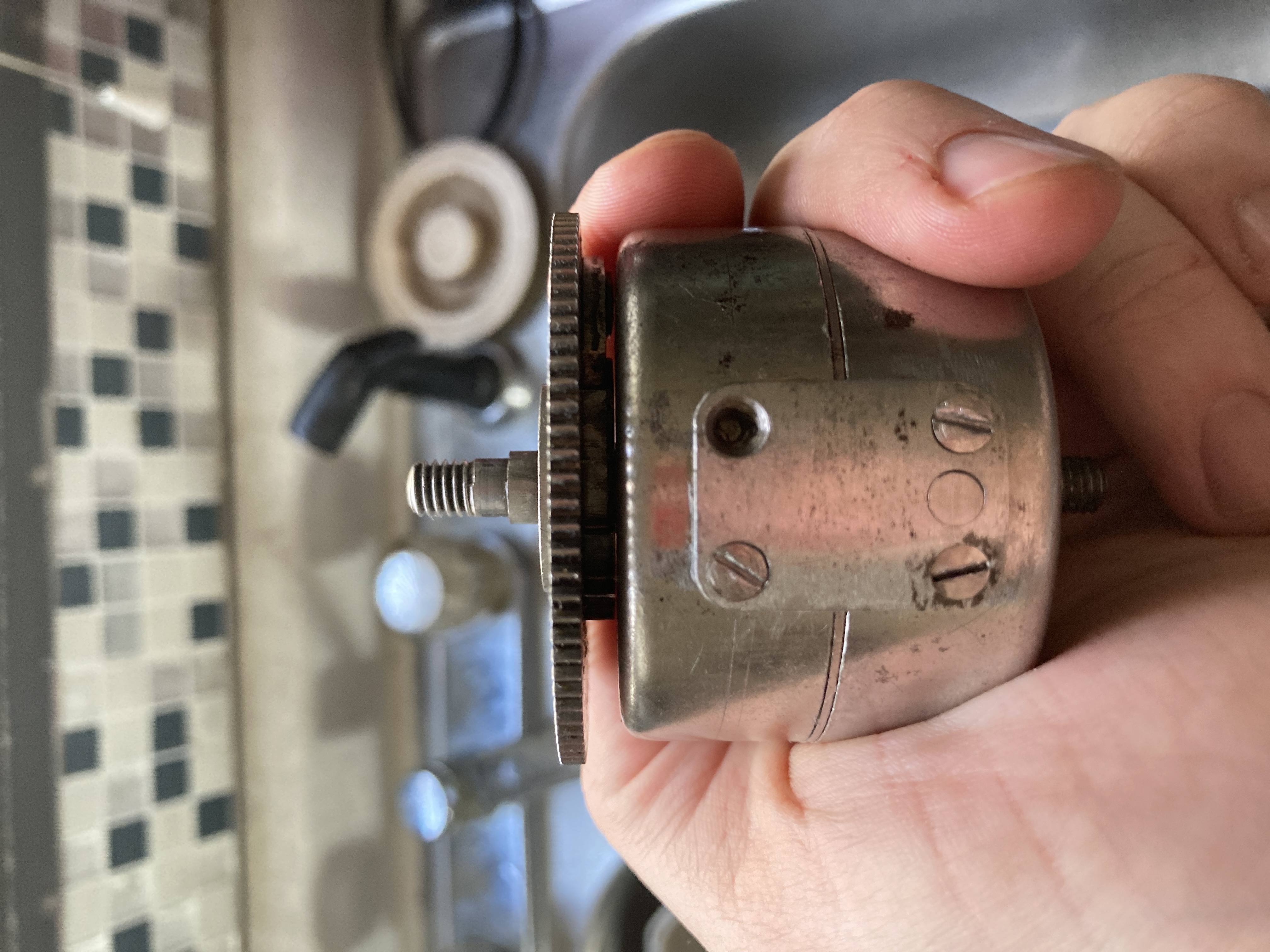

Ok now I’m seeing what I’m doing wrong. I gotta assemble the gear part FIRST after I secure the spring barrel (I tried other screws and they won’t secure down either in that hole). I misread its the Feedscrew GEAR that comes first! Not the feedscrew itself!

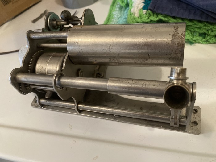

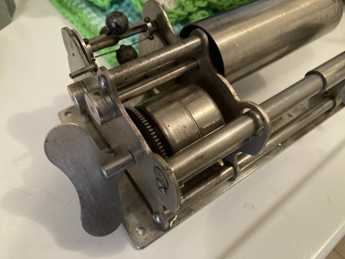

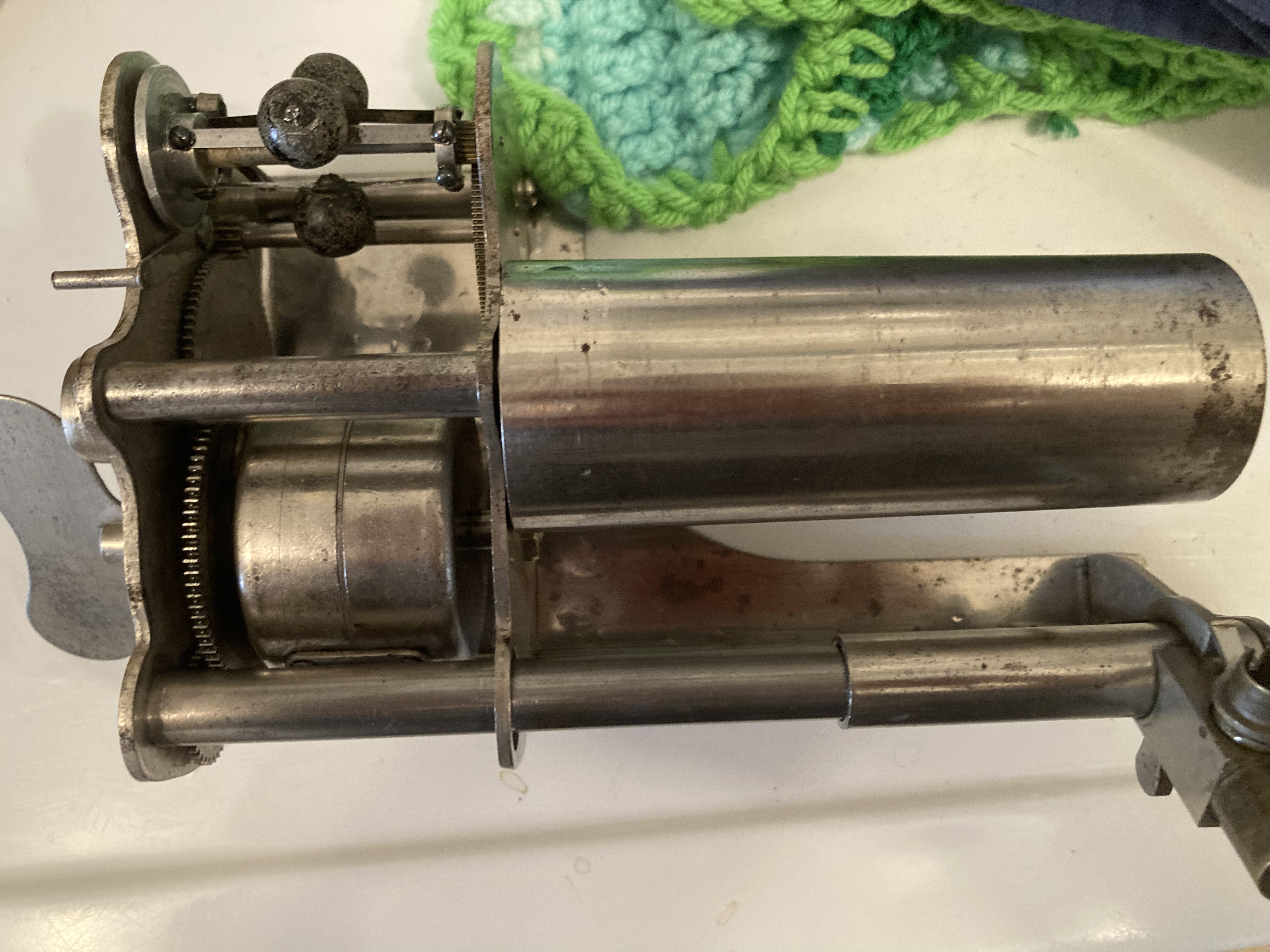

Ok! PHEW! it’s all together!!
After a great deal of fussin’ n cussin…the mechanism is all together and running!

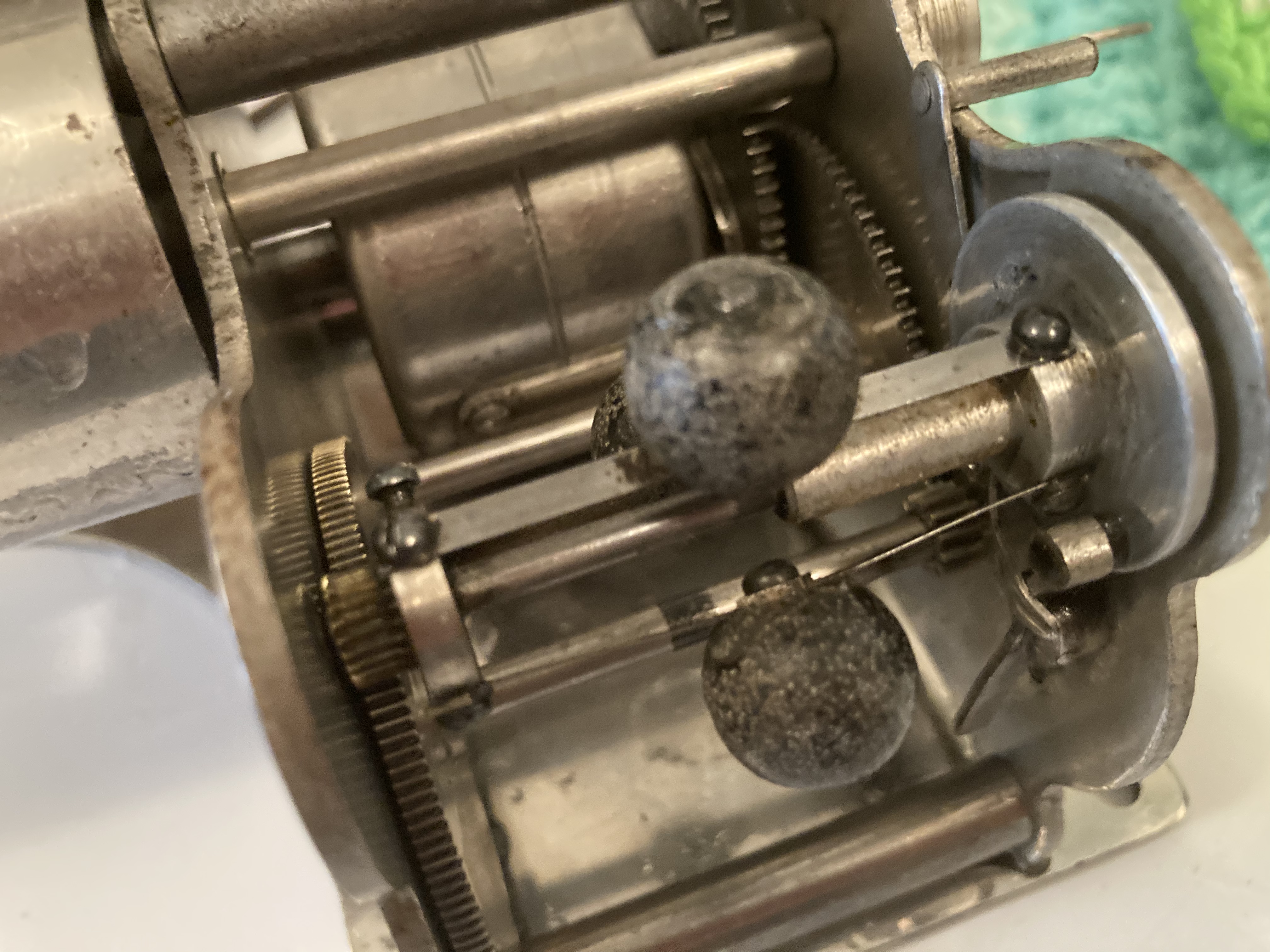

The only issue I see now is the brake leather has hardened and it slows down the governor but not totally pausing the governor.
Like I said there are spots where the Nickel finish had worn off. This was quite a well loved machine and was someone’s very first machine in the late 1890s.
I’m gonna go take a nap now.

Andy, a drop of oil on that governor pad will soften it up and improve its performance.
