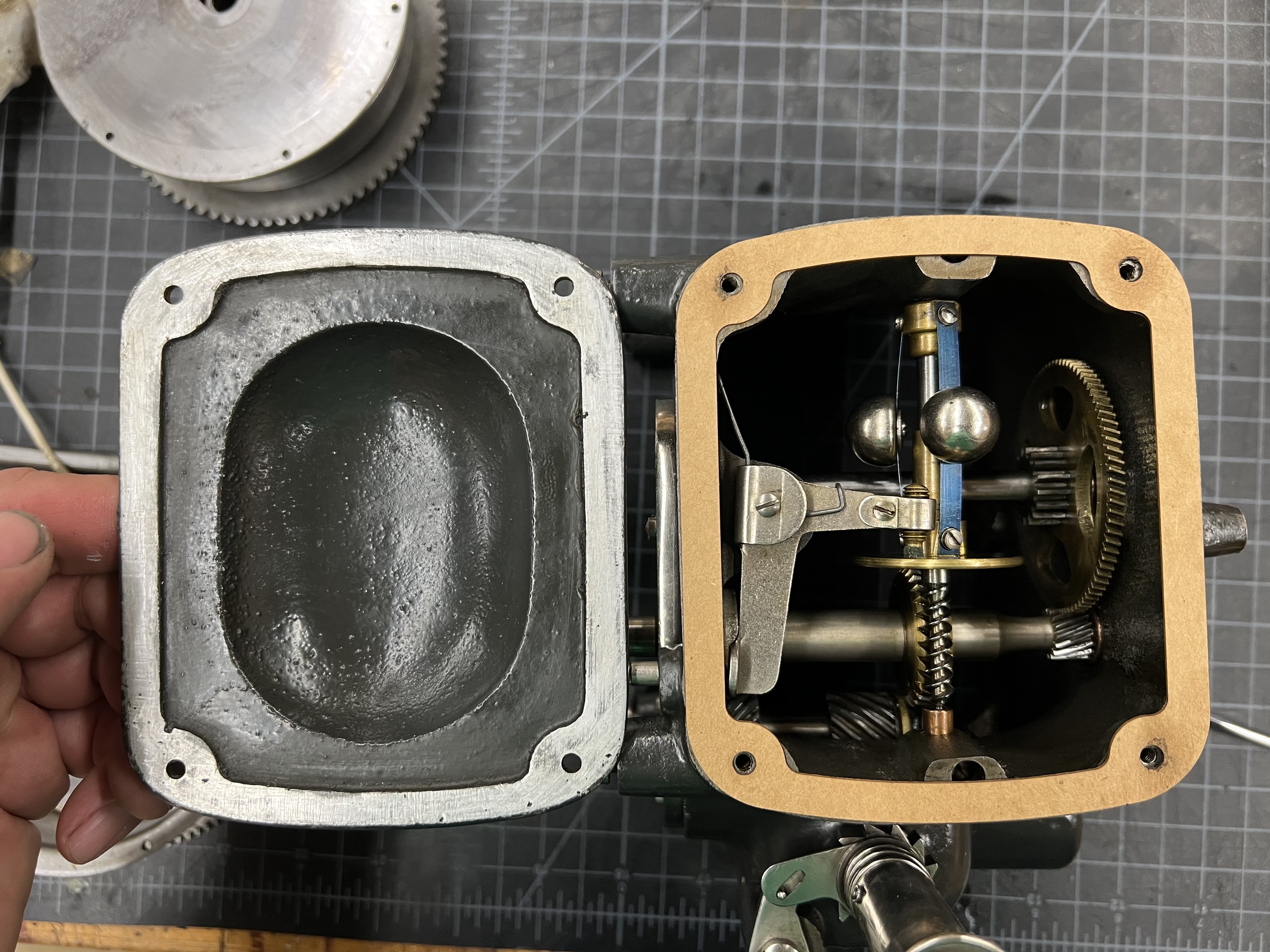

Did the end bells ever have gaskets of some sort on them? I can’t see how these would be expected to seal properly, though the way the main casting is formed, perhaps when the machine is perfectly level, all the oil flows back to the sump. There’s a small lip on the lower right side closer to the sump, which ought to catch the oil.
The top plate could not have a gasket and keep shaft end play where it ought to be, though due to the helical gears, the all important main shaft on which the turntable/platter is placed pulls down when in motion. Oil leaking from the top plate ought not to be any more of a problem than oil leaking from the hole through which the oil pipe exits the casting. The motor is not intended to be played upside down anyway.
I’m going to make some cork or paper gaskets for the end bells, and if anyone feels the need to have gaskets, I can send you the files I will use to cut them on a laser cutter.

Test cut worked pretty well. Just enough slop in the holes so that if someone else’s motor has slightly different hole spacing, that they should still work. I’ve also got the other side cover, and will be making one for the oil pump.
If anyone wants gaskets, I can send a CAD file and you can use to have them laser cut from the material of your choice. Probably could cut a set and send them for the cost of postage and materials

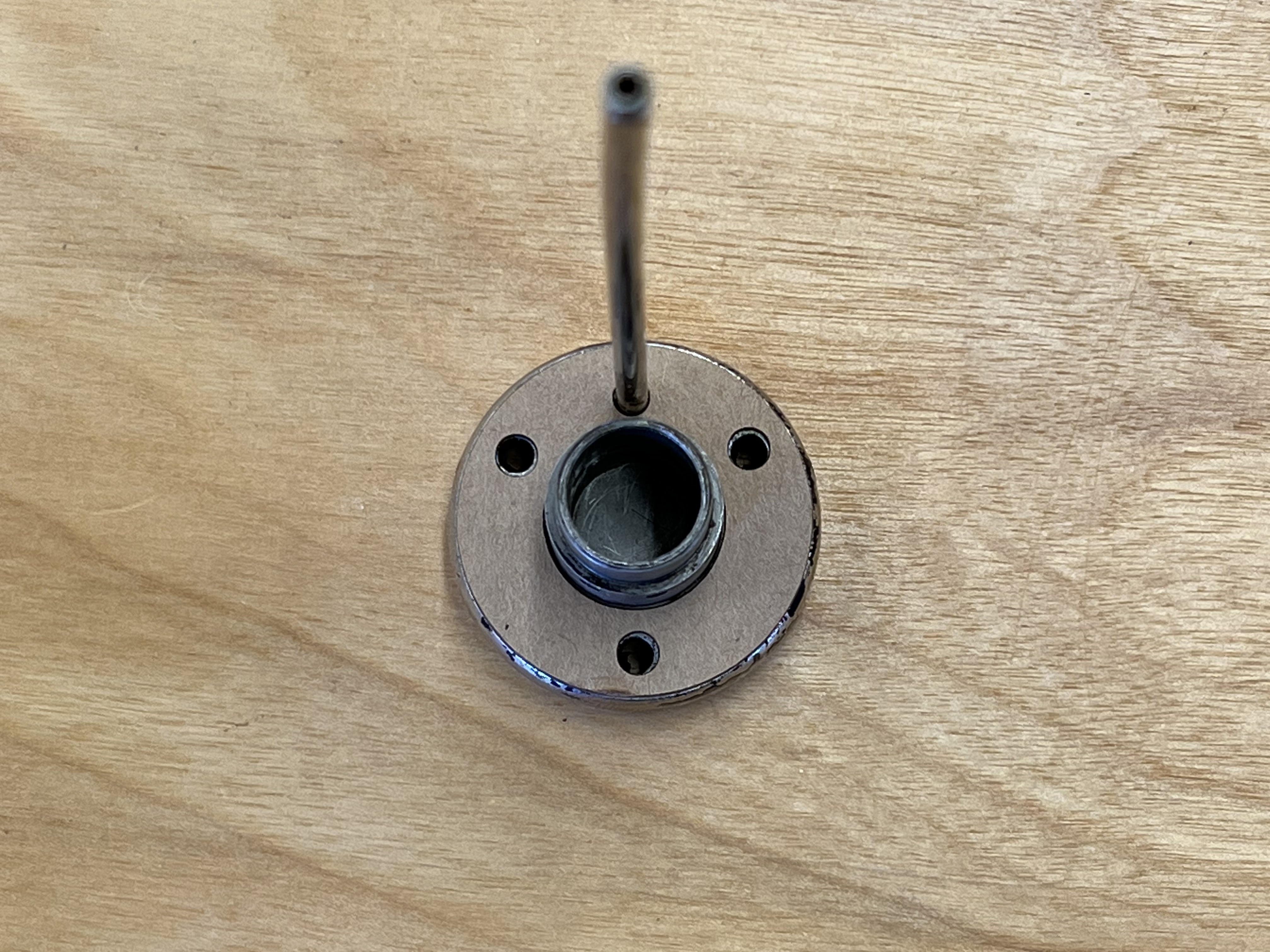

I’m getting back to putting my garrard super in order, and wanted to share a picture of the gasket I made for the bottom of the oil pump:
Due to the great kindness of three of our fellow forum members, I now have in my possession a 12” platter, a winding crank, and a new rubber oil pump plunger gasket.
I made the gasket for the bottom of the oil pump using 0.5mm Kraft paper (known here in the states as “chip board”) laser cut and dipped in shellac to make it oil tight. I can’t see how the original metal on metal seal would have kept oil from leaking out, so thought a thin gasket here was in order. I didn’t have any proper gasket paper on hand, so this will be the next best thing. I’ve also done end bell gaskets, and need to dip those in shellac before I assemble everything after I get the new springs in.
If anyone is in need of paper gaskets for one of these, I’d be happy to provide them for the price of postage. I have a somewhat endless supply of this thick Kraft paper. Other possible materials are buna-n rubber, rubber cork gasket, and automotive type fiber gasket material. I may try thin rubber-cork material if I can find any. Too thick on the oil pump base gasket, and it would throw off the placement of the upper oil tube on the motors with the external oil tube.
