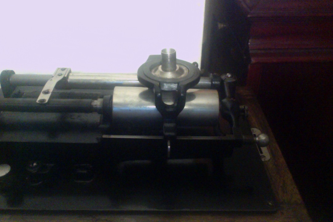

AmberolaAndy wrote: Wed Jun 08, 2022 10:03 pm Ok another thing I noticed, is the half nut supposed to look like this or is something missing that goes on the half nut and spring to adjust the tracking?
The half nut bar on my Triumph looks much like that, except it has a little dogleg to it, instead of being straight.
- Bill
Is the “dogleg” the part I circled in the other photo?
No. See the picture I included below for an example of the Triumph "offset" half nut bar. They're far less common than conventional Triumph half nut bars.
Doug

AmberolaAndy
Posts: 2746
Re: How do I put a brake on a Triumph? 😳
Post by AmberolaAndy »
FellowCollector wrote: Thu Jun 09, 2022 6:12 am
AmberolaAndy wrote: Wed Jun 08, 2022 11:11 pm
Lucius1958 wrote: Wed Jun 08, 2022 10:56 pm
- Bill
Doug
So my Triumph spring and half nut are supposed to be like that?
Which of the four screws do I adjust for the tracking?
Posts: 6824
"So my Triumph spring and half nut are supposed to be like that?"
No. What you have looks correct.
Why do you want to adjust the ½ nut tracking? Does it skip while playing? How would even know if it does, since you can't play it with your current brake/speed control issue?
AmberolaAndy
Posts: 2746
JerryVan wrote: Thu Jun 09, 2022 12:18 pm "So my Triumph spring and half nut are supposed to be like that?"
Just in case if it has to be done afterwards. I’m nervous I’m gonna damage something else (especially the tracking bar) while fixing the speed control /brake issue. Maybe I’m overthinking it. I need to set the machine aside until I order and get that part. Take it one at a time…😅
No: the bar has a little jog to one side, before straightening out again.
- Bill
AmberolaAndy
Posts: 2746
Lucius1958 wrote: Thu Jun 09, 2022 9:24 pm
- Bill
My half nut is a straight as an arrow

gramophoneshane
Posts: 3463
Post by gramophoneshane »
Is it possible someone somehow may have wedged that mystery nut in, either under the yoke or the spring, to make the repro yoke work as it should?
If so, it wouldn't be a permanent solution obviously but it may at least make the machine usable until a replacement yoke can be found.
AmberolaAndy
Posts: 2746
gramophoneshane wrote: Fri Jun 10, 2022 3:08 am Is it possible someone somehow may have wedged that mystery nut in, either under the yoke or the spring, to make the repro yoke work as it should?
Well I’m proud to say I got that replacement YOKE (I’ve been spelling it wrong) ordered! Hopefully that fixes one of many things going wrong on me. 😅
