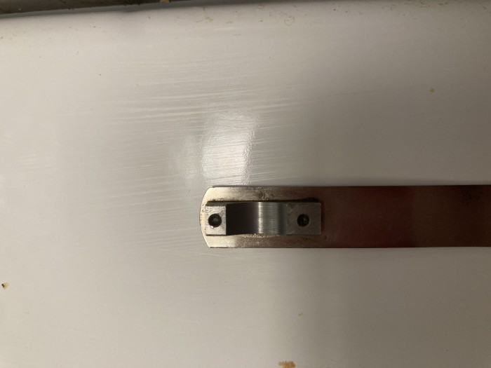

FellowCollector wrote: Sat Jun 18, 2022 6:51 pm "Well I took it off anyway and took some photos. If anything looks worn or out of place please notify me!"
The half nut bar and half nut appear to be fine although the threads in the half nut do appear very shallow.

Maybe I missed someone else suggesting this earlier... however it has been my experience that you have to loosens the two screws that hold the half nut to the spring, lower the carriage and let the half nut engage the feedscrew, then tighten the screws. Sometime the half nut gets out of alignment and this re-aligns it. It has often fixed issues like this for me.

You could remove the half-nut, place it onto the feed screw threads and "feel" if it mates to the threads fully. It should seat fully with no appreciable slop. Then, when you reinstall it on the bar, be sure the half-nut is seated firmly on the feed screw threads while tightening the 2 mounting screws.
I wonder now if it's possible that the half-nut was mounted 180° out of position, and if that might be the trouble. Without placing it on the feedscrew to check whether the threads are in proper mating position it's impossible to analyze the threads condition.

zonophpones7 wrote: Wed Jun 22, 2022 7:45 am Maybe I missed someone else suggesting this earlier... however it has been my experience that you have to loosens the two screws that hold the half nut to the spring, lower the carriage and let the half nut engage the feedscrew, then tighten the screws. Sometime the half nut gets out of alignment and this re-aligns it. It has often fixed issues like this for me.
I read that the longer half faces the back, and the shorter half faces the front and that’s how it looks here.

Hi Andy, the point here is to check if the half-nut threads seat on the feed screw threads, or if one or both are worn to the point they need replacing. These threads are (iirc) directionally cut (called buttress thread) so they mate in a very specific manner. The thread "buttress" provides a stronger "push", if you will, to the half-nut in the direction of play.

fran604g wrote: Wed Jun 22, 2022 11:19 am Hi Andy, the point here is to check if the half-nut threads seat on the feed screw threads, or if one or both are worn to the point they need replacing. These threads are (iirc) directionally cut (called buttress thread) so they mate in a very specific manner. The thread "buttress" provides a stronger "push", if you will, to the half-nut in the direction of play.
I have it soaking in PB Blaster, but the screws holding the halfnut is on Victrola no.2 screws level of stubborn at the moment.
