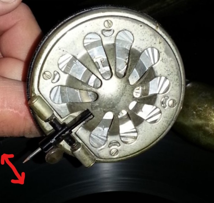

OddRomanian wrote: Sun Oct 20, 2024 8:15 am ...I don't quite get what you mean with "pumping" the needle, if you mean inserting and then removing the needle at a pace, no, the diaphragm doesn't move. Is that what It is?
It sound like the records are okay. By "pump" I meant grab the end of the inserted needle and GENTLY move it back and forth in the direction required to play the record.
There should be a perceptible/tiny movement of the diaphragm.

OrthoFan wrote: Sun Oct 20, 2024 11:02 am
OrthoFan
Just tried It and I am almost certain there is absolutely 0 movement and that the whole needle bar assembly is stiff as stiff can be.

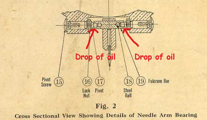

OddRomanian wrote: Sun Oct 20, 2024 11:19 am
(Sorry about my grip, It is as strong as that of a geriatric armless creature and the whole soundbox is moving in my hand, either way I think the lack of movement by the diaphragm itself is noticeable)
Thank you for taking the time to help me! : )
Your more than welcome. I'd try putting a few drops of very light weight penetrating oil--or even WD 40--on the pivot joings to see if that helps.
There should be some slight "flexing" of the diaphragm when inserting a fresh needle and tightening the thumbscrew. If that doesn't improve the flexibility, then a slight adjustment of the needlebar's tension would be needed. Again, one of the members can probably walk you through the steps better than I can.
I also agree, as "Sidewinder" noted, a short video of a record playing would be helpful.

OrthoFan wrote: Sun Oct 20, 2024 1:17 pm
