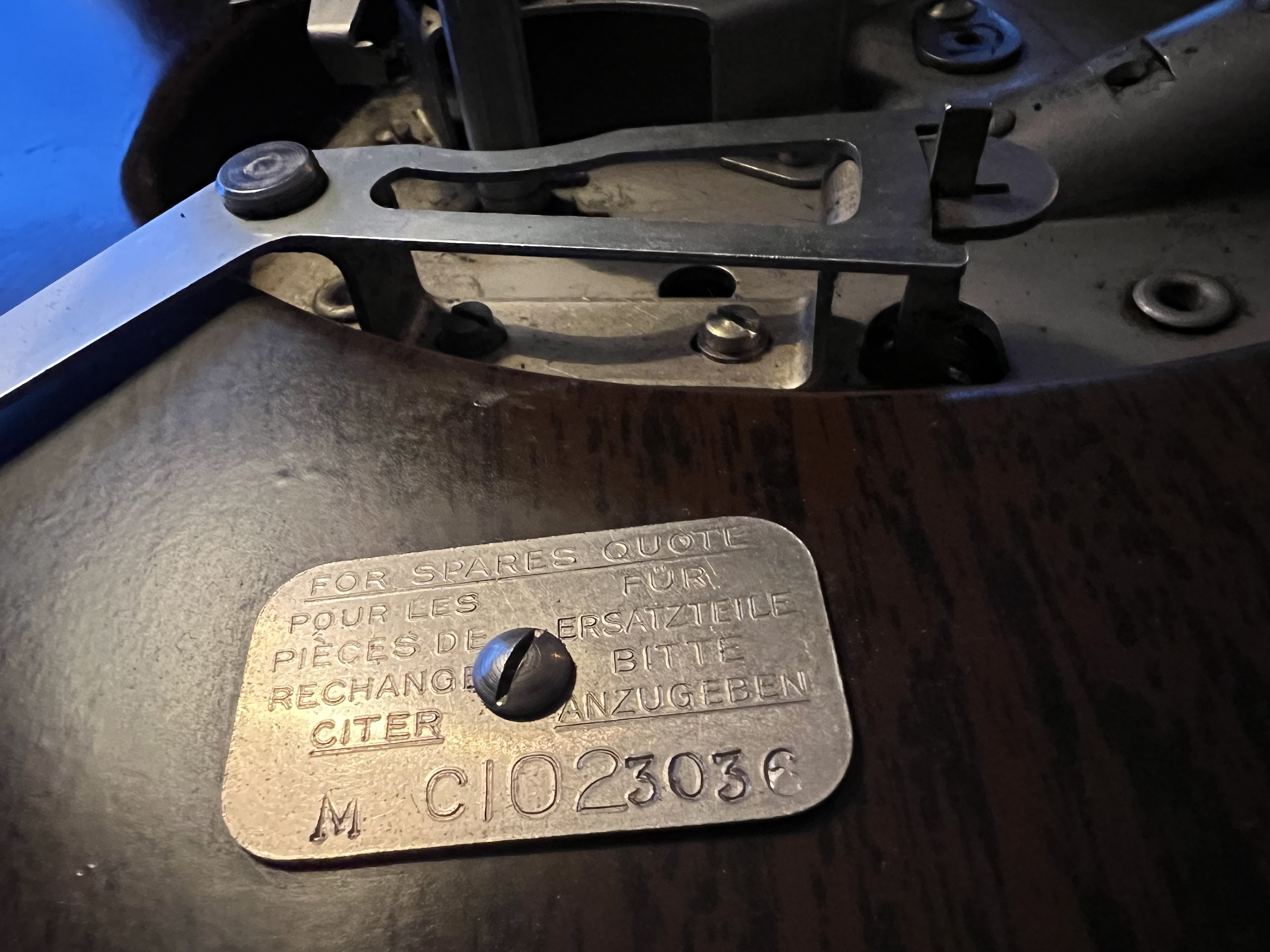

I have a french early 102
Posts: 5753
Re: HMV 102 production numbers
I have an early Electrola 102 with no stamped serial number, just something illegible in pencil :
Oedipus
Posts: 343
Joined: Sat Oct 13, 2018 7:59 am
Post by Oedipus »
Thank you both - further confirmation that the metal plaques continued for export models after they ceased in the UK (probably in 1930, before the 102 was introduced). But this is the first time I have seen a serial number stamped on such a plaque; the theory behind them was that they didn't need serial numbers because any slight change in the specification (affecting spare parts supply) was indicated by a suffix letter. I have seen serial numbers as well, on occasion, but on a separate label.
Neither of these has a suffix letter because they were the earliest version of the 102. When the factory started fitting the No 6 auto brake in place of the No.5, the model became '102A'.

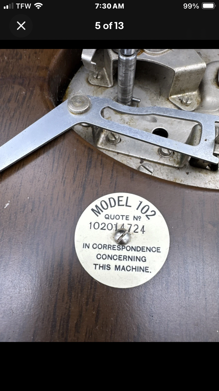

Yesterday I purchased 102 #14724 from eBay. I believe this is the first generation model from 1931 from what I am reading?
Oedipus
Posts: 343
Post by Oedipus »
Yes, that is the first type of 102, with the Universal Automatic brake.
