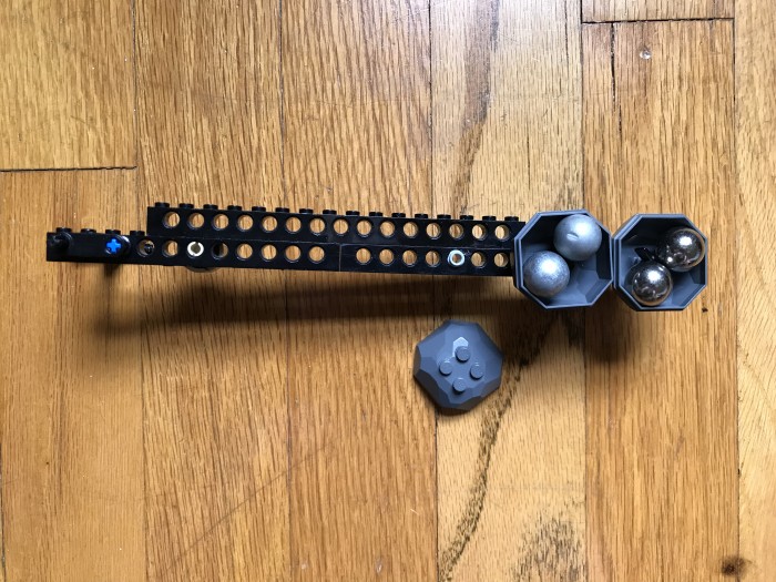

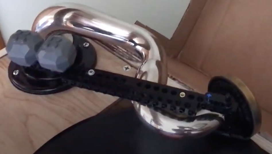

Now, please explain how you made your counterbalance for the reproducer, it looks quite interesting...

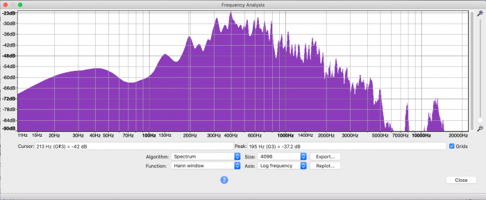

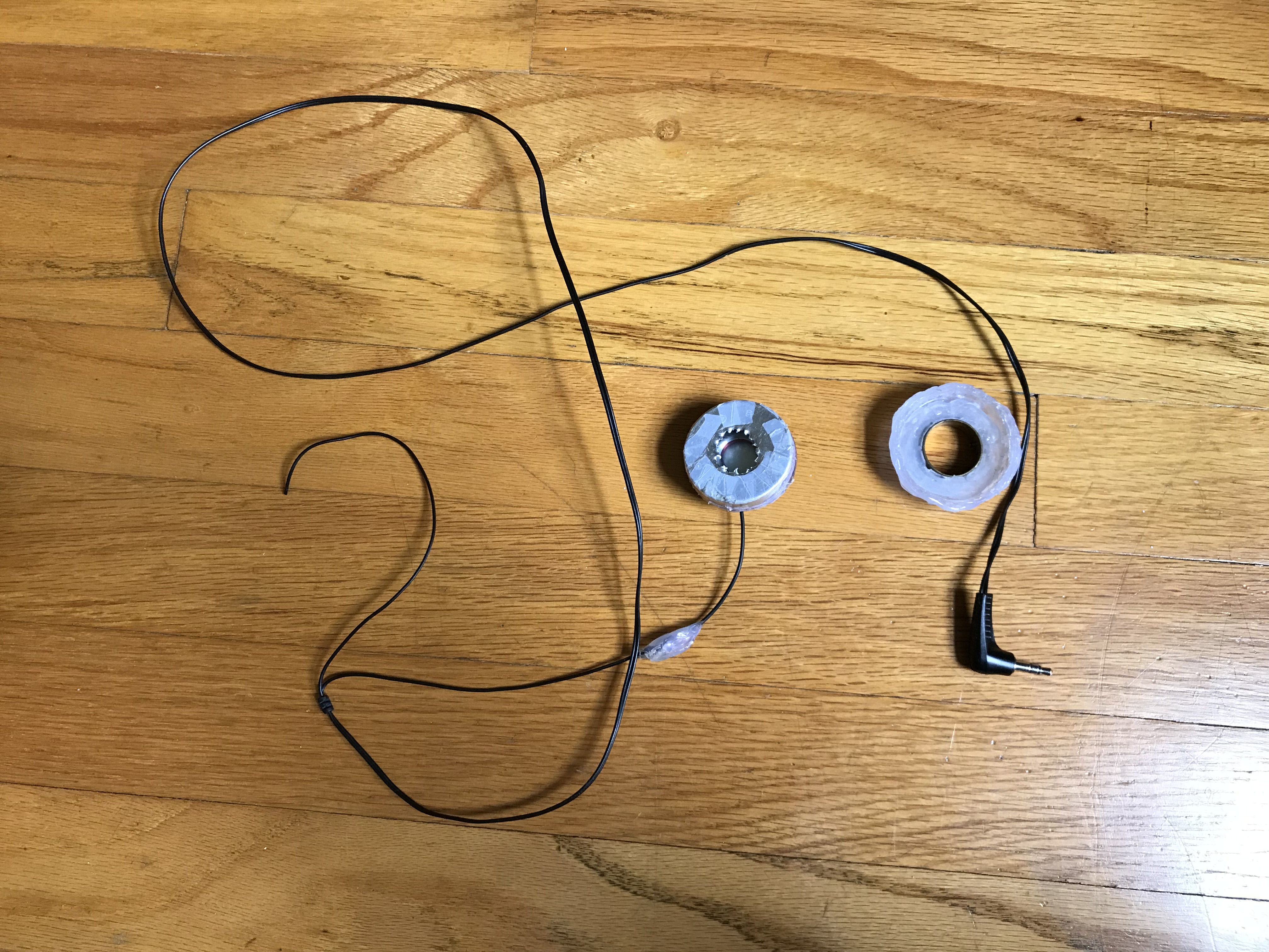

I am curious about how you setup to do the "sweep" you mention in the following sentence:
"The bass doesn’t go all the way down to 100 Hz.; on electrical records, there isn’t much
below about 130 Hz., and using an electric speaker in place of the soundbox, a sweep
from 10,000 to 0.1 Hz. shows a low cut-off around 156 Hz., but possibly peaks that might
be audible below that."
Thank you.
Thank you.

Thank you, everyone! I haven't any prior experience with large-horn talking machines, so it is very encouraging and informative to read your opinions of the horn's sound quality.
As emgcr noted, the bass does seem to be rather lacking considering the theoretical 100 Hz. cut-off; after adding a few more layers to the neck, the typical frequency content for a late-’20s Victor record is as pictured below—roughly equivalent peaks at 130 and193 Hz., large peak from around 300 to 1700 Hz., and high cut-off around 5000 Hz. I presume that the peaks around 8000 and 10,800 Hz. are mostly surface noise, and the peak at 50 Hz. may be in the recording, but is probably from the environment. I know that the recording levels are supposed to decrease gradually as frequency decreases, to prevent bass grooves from running into each other, but this response looks more erratic than I would have expected for the recording system, so I presume that the fault is in the reproduction.
Based on its dimensions, I’m guessing that the horn’s lower cut-off should be somewhere around the cut-off of the Mk IX or X; does anyone know roughly what their frequency responses typically are?
Odd reflections are probably inevitable in my room; it has an angled ceiling on two opposing walls, and the only place with the standard right-angle ceiling is a five-by-six-foot niche with a window in the back on one wall, there probably isn’t a truly ideal place for such a large horn—still, trying different arrangements would be a good idea; small rooms can have a significant impact on the sound quality of large horns.

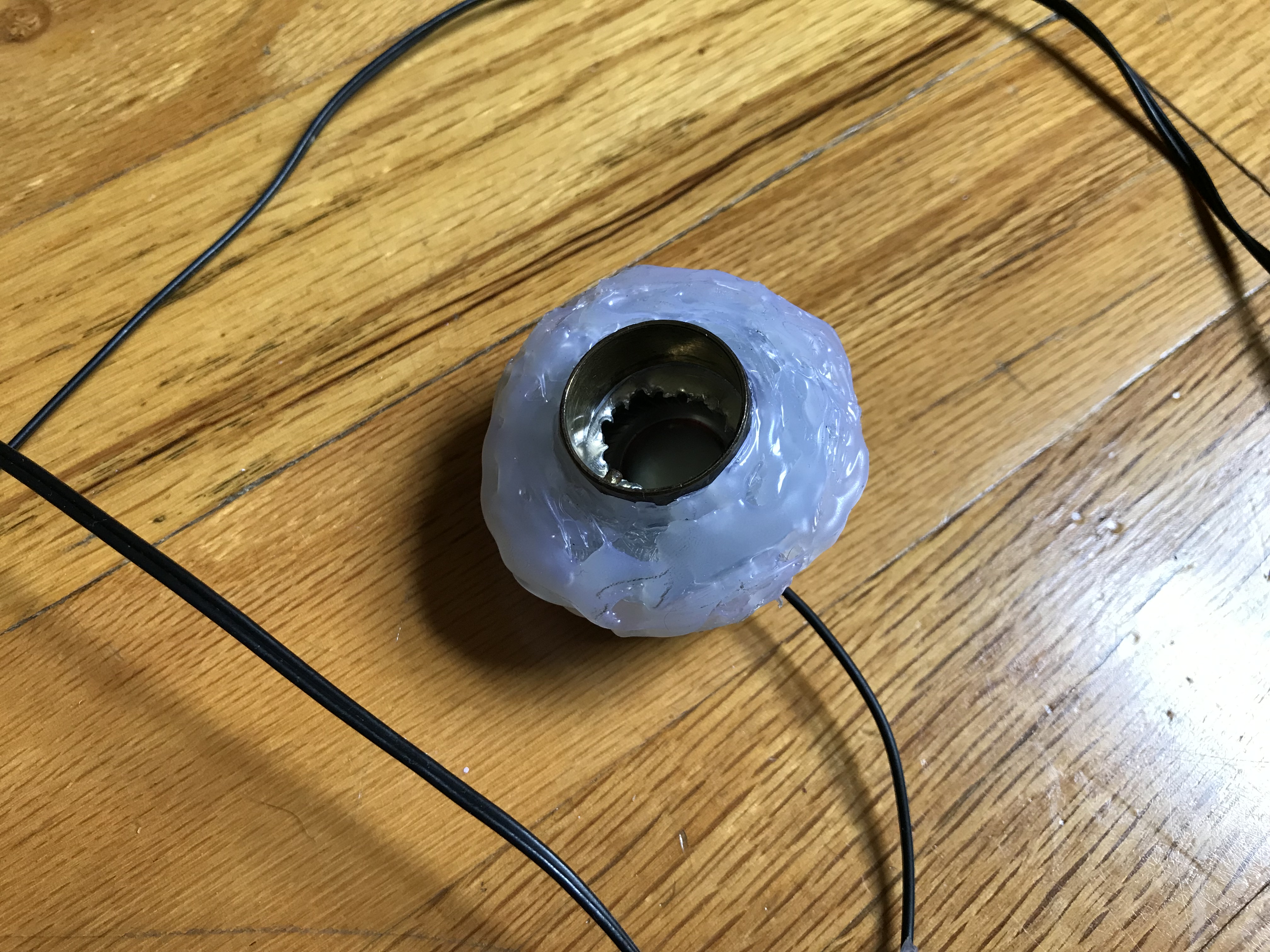

For the sweep, I adapted a speaker from a pair of headphones by removing the plastic grille, adding a metal enclosure, and fastening the metal insert from a petrified Orthophonic soundbox isolator; then I just plugged it into a cell phone, used an online sweep generator to produce the sound, and recorded it with the Audacity audio workstation software on my computer. It isn’t a perfect test—a real horn driver, or better yet, the constant tone/gliding tone records made by Victor, HMV, and Decca would be better, especially as they would test the response of the whole instrument, instead of just the horn—but it at least gives a general idea of the frequency response.
Thank you!--And good luck with your horn project; it sounds very interesting!TN Allen wrote: Sat Aug 07, 2021 2:10 pm Congratulations Ethan on a wonderful project. It is a remarkable achievement, and you have been generous in sharing so much of it.

"For the sweep, I adapted a speaker from a pair of headphones by removing the plastic grille, adding a metal enclosure, and fastening the metal insert from a petrified Orthophonic soundbox isolator; then I just plugged it into a cell phone, used an online sweep generator to produce the sound, and recorded it with the Audacity audio workstation software on my computer. It isn’t a perfect test—a real horn driver, or better yet, the constant tone/gliding tone records made by Victor, HMV, and Decca would be better, especially as they would test the response of the whole instrument, instead of just the horn—but it at least gives a general idea of the frequency response."
That is a very clever and resourceful solution!
Testing the reproducer in place playing a recording similar to the Holm Impulse sweep would be great, but finding a source to make it accurately is probably all but impossible.
Alternatively, I've wondered about a mechanical link between a small full range speaker and the needle, which might carefully be played to vibrate the needle. Properly positioned, the vibrations might simulate the needle vibration in a record. A wire looped and glued at the intersection of the surround and cone or dome surface might be a start. The other end of the wire would then connect with and vibrate the needle.
A large exponential horn does interest me, however, I may not build it as I already have far too many unfinished projects that may well outlive me.

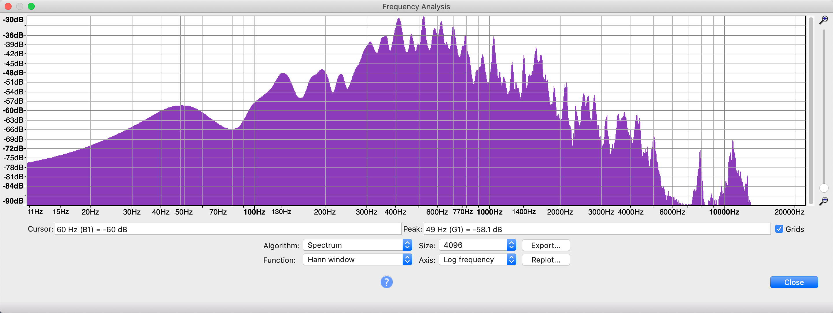

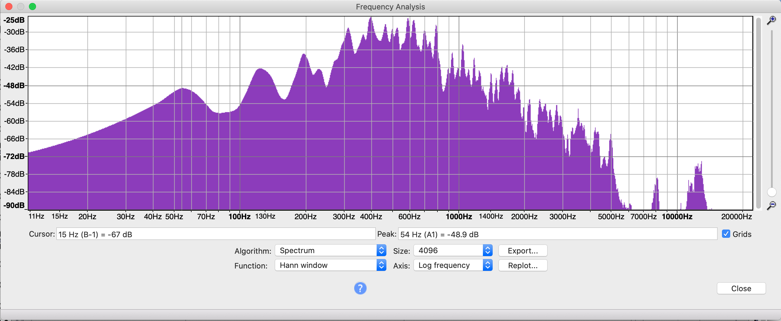

The Ediphonic certainly does sound good! A crane might work for my horn; the current cabinet is heavy enough to hold it up, and the non-experimental cabinet will be slightly larger, made from ¾” plywood instead of ½”, and lidded, so it should be heavy enough to hold the horn and a crane. If the wood keel doesn’t turn out well, I may try one; in addition to taking stress off the neck, it would probably take stress off the glued joints between the horn and the wood mounting rings.
Using a speaker to drive the soundbox might work; it reminds me of a device that (I believe) was sold in the ’20s—it used the electrical signal from a radio to vibrate the needle in the soundbox, so one could listen to the radio through a phonograph’s horn.
I did some more not-very-scientific frequency response tests over the past few days, and after adding three layers overlapped halfway (six sheets) to the horn and one layer overlapped two-thirds (three sheets) to the internal conduit, there seems to be a slight improvement in bass; measuring the frequency content of the same record, the 130 Hz. peak has dropped to 125 Hz. and increased in amplitude—hopefully a sign that the increasing thickness is preventing low frequencies from passing through the horn walls. I’ll be adding more layers over the next few days, so it will be interesting to see—and, more importantly, hear—whether the trend continues.
