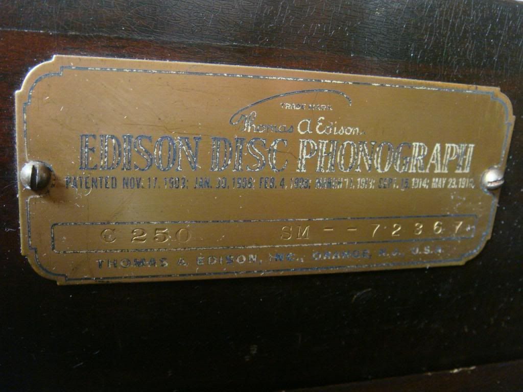

George, As you requested... I've seen quite a few of these Later C-250 dataplates..They are considered "Transitional" C-250's as some of the very last batches C250's came with slots instead of drawers before it was re-named to the C-19 name. They are seldom seen, but are out there..I've come across 4 of these type machines in the last 3 years believe it or not.. See the weblink for the pic below. I have pics of others like this..I will have to dig them out.. for those that have never seen one.
I am having trouble posting pics to the message board now as it says I am limited to 800 pixels??? How do I get around this? That's why I included the direct weblink below. If someone knows how to add the picture now, Please add it to this thread.

Thanks for the photo of the late C-250 data plate! It's the second one I've seen today...my friend Fran showed me a photo of one that was on eBay recently. So after 46 years of collecting, today I saw my first two! :)
But as to your assertion that the earlier aluminum & black data plates were phased out in 1917, that would suggest that the data plate you pictured was in production for two years (1917-1919). Given the relative scarcity of this late C-250 data plate, that seems unlikely. Where did you get these dates? I have not seen them in Frow, but perhaps I missed them. A page number would be great.

Hi folks,
I now have two examples of transitional data plates for the C250/19.
One that I found on ebay:
And the one provided by Tony K.:
I also add that the data plates appear to be stamped aluminum for both the 250 and the 19, as opposed to aluminum for the 250 and brass for the 19 as stated in a previous post. It is also interesting to note that the white lettering seems to yield to black with wear.

FloridaClay wrote:Wondering (without knowing) if the reason that there is black underneath the white is that the white might really be remnants of polish?
Clay
Hi Clay,
I don't think so. Many of the C-19 data plates that I have observed, appear to actually be white lettering with a black outline, that might suggest that the lettering may have actually been two tone with the white being the first of the two colors to wear off. That being said, the above examples appear to be the reverse of this; white outline with black field lettering. Of course, it's too early in my research to make a definitive conclusion.
