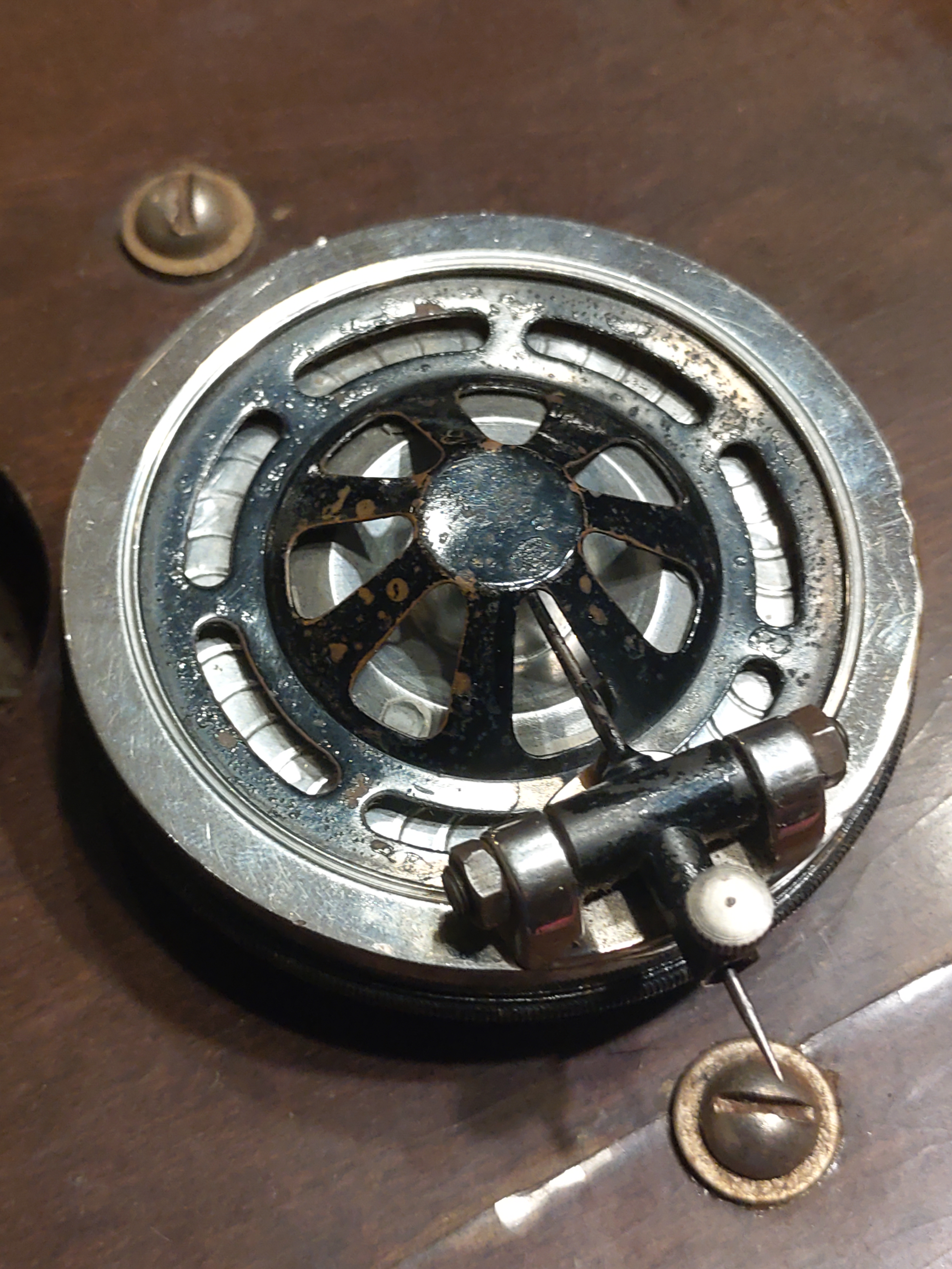

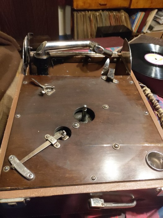

I have a 202 with a polished wood motor board & red plush turntable, No. 9 soundbox. It still has a serial number inside it on a paper tag.
(My only Orthophonic-style machine--that thing sounds great!)

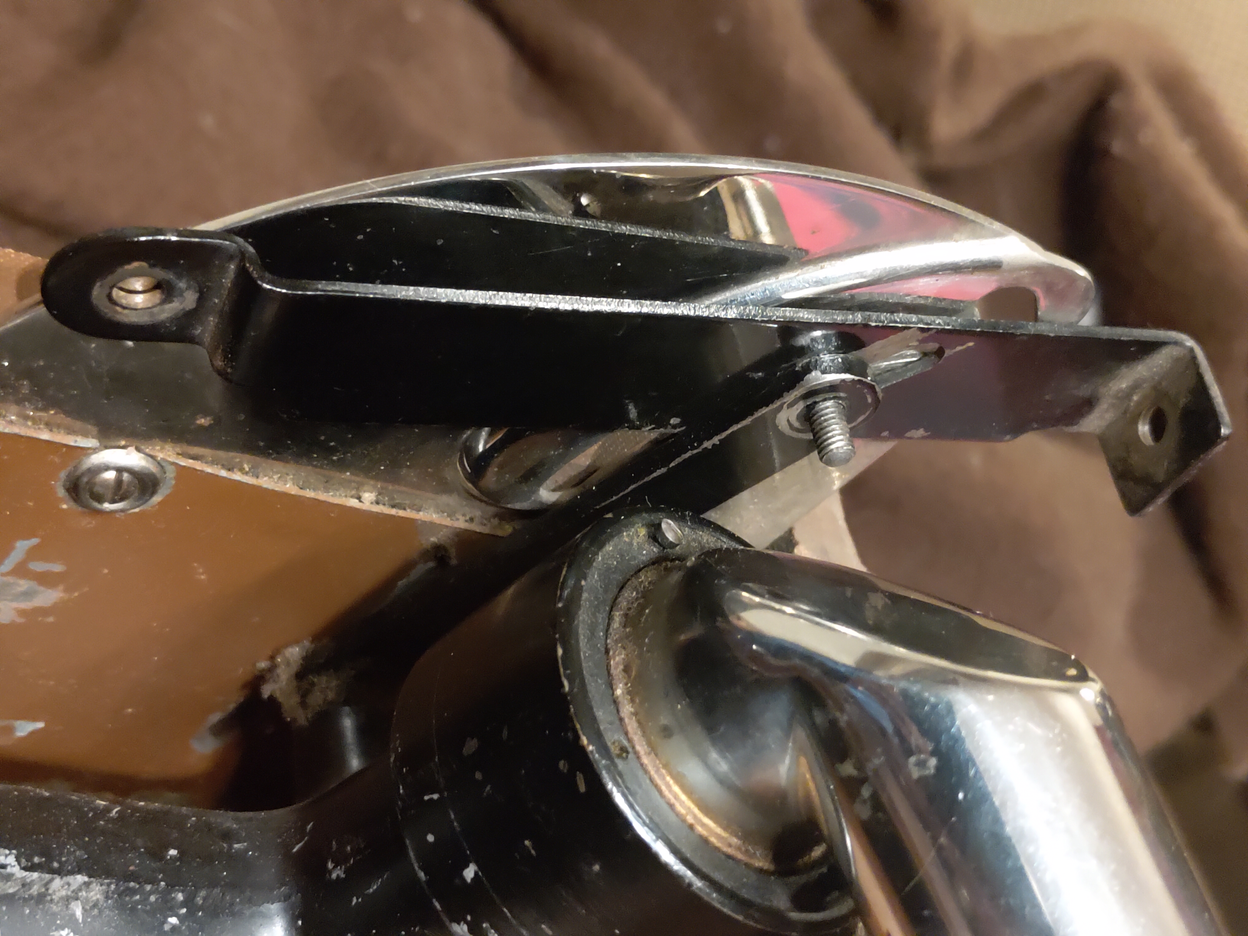

VanEpsFan, you also have a 202 with a polished motor board, similar to the one I posted photos in this thread a few weeks ago?
If so, we are at least two who have the 202 with this motor board.
Update: I have another photo of a Columbia 202 to my previous post in this thread. I thought it could be a good thing to show the 3 different Columbia 202 versions ( are there more versions?) on close up photos. I know quite a few forum members already have this third version with rexin clothed motor board, and winding key at the side of the gramophone. I bought this black 102 yesterday, and will collect it tomorrow. Unfortunately it does not have the record album attached, but the owner is still looking it, so there is still a chance it may appear. I bought the machine to complete the 102 versions in my collection, and also because the copy is in very good shape.

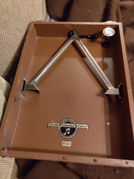

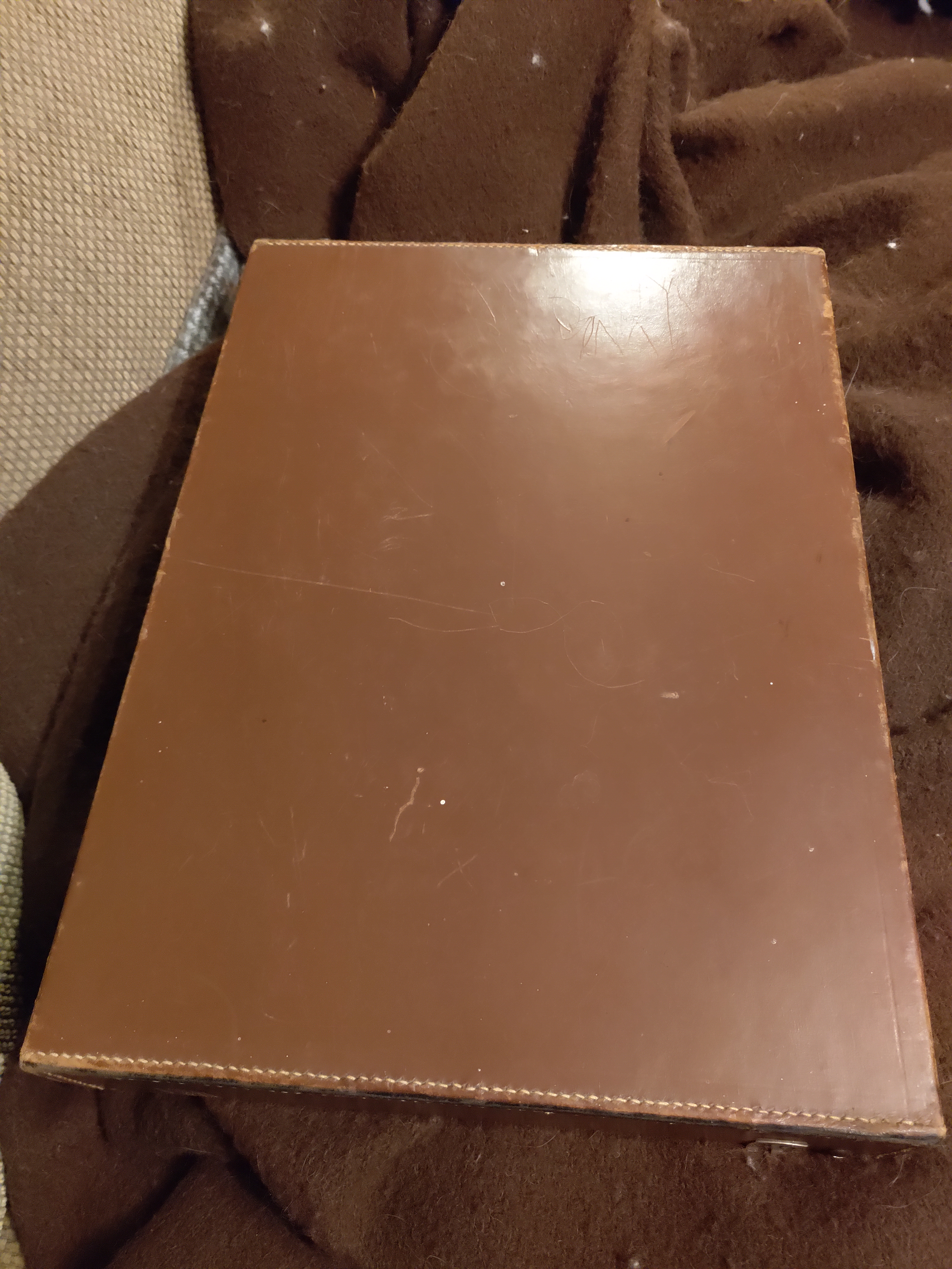

I re open this old thread, since I feel this portable belong and deserve its place here. I also upload some photos, so we can have a closer look at this 1929 Columbia, in brown leather, and with nickel fittings. I understand this portable also was sold with gold plated fittings, but on this portable we have the traditional nickel plated fittings, and I guess this model because of it was named Columbia 111a N.

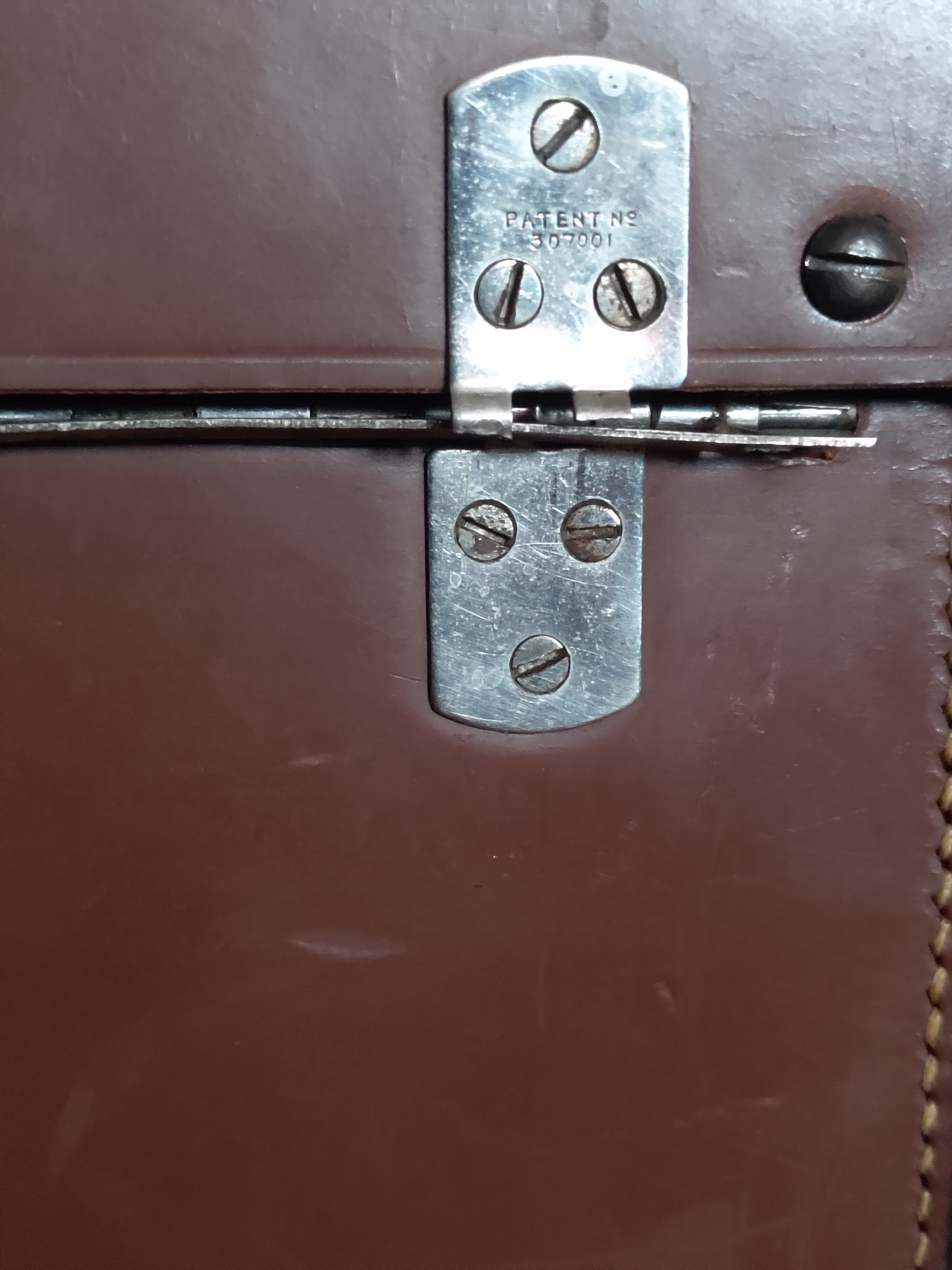

We can see it has some small issues, but not too bad really. The lid hinge/stay is not working, a metal part has fallen off, and was not found inside the portable. Because of it, there also has been used force to close the lid, which has caused one hinge to break at the back of the portable, and also the long hinge that holds the lid to the body of the machine, has been bent. This last problem is easily fixed, really, but one of the main hinges on the back of the portable needs to be replaced.
1. I have not yet compared the lid stay with the lid stay on a Columbia 9000, if they are exact the same. Unfortunately my two Columbia 9000s are in my storage locker. I also yet can't tell if the broken back hinge are similar to hinges found on other Columbia portables from the same period, I will need to check on that. Maybe I have a replacement hinge on a scruffy Columbia, or not. I would at best avoid to sacrifice a 9000 for restoring this 111a, but if there are no other options....

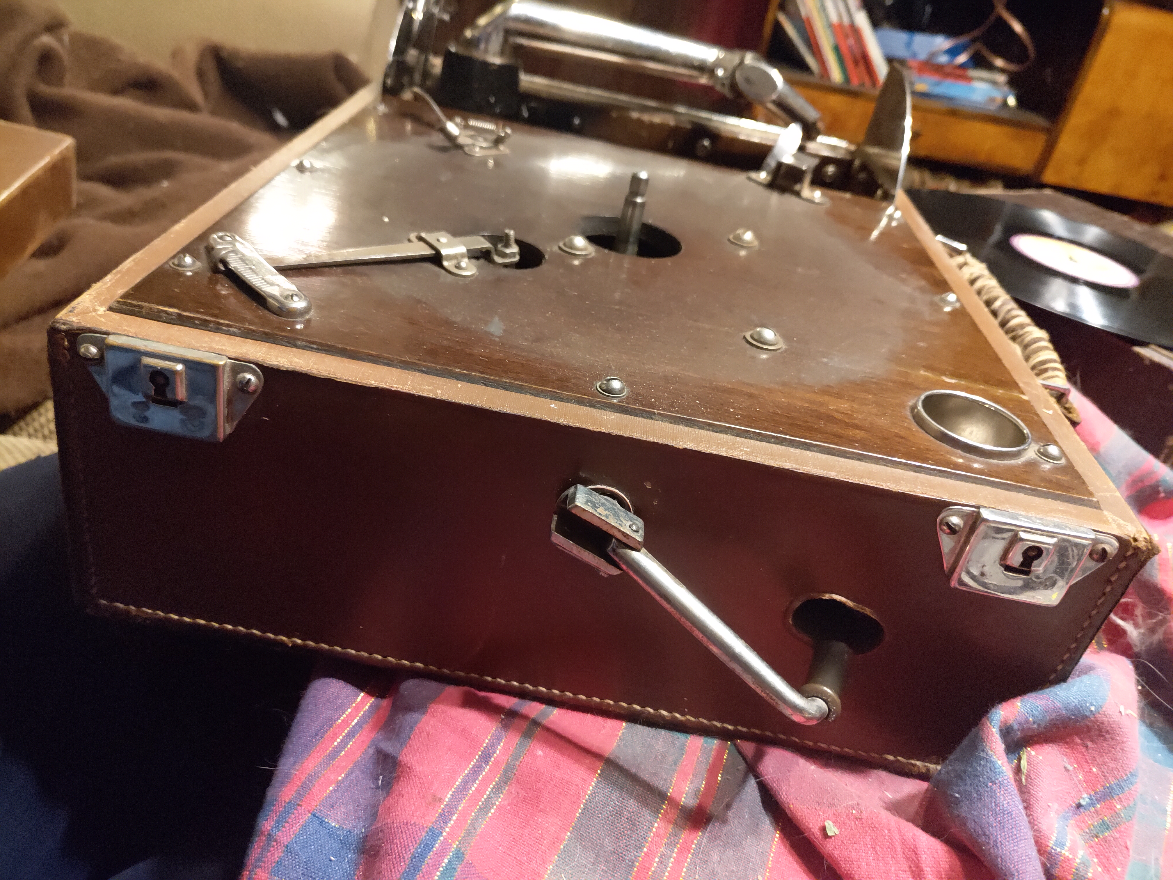

2. Can someone tell how I remove the winding handle on this front wind Columbia ( Garrard motor)? I don't want to experiment with this portable, ending up breaking something. I have never serviced a front wind Columbia before, and want the motor/board removed safely..
I will upload some more photos of the motor, when I have been able to remove the motor board...

The winding handle is removed by turning it anti-clockwise. It may need a bit of a "thump" to shift it as it's probably never been removed since it left the factory!

Nice machine and well found. The 111a(NP) is a de luxe version of the 112a, so the lid stay and hinge fittings are identical.
The leather case covering is thicker and more robust than the paper thin stuff used on red leather HMV portables.
I notice that the winding handle escutcheon appears to be missing. Again identical to the 112a etc.
