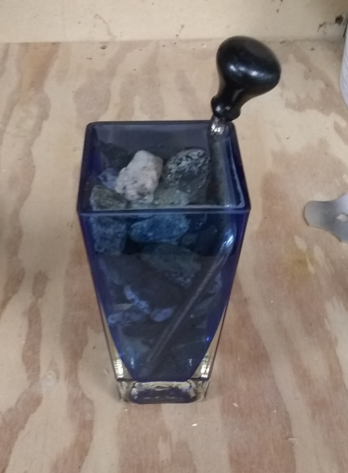

The Donor Crank:
I was running out of rust remover, so I used the Aesop's Fables rust remover conservation method. My wife does not know that I used one of her favourite small flower vases. :D
Screenshot from 2024-03-02 15-34-34.png (344.17 KiB) Viewed 3901 times
The crank after the rust remover bath, a bit of light steel wool polishing, a light application of palm wax, a hard polishing with aluminium foil, a second application of palm wax, and some buffing with a soft cloth.

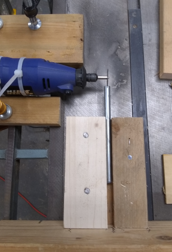

I would like to do a good job with the crank modification, better than with my lag bolt crank which is crude but functional.
But ... after attempting to do crank adaptation prototyping with steel rod, I have finally given up on my drill press.
It is a very old Ryobi DP101. It does not have its chuck on a mandrel that can be removed with a wedge through a slot in the side of the shaft. The mandrel stays in the machine. The chuck is hammered on to the mandrel with a mallet. This was never a very satisfactory set up. I was never able to get the rotation of the chuck really well centred, and over the years, it has gotten slightly worse. For most things I use it for it is accurate enough. But it is not accurate enough for finer metal work. I cannot centre drill metal rod.
Don't buy cheap tools, if you can afford better and need better.
My only consolation here is that I couldn't afford better at the time, and I have never really needed better before.
So I have mounted one of my knock-off dremel tools on my table saw and squared the blade with the table saw top and its mitre. I need to build a better sled for the rod, one accurately centred, and I need to mount blocks on the mitre board that limit the travel of sled to the extent of the ⅛" cut. I have done two proof of concept cuts, slowly and patiently, sort of freehand for centring, and they are not bad.

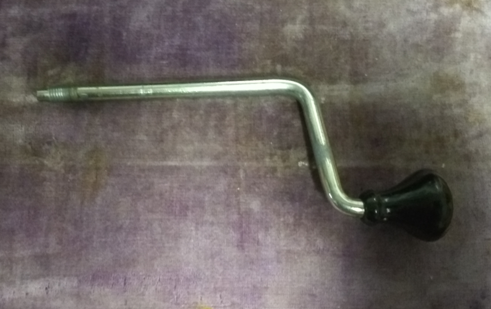

It has a Frankencrank; it is officially now a Frankenphone. ;)
With my dremel-type tool table saw, the crank turned out much better than the lag bolt crank which I did completely freehand with a hacksaw, a the rotary tool, and a bench grinder. It also went much faster.
The cut is more accurately centred, but the little dremel-type tool was not the best for the work. The chuck, the mandrel, and the blades are too flexible. And the work was a bit too hard for the poor little beast. The cut kind of tapers in a bit, getting narrower. I have filed it out a bit more.
It does not meet my dreams of machine shop perfection, but it works.

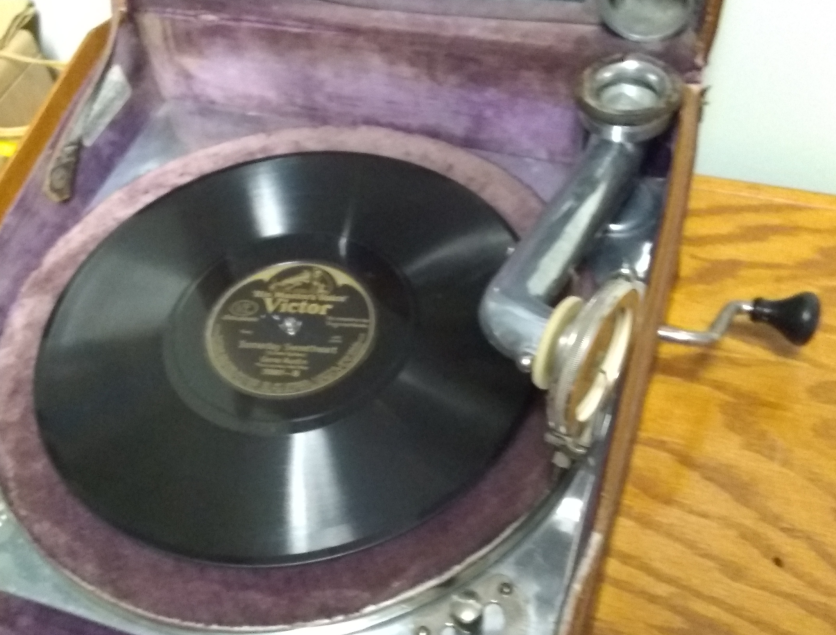

2024-03-06 07.17.07 en.wikipedia.org ed05b55b84f3.jpg (15.4 KiB) Viewed 3773 times

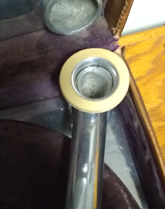

I went in person yesterday to the store front of a major Canadian industrial supplier, one allied with a US one.
I took the O-ring gasket from the tone arm, the seal between the tone arm and the horn, to see if they could help me find something to replace it. It was an absolutely pointless exercise. The person at the counter knew nothing other than how to put part numbers into his computer terminal. "Bring a part number, and I will see if we have something in stock or have to order it. Or you could just web order."
So today, after a couple of tries I cut a decent enough square-profile gasket out of ¼" natural gum sheet rubber. It looks big and bulky, but if it were rounded, it would be exactly the same size as the original. It fits securely. And being soft and compliant, tt seals the horn to the tone arm quite well. It sounds better than the dried up, cracked, shrunken original.
It will serve until I can find something that better approximates the appearance and function of the original (when it was new).
