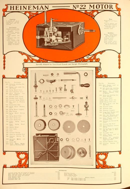

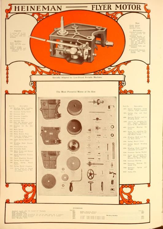

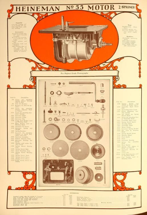

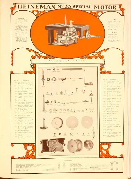

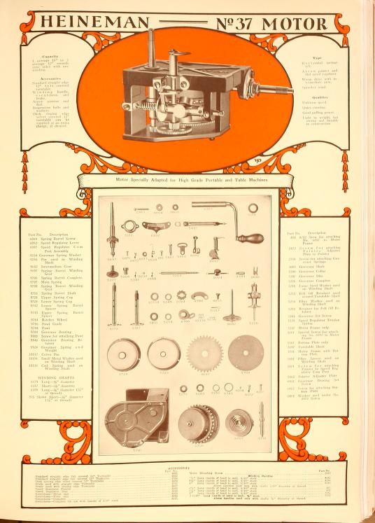

A good many folks think ill of Heineman motors. I suspect that this is because they only run in to the cheaper
models, which were used in so many bottom-of-the-line machines.
Heinemann came to the 'States in 1914, working as an agent for a Swiss firm (Palliard as I recall) as well as offering products of the German Exclsior-Werke. He believed, correctly as it turned out, that the American talking machine market was about to greatly expand with the expiration of the protection associated several of the industry's basic patents. When coming of the War in Europe interfered with his supply kines, he contracted for manufacture with the Garford company in ELyria.

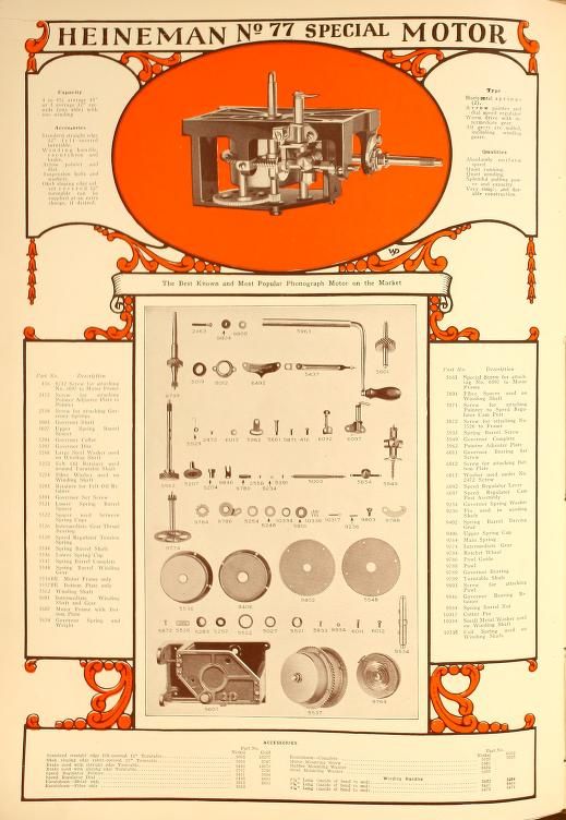

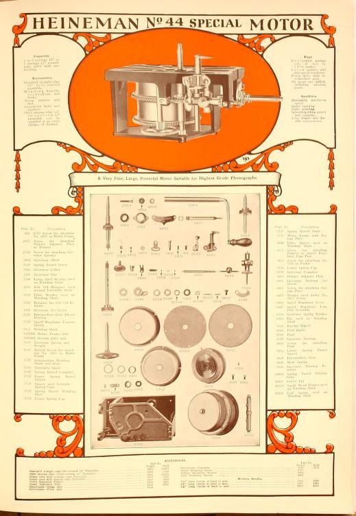

This sdvertising supplement to the 11/15/24 issue of Talking Machine World makes an excellent guide to the basic motor products of the Heinemann organization:

The better motors, such as the "66" are very fine indeed. The cheaper units offered excellent value for their cost.

Thanks for posting! This is the first time I've seen all of Heineman's offerings.
I think the reason so many people think ill of them goes back to the early days of collecting. When I first became interested in antique phonographs about 20 or so years ago, it seemed like the attitude was if it wasn't a Victor or Edison, it was junk. After looking at many machines on my own over the years, I know this is not the case. I also remember when most internal horn machines weren't even given a second look by many collectors.
In fact, I find many of the independent manufacturers' offerings during the WWI era boom very interesting. For example, the Ramos-Eubank phono I posted about a couple of weeks ago. The small company was located in Richmond, Va, and used Heineman motors in their phonos. They were apparently only in business for a few months in 1919 and could not have produced many phonos. To me, machines like this are a lot more interesting than just "another" VV-XI, which saw a production run of over 800,000.
The only gripe I have about two-spring Heineman motors is they tend to run a little noisy, even when they've been cleaned and lubed, but it's not to the point that it interferes with the sound of a record. I've never owned a machine with a 66, but it looks like a decent motor.

The #66 and #55 motors look very robust and strong, on the lines of Victor, B-wick, and Edison.
The smaller ( and cheaper ) "pillar & plate" motors, such as I have in my Pathéphone VII are not so inspiring. ( appears to be the "Flyer" motor at the bottom, judging from the brochure illustrations )
Perhaps I wouldn't be so down on them if I hadn't invested many hours and more than a few bucks in the Heinemann pillar & plate job in my Pathéphone, and the SOB still wont' play steady or pull it's way through a single 10" record (yes, I'm using new needles, and appropriate 1920's records.)
Thanks for sharing the brochure, Uncle Vanya - neat graphics, and interesting product line.

If it were me, I would have swapped it out if I serviced it and it was still giving these kinds of problems. If it's not holding a steady speed, it's likely that the gears are shot. This can happen to any motor if the previous owners kept playing it without maintenance. Kind of like driving a car 50,000 miles without changing the oil. I've noticed that phonos I've found in impoverished areas tend to exhibit flaws like this more frequently either because the owners didn't have the money or the knowledge to maintain the motor. Worn out parts and improper "make-it-work" repairs have been especially common on phonos and radios I have found in the Appalachian states.
They wouldn't have been able to stay in business for as long as they did if they were supplying manufacturers with motors that weren't powerful enough to play through one 10" record.
