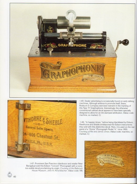

Looks like a Hawthorne & Sheble No.4 crane to me, except the vertical rod might not clear the wooden motor frame.

Whatever supports they are had rounded ends and not squared off ends..

As the years passed, H&S evidently refined the appearance of the No.4 braces... :) I don't recall ever seeing the squared ones shown in the illustration, but in any event they wouldn't have allowed the vertical rod to clear the motor frame on the Edison "New Style" cabinets of 1901. I suspect these modified braces were introduced in 1901 as well.

It looks like you nailed it George. I guess his phonograph had two types of different Horn supports at one time...I wonder which one came first....Probably the Cygnet... If I was restoring this one..I guess either fill the holes for the H&S Brackets, or just leave them alone... I would probably put the Cygnet horn support back.
What would you do?

the H&S support was the original setup for sure as the machine predates the cygnet horn introduction plus it would be odd to swith the cygnet horn for something else.

Personally, I would leave the H & S holes alone. It shows a good, honest example of a machine being upgraded from the earlier crane, to the later Cygnet crane.
