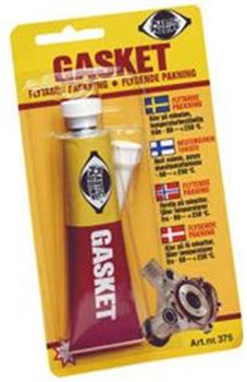

As long as it seals air-tight, I'll think you'll be very pleased with the results.
I used liquid silicone gasket for 2 different Columbia Viva-Tonal #16 reproducers, since there is no modern replacement available, you have to make your own.
And I was very pleased. Not only did it seal very tight, it also is very soft, but still stable enough to hold the reproducer firmly.
Liquid gasket is available at auto-parts stores, bicycle shops & of course online, even at eBay.
It comes both in clear & white & I've also seen in red & black color.
I am in no way an expert nor an engineer, but to my layman brain, it makes good sense to have a flange that is a soft as possible, without compromising stability ofcourse.
It should allow the reproducer to track freely & also a softer material, but still kind of sticky, like soft silicone, should make for an excellent air-tight seal.
If one would have the time & some spare brass inserts for reproducers, it would be great fun to make a mold, perhaps out of silicone or latex & try out some different types of silicone & molding resins.
IIRC there was a discussion not that long a go at some of all the phonograph related board around, were someone wrote about a prototype flange they had gotten from someone who was trying to make flanges (I think it was for exhibitions, not sure.)
The maker gave it away, thinking it was a failure, since it was waaaaay to soft, compared to an original.
But, they writer stated that it was the best flange he had ever tried, just because it was so soft.

Just use a silicone stripper, no worries. Available everywhere, cost a few $ for a can.

You can (barely) see the red colored back flange gasket in this image:
