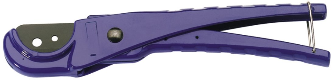

You need a hose cutting tool like the one below, Steve
http://ecx.images-amazon.com/images/I/4 ... L1100_.jpg
I have one similar to the above, but I bought it locally in Luxembourg. The tool will make a smooth cut, but the challenge is to have it perpendicular to the tube, I lost some length of tube until I got right angle cuts on both sides.

Thank you, Carlos!
I might have known there was a dedicated tool for just this job. I have now ordered one from Amazon. No doubt I'll use up and waste a lot of tubing with trial and error cuts as you have done.
