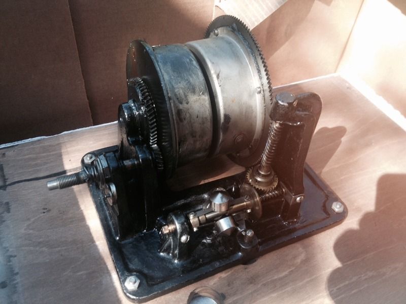

I just bought a rare late Columbia Viva-Tonal 720 console. Here is a pic of the motor and motor board which doesn't look like the motor on my Columbia Viva-Tonal 800. Is this a Garrard motor?

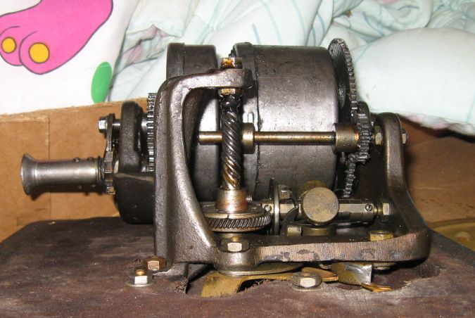

After looking at my Columbia 800 motor again, I can see there are more similarities to this motor than I thought. Of course, the 800 motor has three springs rather than the two shown above, and the governor is to the left rather than to the right. It appears that the motor shown above uses a female crank whereas the 800 uses a male end crank. The most important difference is that this motor board has simpler controls above the motor board than the earlier 800. I think that perhaps this is not a Garrard motor, which came out I believe on the 1928 machines such as the 721 and 820. This is what the 800 and 810 model Columbia Viva Tonal motors look like:

Garrard motors usually had their spring casings parallel to the motor board, as here :

That is a Heinemann speed control. The motor appears to be a Heinemann "55", which would have been made it the Garford Works at Elyria, OH.
Columbia bought in motors at the end of their machine production.

Imported Garrard motors have been found, as have Heinemann, though a couple of experts have told me definitively that Heinemann motors were never used by Columbia, the evidence of my lying eyes notwithstanding.

I think you nailed it U.V.! It's a Heinemann 55 motor complete with a female crank. I never would have suspected that Heinemann and Columbia were connected. I will furnish some pics of the 720 when I get possession of it. It is currently in Florida and is being packed to go Greyhound to CA. We found that after taking the motor board out, the cabinet was still over 100 lbs. So we had to remove the doors and lid, as well as the tonearm and reproducer, and pack them with the motor board. I will get the 720 in about ten to twelve days.
