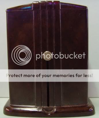

I found a Capitol bakelite needle dispenser, and I think there's something missing inside that keeps the needles from falling out through the little hole in the metal baseplate! Also there's something that should feed the needles to the dispenser plate. Can anyone help me out with more information? Thanks.

Thanks, John, for the picture posting advice. Could this same info be permanently posted somewhere?
I hope the pictures help.

That needle despenser is ULTRA-COOL!
I wish I could help out with the info you need, but I've never seen anything like it!
What are the approx demensions of the dispenser, and where does the needle actually pop out?
I guess it must be through the little silver circle in the third picture.

I'm trying to work out how this thing works.
Obviously you push the button on the front downward, which pulls the spring loaded part I've marked "A" down the slot in the bakelite, but what does the red wall do that I've marked "B" do, or is it stationary & simply there to stop needles falling into the mechanism?
After pushing the front button down, the spring pushes the button back up, and that I'd imagine is when the needle would be pushed out the hole.
The only way I can see it working would be if the needles fell into a slot in a tube when you pushed the button down, and some sort of piston pushed the needles up the tube as the button returned to it's original position.??

Thanks, Shane, for your comments.
I've posted the following picture so you can get a clearer idea how this works: (at least it's how I think it should work)Image
You press down on the little knob in front, and the narrow top plate goes down, somehow gets a single steel needle, and comes back up with the needle sitting on top. This reminds me of the old cigarette boxes that did much the same thing.
The little hole on top is where you put spent needles. The little orange divider you see in the view from below just keeps them separated from the main compartment. There must be some insert missing, as there's no way the needles get fed to the dispensing plate. I thought at first maybe the plate was magnetized, but no it isn't.
Perhaps special boxes of needles were sold, and were just slid into the bottom?

Your dispenser looks to be complete. I think the problem is that you are putting the new needles in the wrong end. The top comes off, and you will see a funnel-shaped bin that holds the new needles. The needles will never be in the lower portion of the dispenser over the hole.

Silvertone wrote:Your dispenser looks to be complete. I think the problem is that you are putting the new needles in the wrong end. The top comes off, and you will see a funnel-shaped bin that holds the new needles. The needles will never be in the lower portion of the dispenser over the hole.
Thanks for the response. The funnel-shaped bin is what I guess is missing. There's nothing inside but the view of the mechanism, the metal plate, and air! Does anyone have a working example to post, perhaps together and in pieces? Thanks again.

barnettrp21122 wrote:The funnel-shaped bin is what I guess is missing. There's nothing inside but the view of the mechanism, the metal plate, and air! Does anyone have a working example to post, perhaps together and in pieces? Thanks again.
Bob
I can see it in your picture. The bin is not a separate piece - it is moulded to the case and does not come out. Just remove the top and pour some needles in. It should work.
Well, whaddaya know! I didn't know the top comes off! Thanks for persisting with your original advice! Now I can enjoy this. It IS cool!
THANK YOU! :D
