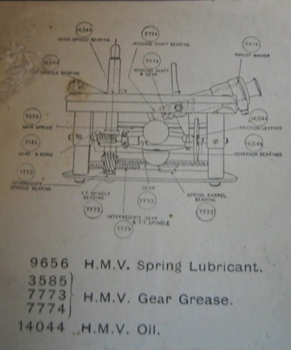

While rummaging through a few things, I came across this, which I am almost certain is the ‘service’ diagram from the manual:
Thanks to beaumonde for the image above, I snagged it from him via Google’s cache.

That isn't actually the same motor shown in that diagram as this 101 has got in it.
The motor in this 101 is a 400 series.

that helps.Steve wrote:That isn't actually the same motor shown in that diagram as this 101 has got in it.
