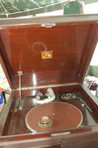

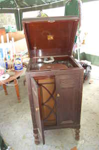

Antique Voice of the Master — $250 (Hayward / Castro Valley)
Reply to: [email protected]
Date: 2009-06-25, 4:30PM PDT
Su Voce de Amor Victrola cabinet I brought back from Spain 45 years ago......(510) 760-5041 [email protected]

Ortho_Fan wrote:http://sfbay.craigslist.org/eby/msg/1239855749.html
Wish I drove, I'd check it out...
Based on the shape of the legs, I'm inclined to say that it is indeed a 163. The ID plate is located beneath the removable used needle container.
If it is a 163, it's a bargain. But make sure it is all original. Make the seller remove the grille if you have to, so you can see if the original re-entrant horn is still there.
Strange, that even European machines seem to be cheaper in America than in Europe. I visited a local dealer yesterday, he had two 163's, both in very good condition (but not serviced, so the motor and the soundbox probably needed some work) and he wanted 1500 euro's for each of them. (which is over $ 2000 at the current rate of exchange).

Looks like a mahogany 163 to me. A nice machine..albeit the smallest of the re-enterant machines. I agree with Bart that anyone buying the machine should really check that the correct horn is in there cabinet. Hope someone snaps this one up for this price.

To check the horn in the HMV Re-entrants, the easiest way is to remove 2 screws that hold the back panel to the cabinet & lift the panel out. You should also be able to feel the horn section that runs across the centre of the grille through the grille cloth.
