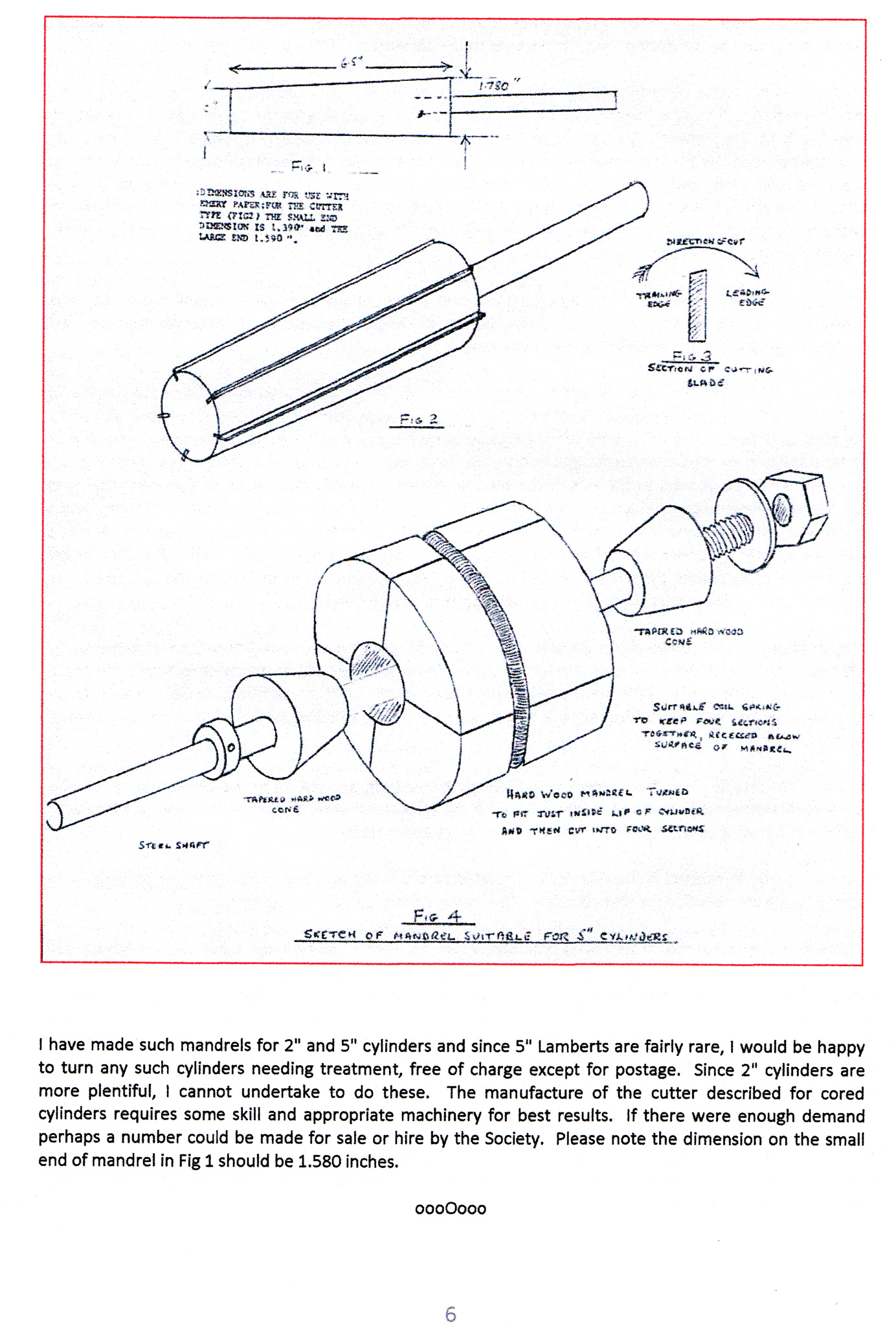

What is the taper on the Edison Cylinders ? I read somewhere is was 1:32 ( 0.03125 ) and this would make sense as ships propellers of the era had that taper.
However the CLPGs suggest in a drawing 0.03077 and I have measured slightly higher on average.
So anyone have the true figure or and drawings from the time ?

All my measurements are a tad less that 1:32 too.
Of course 1:32 is a ratio, so can be applied to anything, in any units, hence the old boat propeller shaft.
Here is a link to the CLPGS article that shows the taper http://www.soundhifi.com/FOURUMIMAGES/taper.jpg you can zoom into to it after it fills your screen.
How would we get access to the Edison Archives ?
Thanks
Dave

Dave: According to the sketch shown from the link you
provided, here are the numbers from it:
Large Dia. 1.78
Small Dia. 1.58
Length 6.5
That is a 0.2 inch difference spread out over 6.5
inches, which comes to .030769231, which
happens to be EXACTLY a ratio of 1:32.5, dead on,
accurate to the ninth decimal place!
Another way to see that is by multiplying .2 and 6.5
both by 5.0
When that is done: .2 x 5 comes out to 1.0, and 6.5 x 5
comes out to 32.5
That shows that it's a ratio of 1 in 32.5
At least for that sketch that's what the taper is.
We still need to have access to the Edison original
detail drawings though, in order to be absolutely sure.
Large Dia. 1.78
Small Dia. 1.58
Length 6.5
both by 5.0
comes out to 32.5
