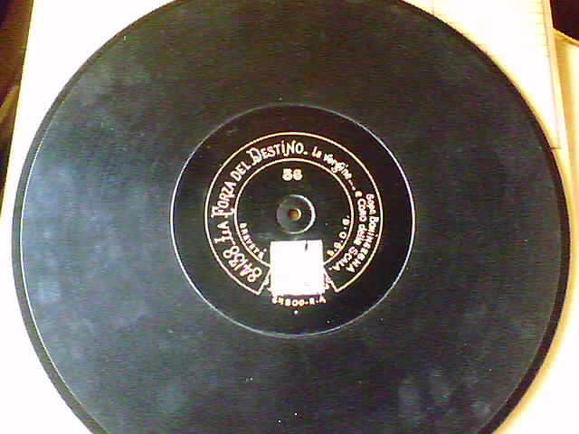

Not to mention the early etched-label discs....
This is 14", inside-start and plays at 90 rpm....'Ave Maria' plays for 3.05, 'La vergine....' for 2.53.
