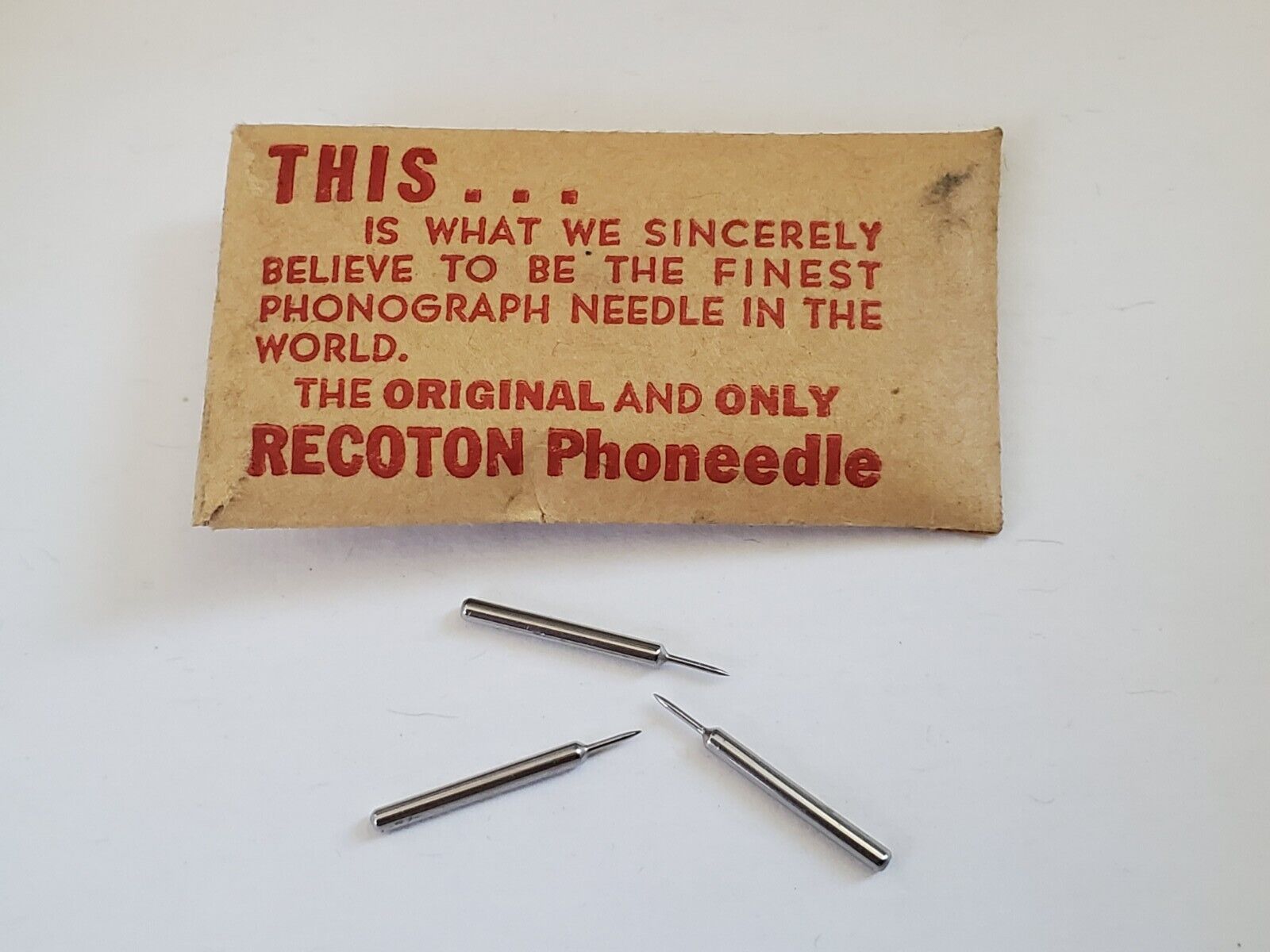

I recently purchased a 1917 Victor Victrola XI that came with 3 Types of Needles.
1. Steel Needle (Single record side use).
2. Tungs-tone Stylus (60 record side use).
3. Recoton Phoneedle (12 record side use).
The ones that seem to work the best are Recoton Phoneedles.
The Recoton Phoneedles were made about 1936 by Laubscher in Switzerland.
attachment=0]Recoton Phoneedles (1930).jpg[/attachment]
My Two Questions, which I cannot find the answers to are:
1. What Material are these Recoton Phoneedles made of ?
2. Should I use these Recoton Phoneedles on my 1917 Victor Victrola XI Records ?
Any help would be greatly appreciated.
