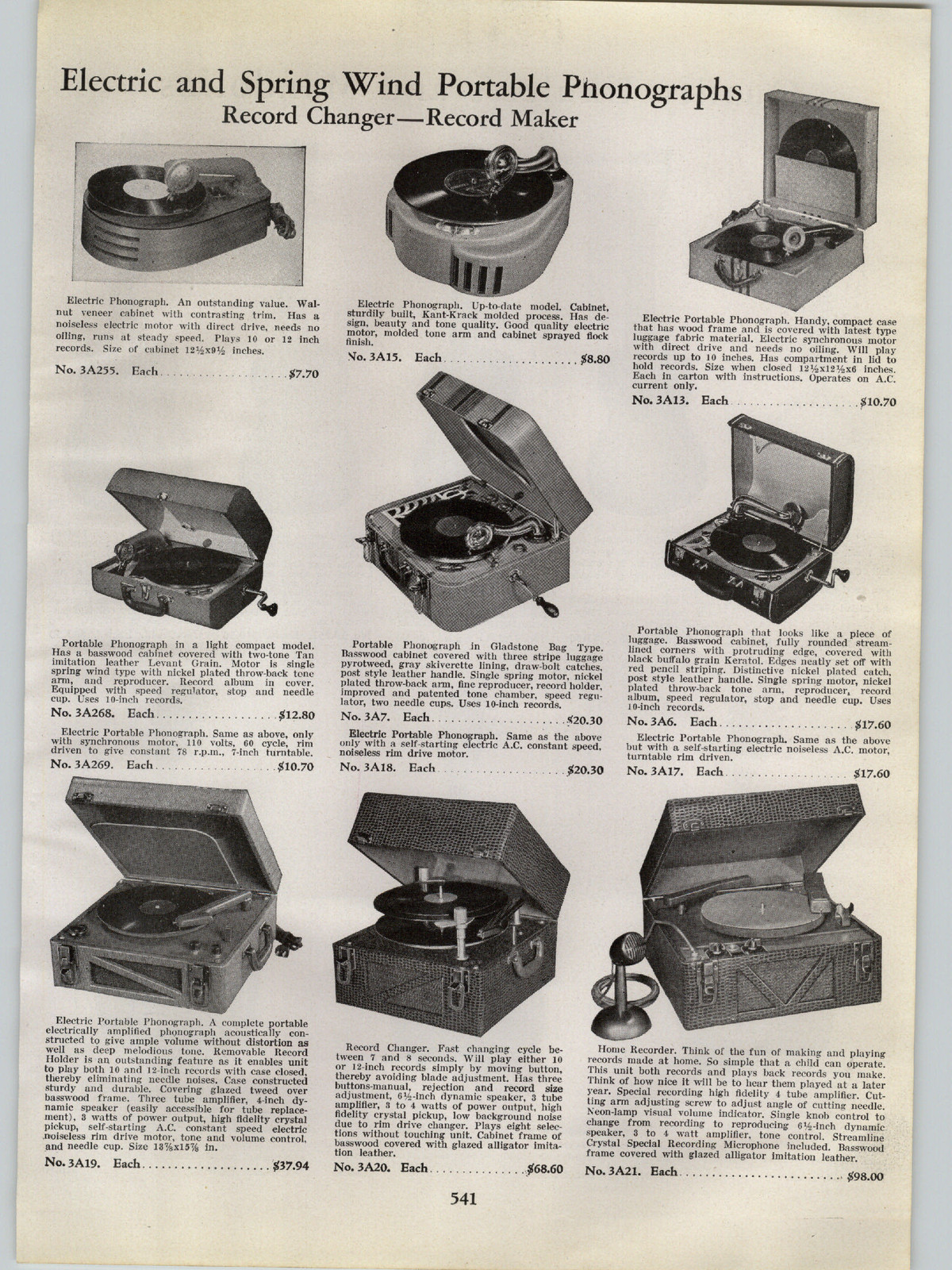

I've seen several like this one over the years.
As noted, the tonearm/reproducer that came with your phonograph is from an earlier era--late teens to mid-1920s. It was produced at the time that Victor, etc., still controlled the tapered tonearm patents. (SEE: https://www.antiquephono.org/brand-talk ... j-wakeman/ )
I had a chance to do a little "Googling," and spotted this one which matches the one you have, and shows the original tonearm and sound box. (Don't know about the crank.) : FROM: https://www.pinterest.com/vincenzomereu ... h-antique/
Here's a a similar--though not identical--model from a 1940 ad:
FROM: https://i.ebayimg.com/images/g/nqkAAOSw ... -l1600.jpg
